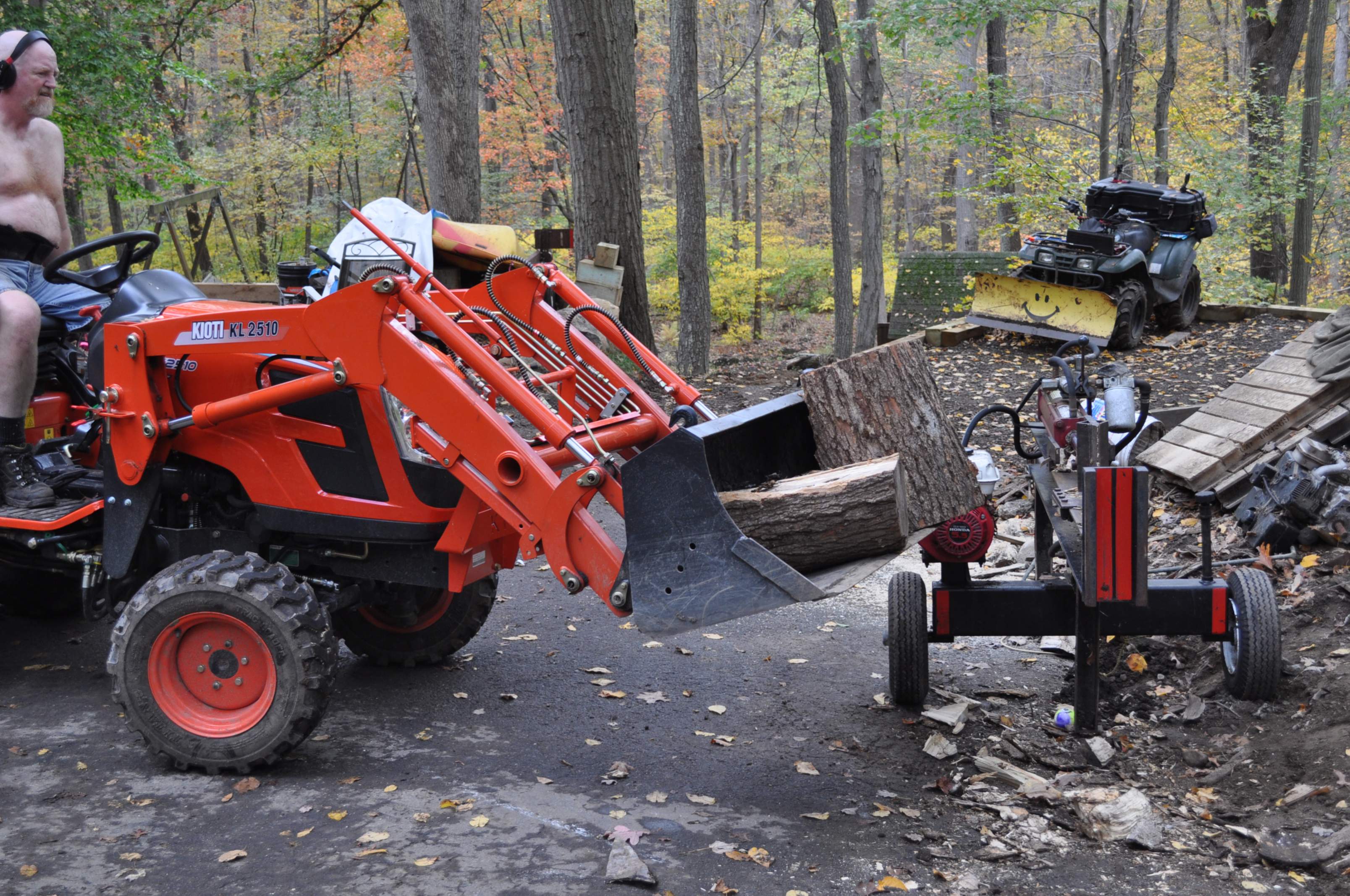

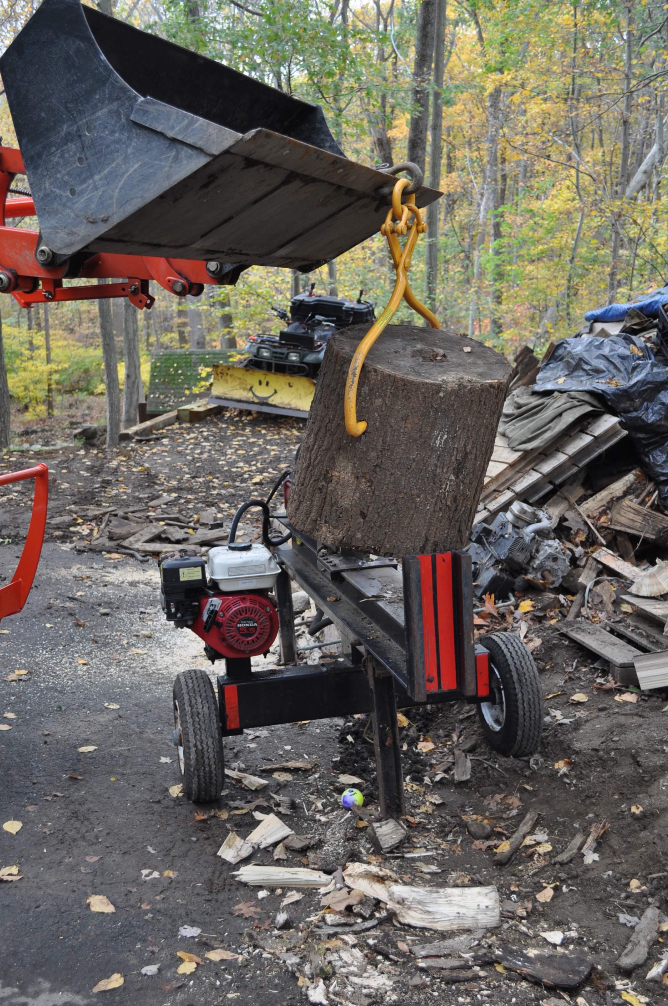

I doubt you Max25 has enough GPM for fast operation. My buddy has a Kubota L3010 and his 3pt log splitter is sloooowww. My Northern Tool slitter with a 6.5hp Honda GX160 is much faster. And with a stand alone splitter you can use the tractor to bring wood to the splitter and to working height.
View attachment 395478 View attachment 395479
or get a splitter that goes vertical and not have to lift the rounds. :)
