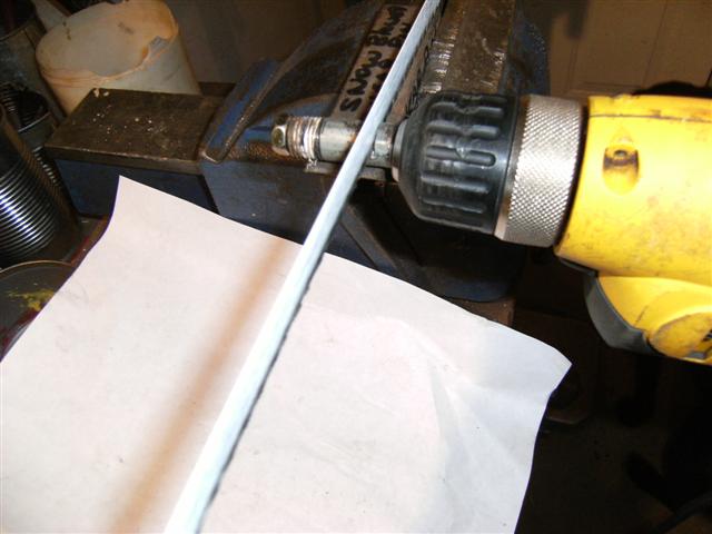

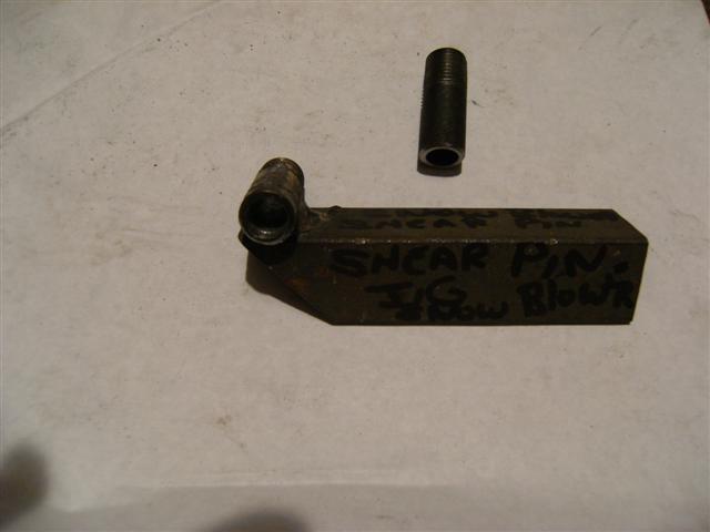

After buying a few shear pins for the snowblower and paying way to much I decided to make my own.I made a jig out of a piece of 1/4" pipe and a piece of angle iron.I welded the pipe to the angle iron placed the new shear pin/bolt beside the pipe to mark where to cut the slot.I then put the shear pin/bolt into the pipe and cut down into the pipe untill the hacksaw blade just made contact with the shear pin/bolt.I did that for both slots.I then used my drill to spin the bolt and just held the hacksaw in the pre cut slot's untill the slots where cut into the bolt.I made 10 of then in a few short minutes.Now I won't feel Like I'am being taken for a ride when I need to have a new shear pin/bolt. Larry

I use plain bolts for my shear pins.
Grade 5 as they shear nice and clean
The hardware store grade is simply mild steel and they burr B4 shearing and become a bear to drive out and as well they elongate the mateing pin holes.
I always use nylon lock nuts torqued nice and snug.
No problems going on 6-7 years now and probably go thru 24 a year on both the auger and impeller each.

Same on both blowers that I have 48" snapper and 48" ariens I'am using grade 5 with the notches cut into them.The cut in notches make them the same as a 1/4" bolt.I've sheared the grade 5 bolt 5/16" on the ariens without the notch[piece of firewood] but to be safe have decided to use the notched ones now.The bolts are cheap compared to having problems with the gear box etc:The grade 8 bolts would be just to tough.Basicially its like just using a 1/4" bolt with having that notch cut into them.Thats where there going to shear off.Larry
