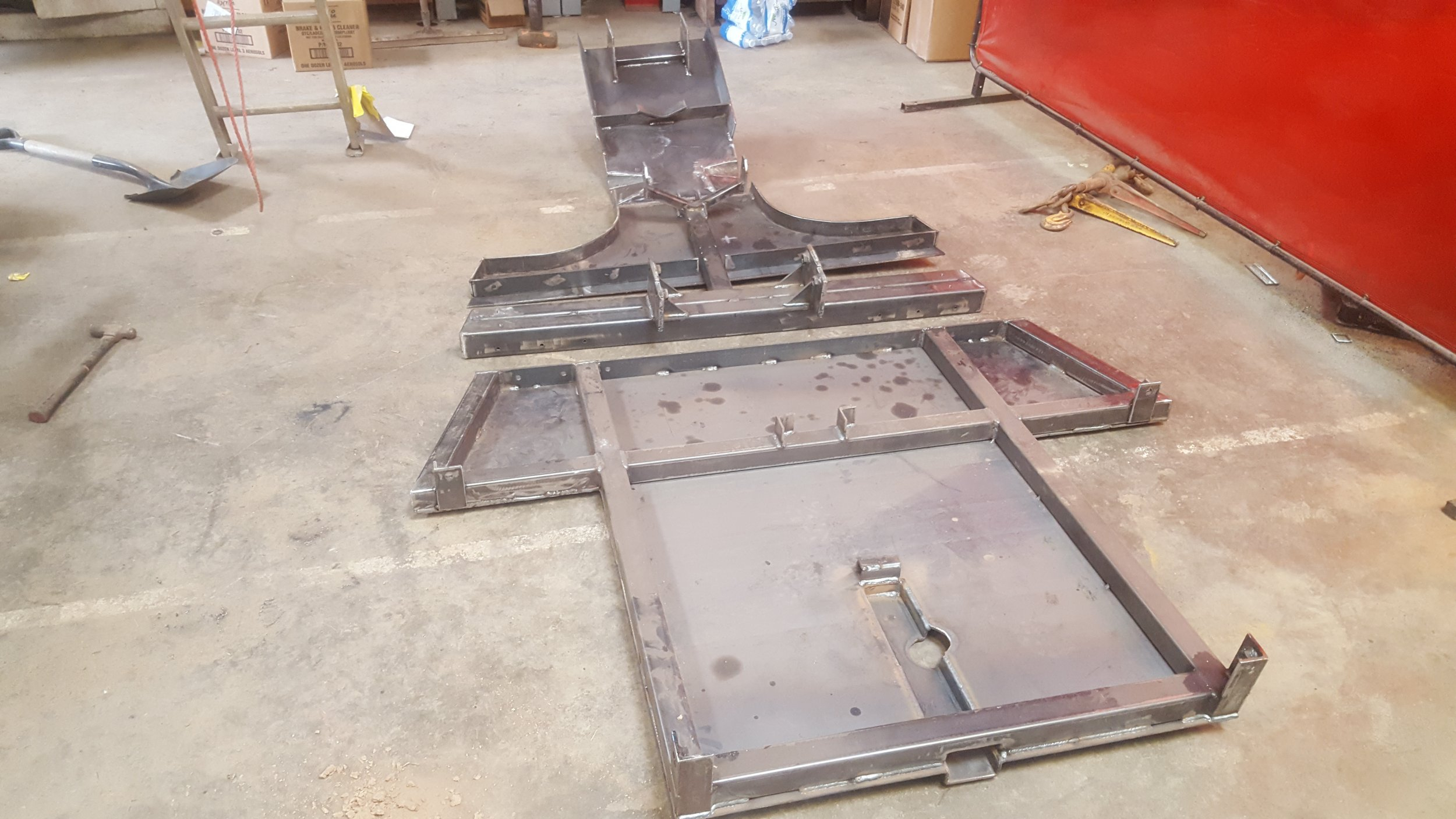

You could build a full skid plate to protect everything... this was for a JD 4066, built about 5 years ago... had a full cage over the cab too. Owner had too much money and a tendency to operate the tractor like it was a dozer... Marv Hemyer would have been proud of this skid plate.
That is awesome! I would definitely buy one as much of my land is scattered with >2’ boulders where you’d least expect them.
