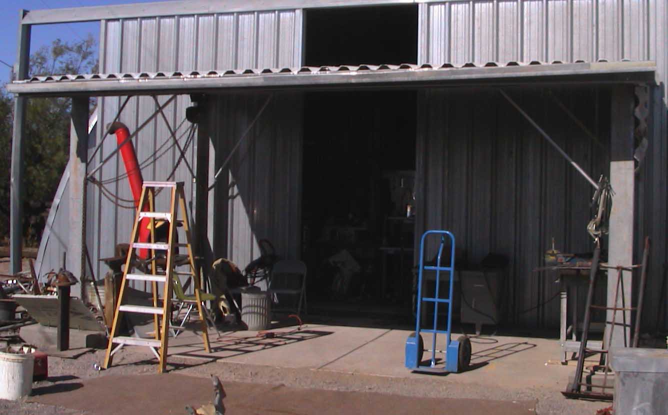

Build yourself a Forge first. Its pretty simple and can be real cheap. I built one in 1962 and it worked real good.
Old 55 gal drum, old can style vacuum, a rheostat to control the vacuum air flow and a little heavy metal to from a grate. Re bar will work for a grate, 3/8" or larger. If you have trouble finding a rheostat, build in an air vent. If you don't have coal, regular charcoal. will do just fine.
An old hot water tank with a dished bottom will be even better than the drum. Its a little thicker and you don't have to beat the dish into it.
