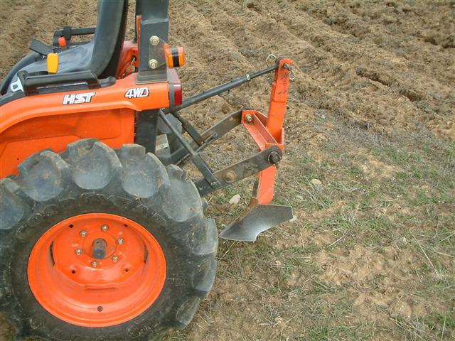

For those small stumps, I'd get a middle buster plow from Tractor Supply ($150 or so) for your 3pt hitch and just plow them out by the roots.
That's my 2005 Kubota B7510HST (21 hp engine, 17 hp pto, 4WD, hydrostatic tranny) with a middle buster.
