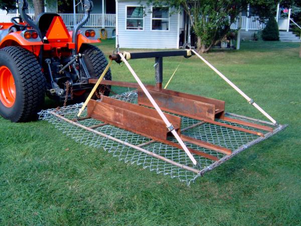

   / Making a chain link drag? #6
See the attached picture for the chain link drag I made up....
Don
Wow, that's quite a drag!
Thanks for the information, I should be able to fabricate one of these now. Some day I'll get some welding equipment and will be able to do my tractor mods right :)
