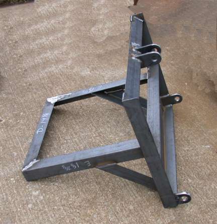

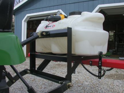

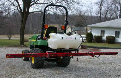

A friend bought an atv sprayer and now he has a JD 2305 and wanted to use the sprayer as a 3 point attachment. This is what I came up with.

This is what the frame looks like

Another view

Another picture

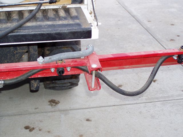

   / making a ATV sprayer into a 3 point mount #7
Scott,
Could you post a picture of one of the break away joints?

Jerry, the sprayer belongs to a friend of mine, I don't have any pictures of the hinges but he bought it at TSC, it seems to work good. the boom is 10' wide open with 7 sprayer heads, the complete unit was around $360 last year.
   / making a ATV sprayer into a 3 point mount #10
Here is a pic of the break away joint closed.
