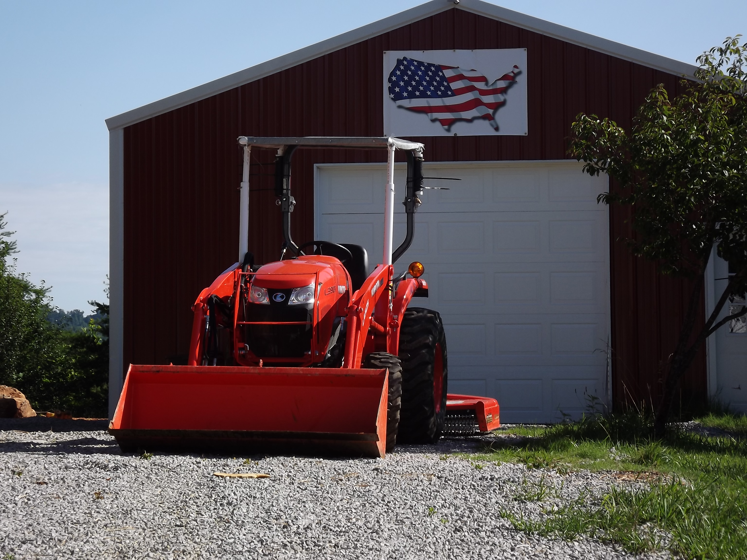

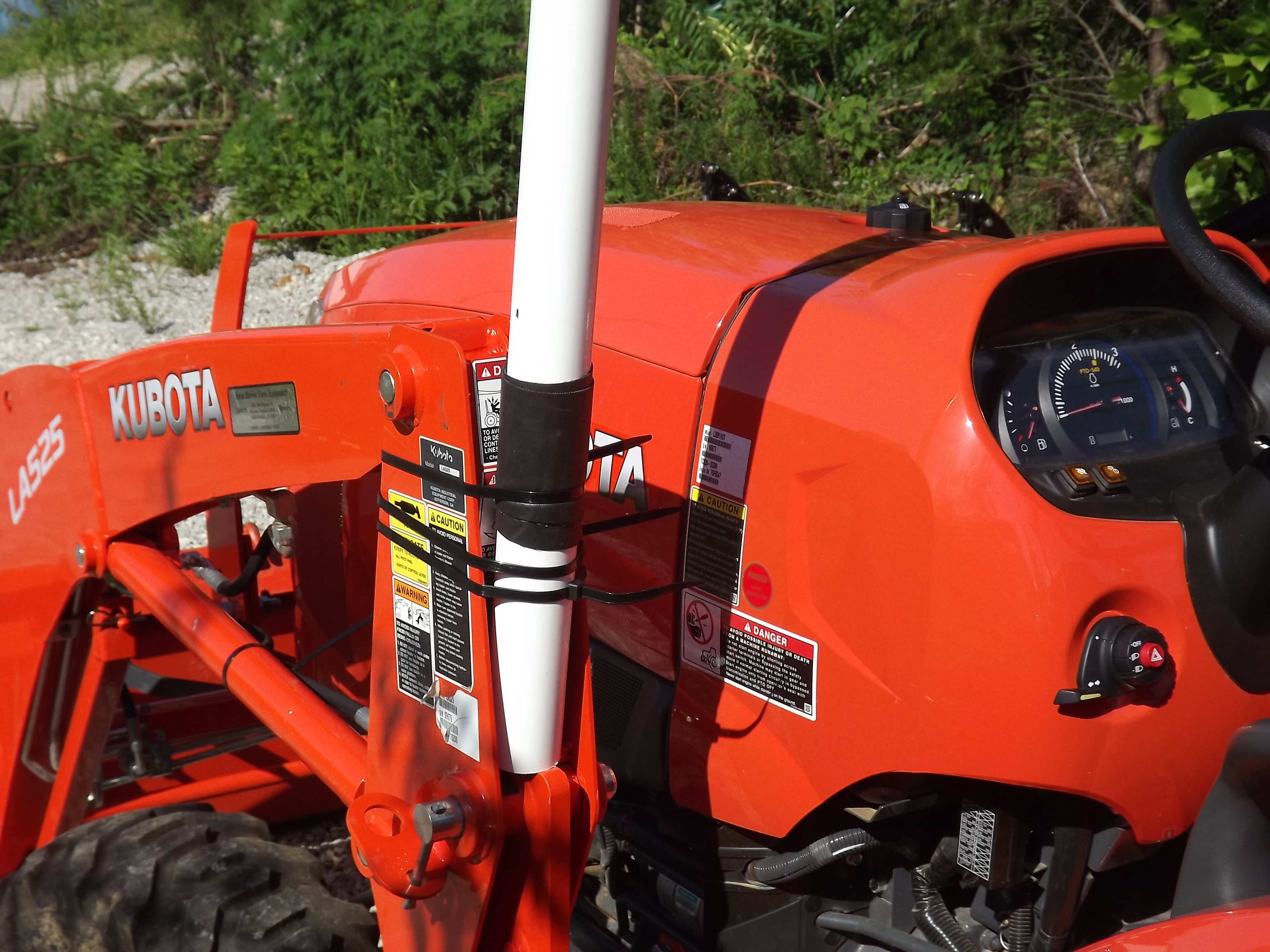

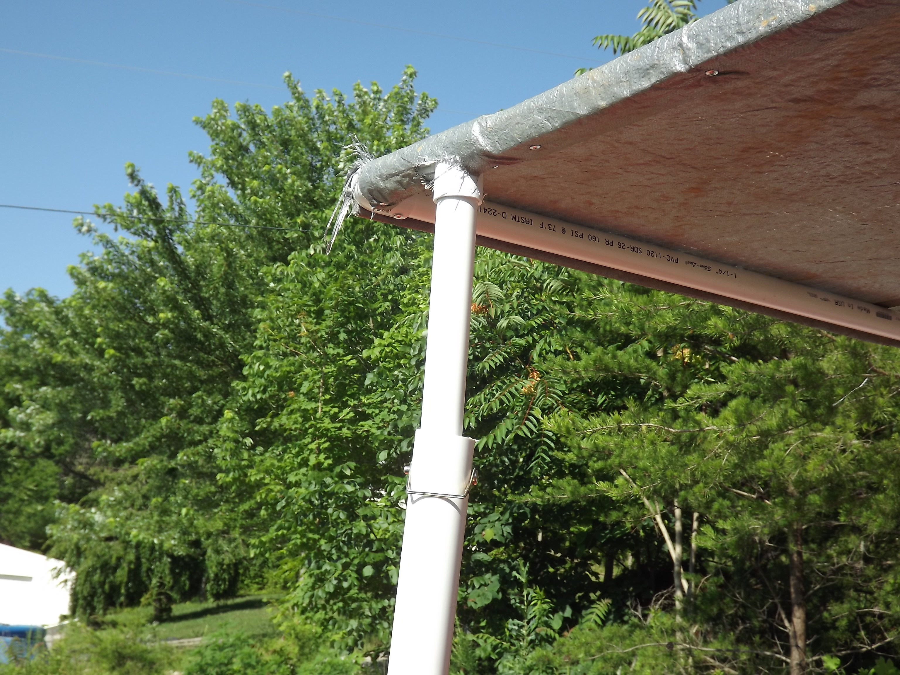

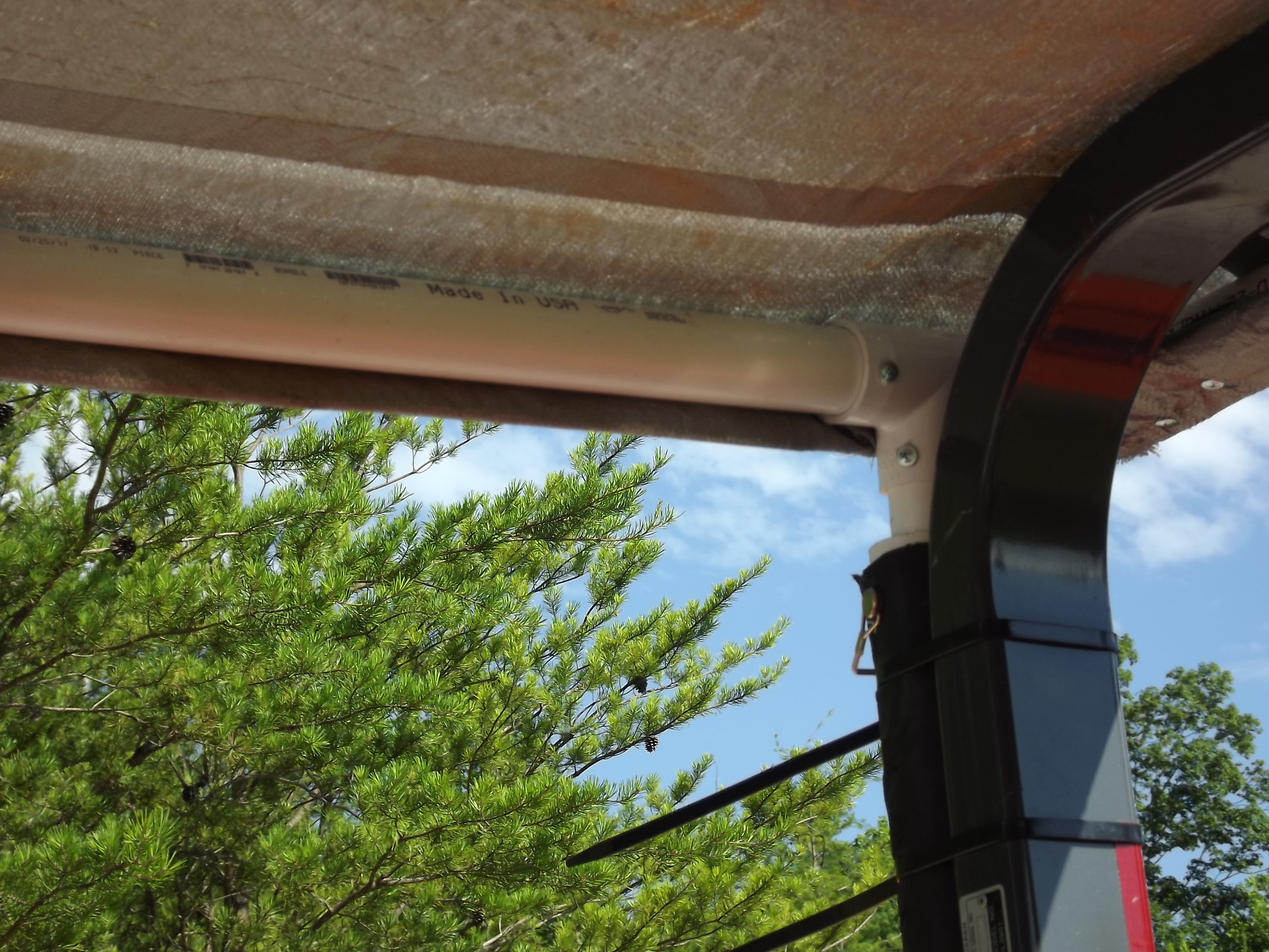

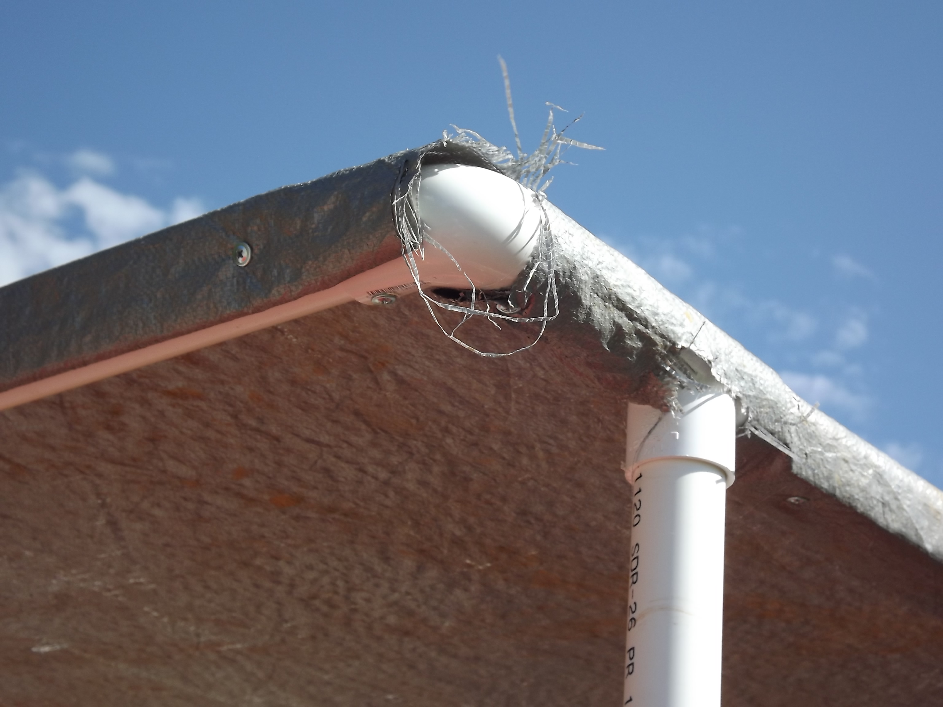

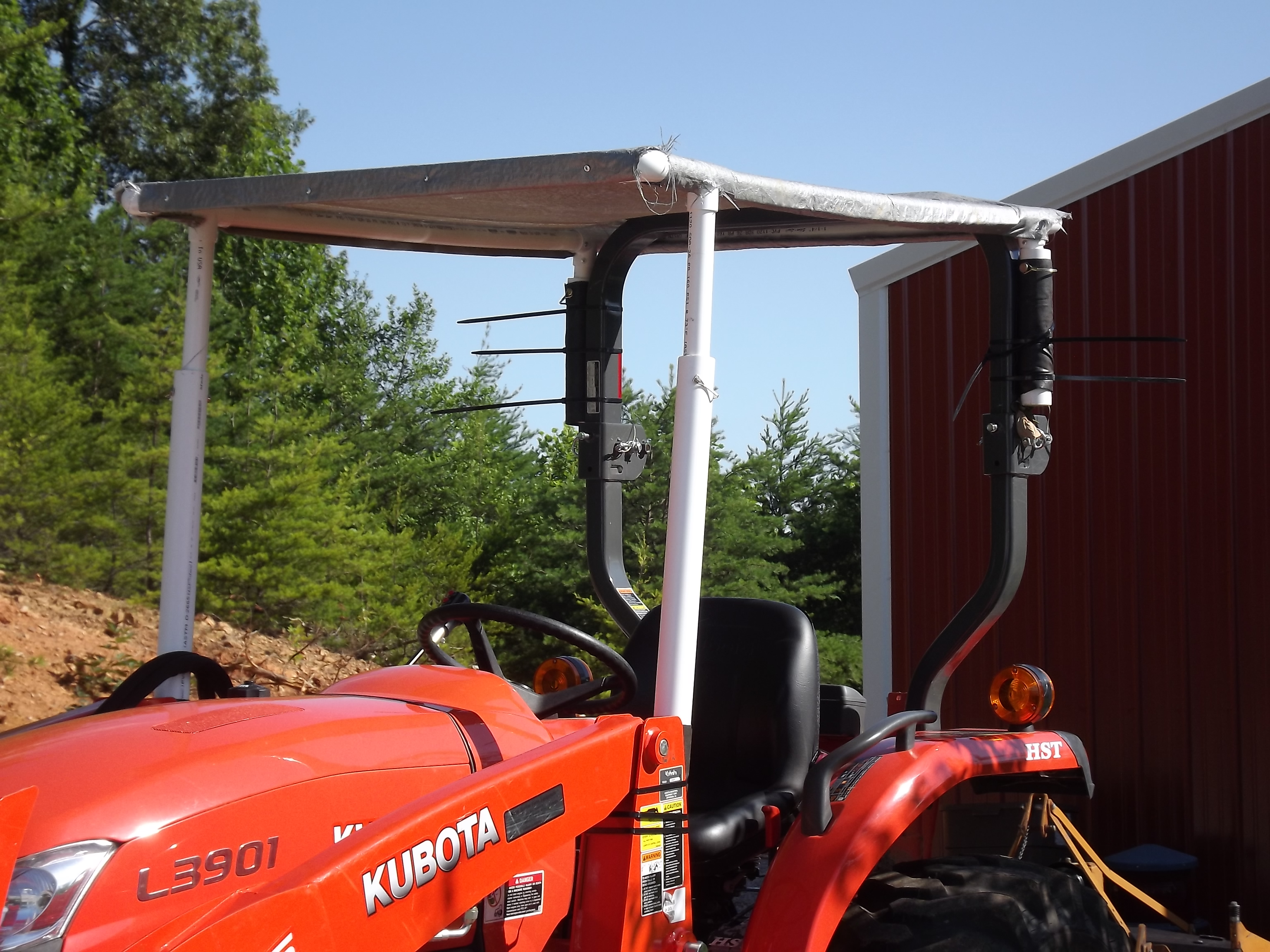

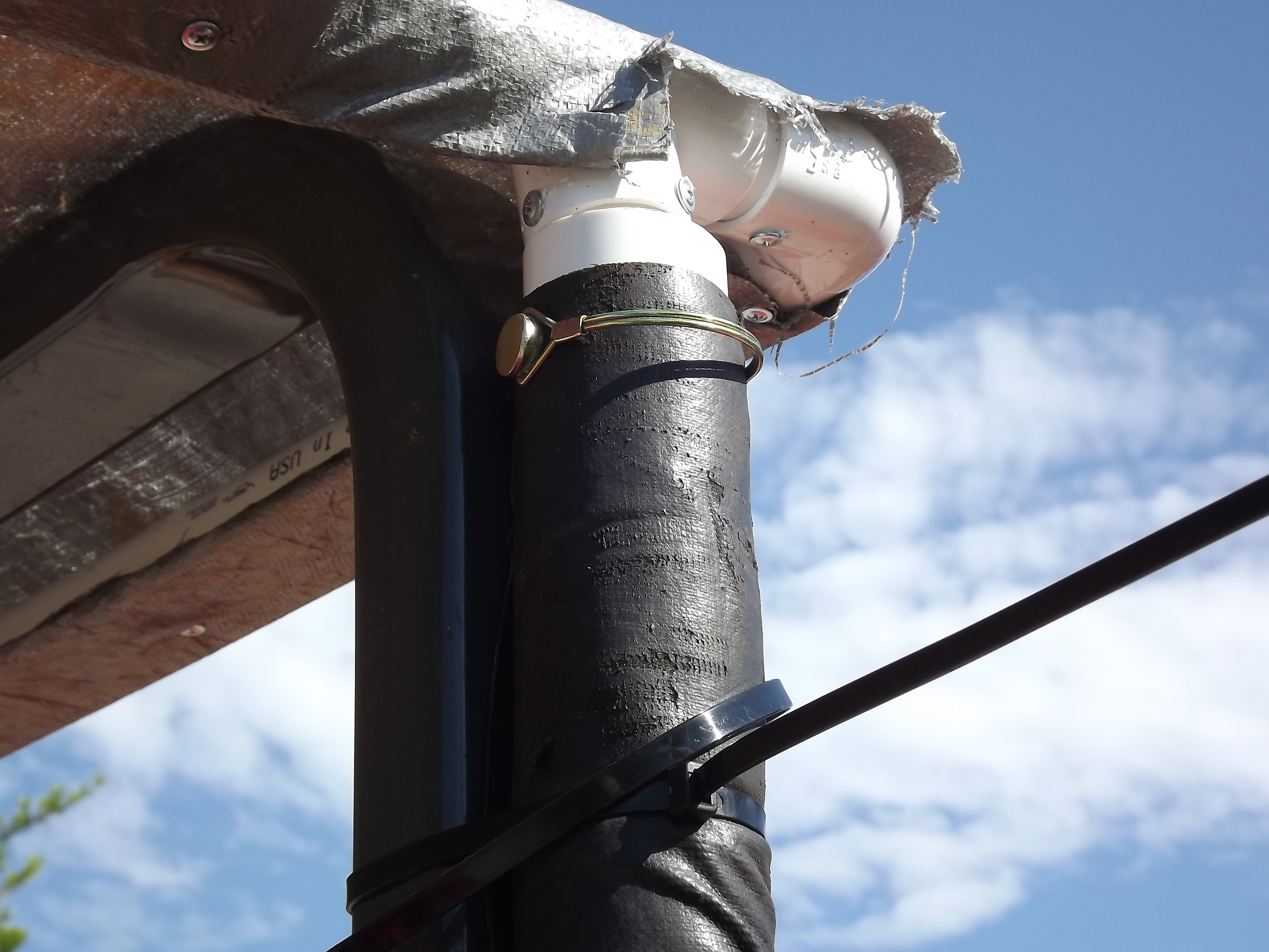

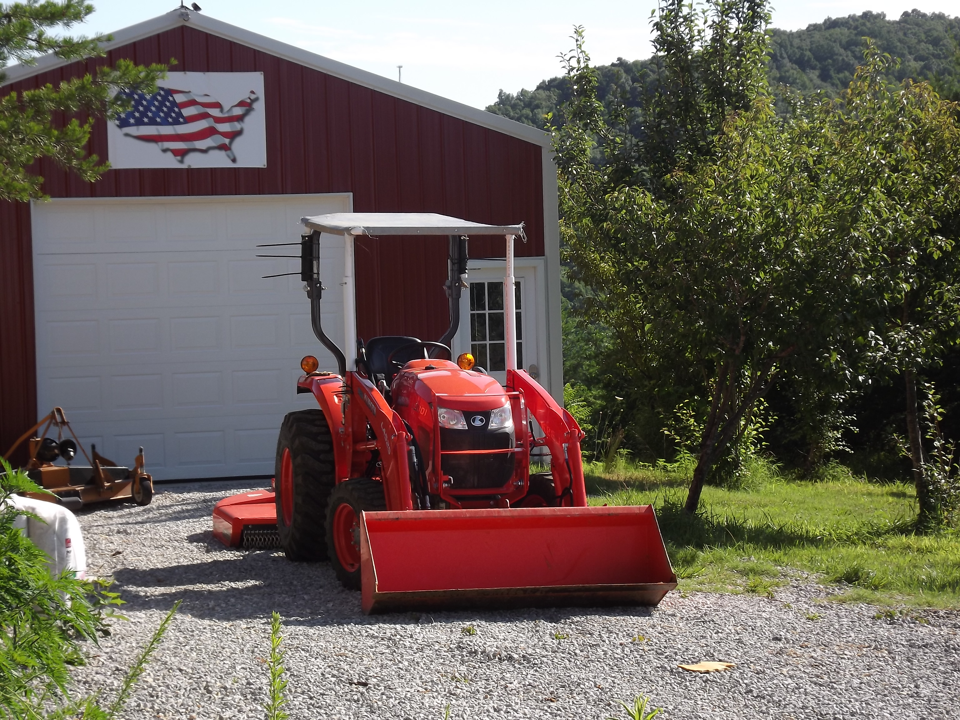

I have a few Kubotas with sunshades which cost around $400 apiece. I recently was diagnosed with a probably sun related cancer on my nose so sun avoidance is important to me along with light sensitivity vision issues. I let a family member keep the sunshade on the small Z mower I sold them so needed a sun shade for the new L3901. Checked for pricing and durability and opinions of other sunshade owners and decided to just build my own which has to be easily removed by myself for using the tractor in the woods. This is what I built and it's better, lighter and easier to remove than I expected and even a bit cheaper. It cost less than $50 to build.
I had built one a few years ago which worked but was ugly with a capital U and would slide around and did I say Ugly? Decided to give this build a bit more effort, support and appearance.
Rather than try and repost pics I'll add link to my original post seeking input which has the pics. I will do a bit more cleanup and then try and sell them. :D:laughing::laughing: Or sell detailed plan to build for a few bucks or tell you on line (here) for free which is my preference. http://www.tractorbynet.com/forums/...sunshade-experience-anyone-2.html#post4802601

Oh, I like that. Looks to quick and rather easy to make. Not only keeps the sun off, but would help when those quick Summer showers come through, and you just want to get that last thing done... Thanks for the pictures. That really helps! :)

DSCF3325.JPGDSCF3324.JPGDSCF3326.JPGDSCF3325.JPGDSCF3324.JPGDSCF3326.JPGBought a BX2370-1 this week so I'm seeing another self made sunshade with maybe a few more refinements in the my near future. Sun is shining bright in Ky. :D:cool2:

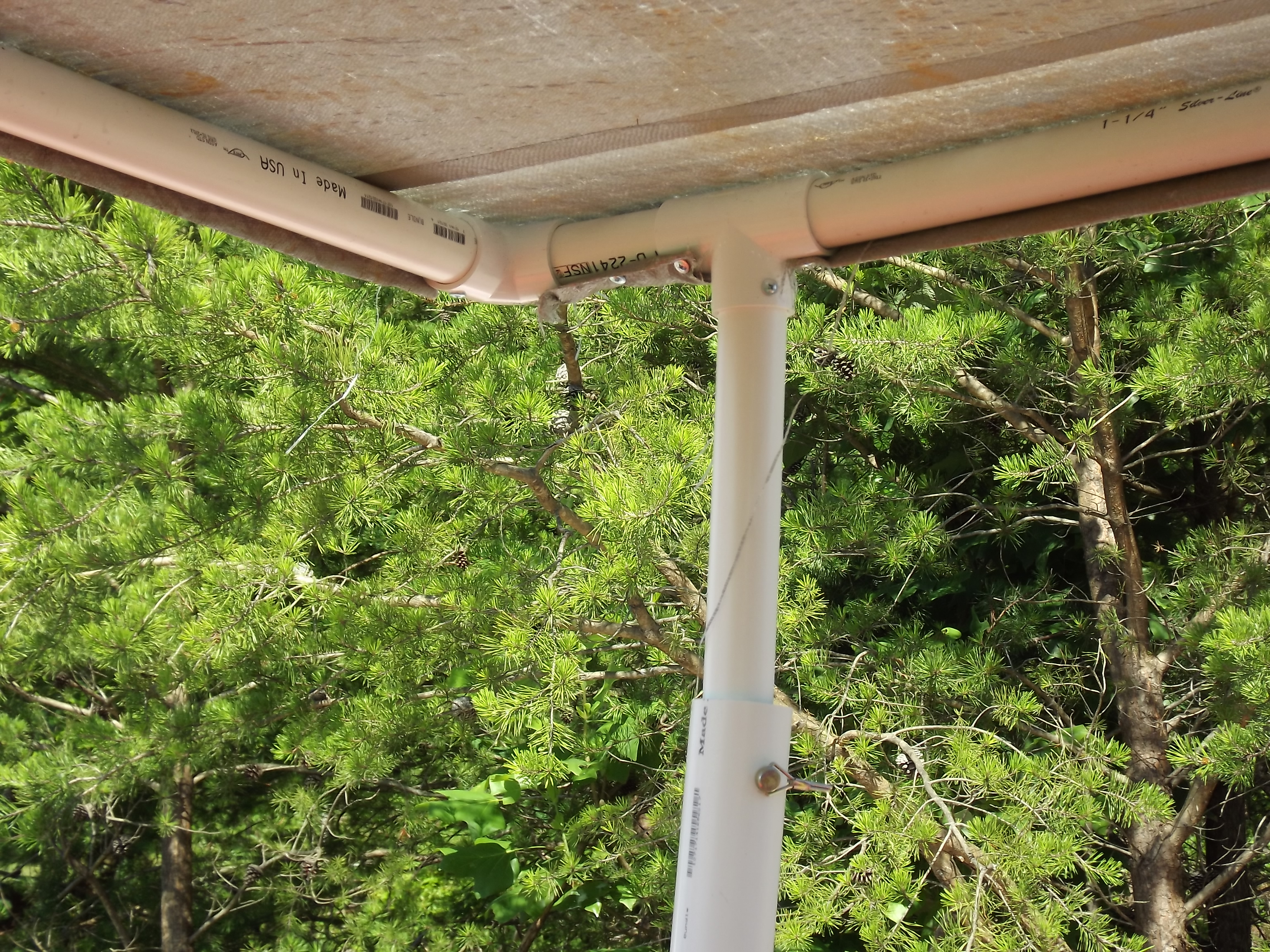

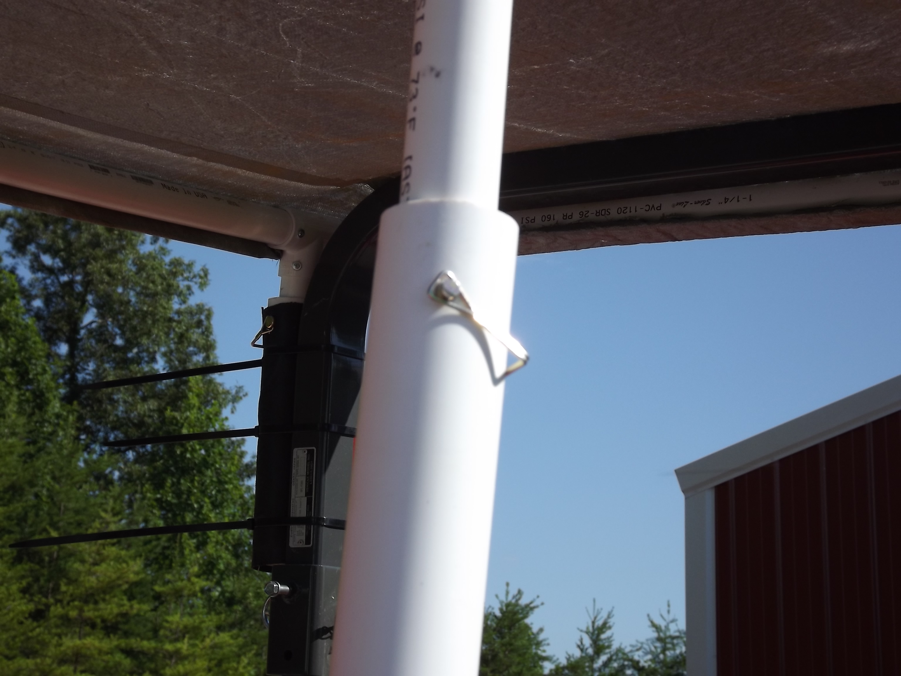

More pics.DSCF3335.JPGDSCF3334.JPGDSCF3333.JPGDSCF3332.JPGDSCF3331.JPGDSCF3330.JPGDSCF3329.JPGDSCF3335.JPGDSCF3334.JPGDSCF3333.JPGDSCF3332.JPGDSCF3331.JPGDSCF3330.JPGDSCF3329.JPG
