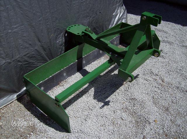

Finished up my "make-shift box blade today!:) One 5' King Kutter "XB" 3-pt blade, 5' of heavy wall 2" square tubing, two 1' x 2' x 1/4" steel plates, a few bolts, a few pieces of scrap = box blade! I already had the blade, which I didn't use, $55 worth of steel & a little time welding.
If I decide I need scarifiers, I'll add them with another cross-member later! ~~ grnspot110

That's one way around making a trip to the local dealer - nice job ! If you add the scarifiers, you might need to make the right/left pins into clevis mounts, but I think would be a simple task for you.

Nice job making do with most what you have.
