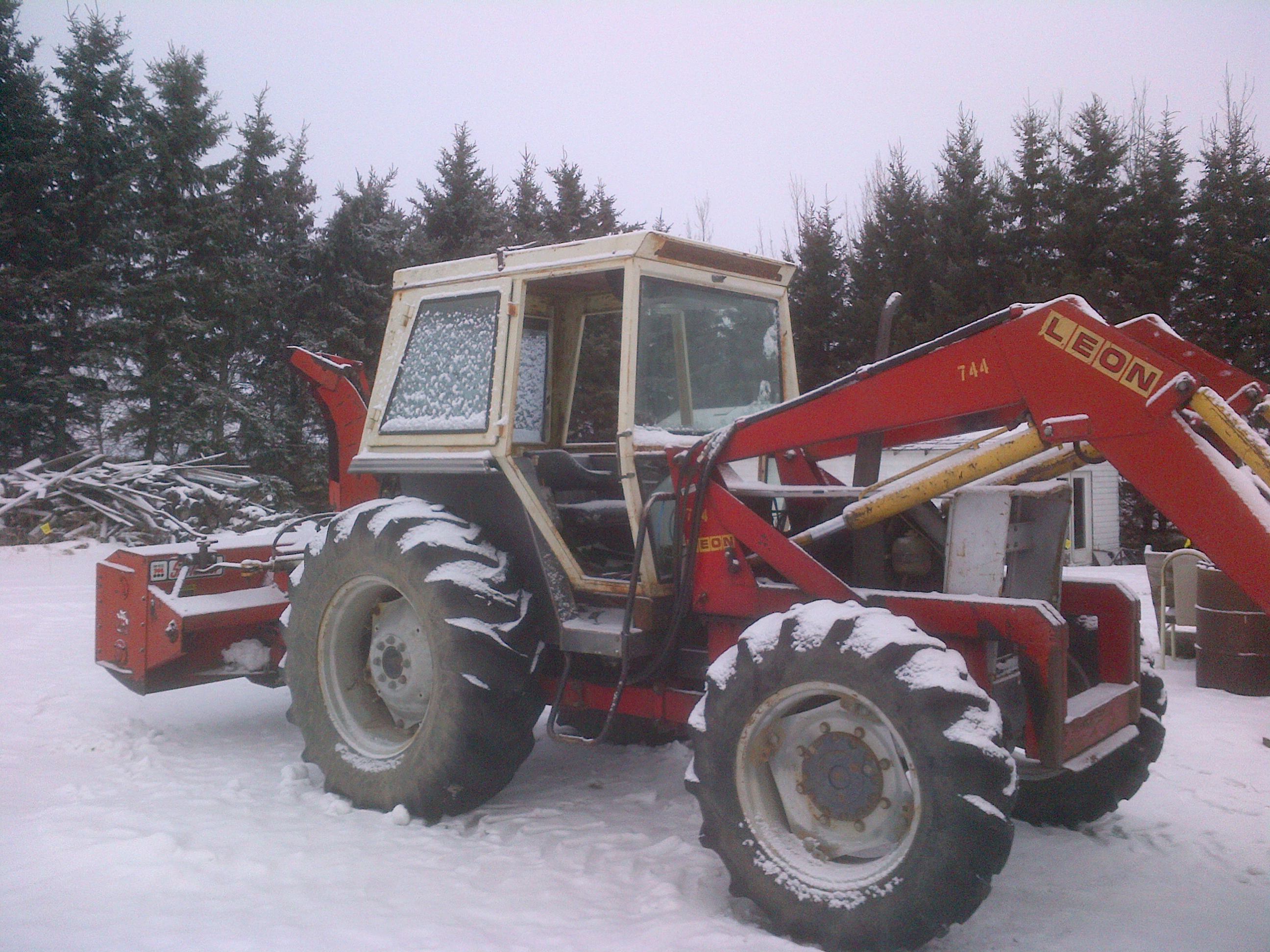

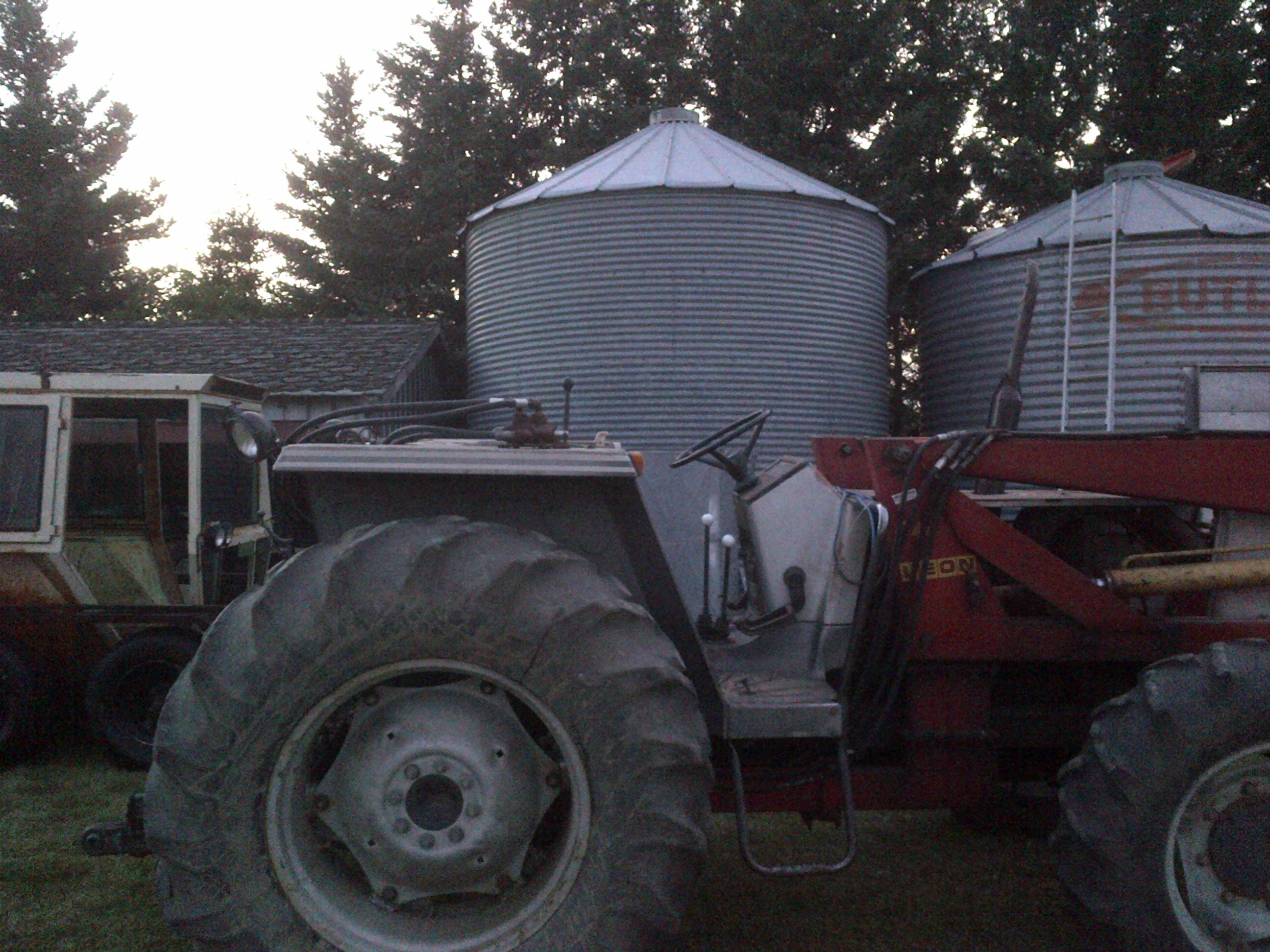

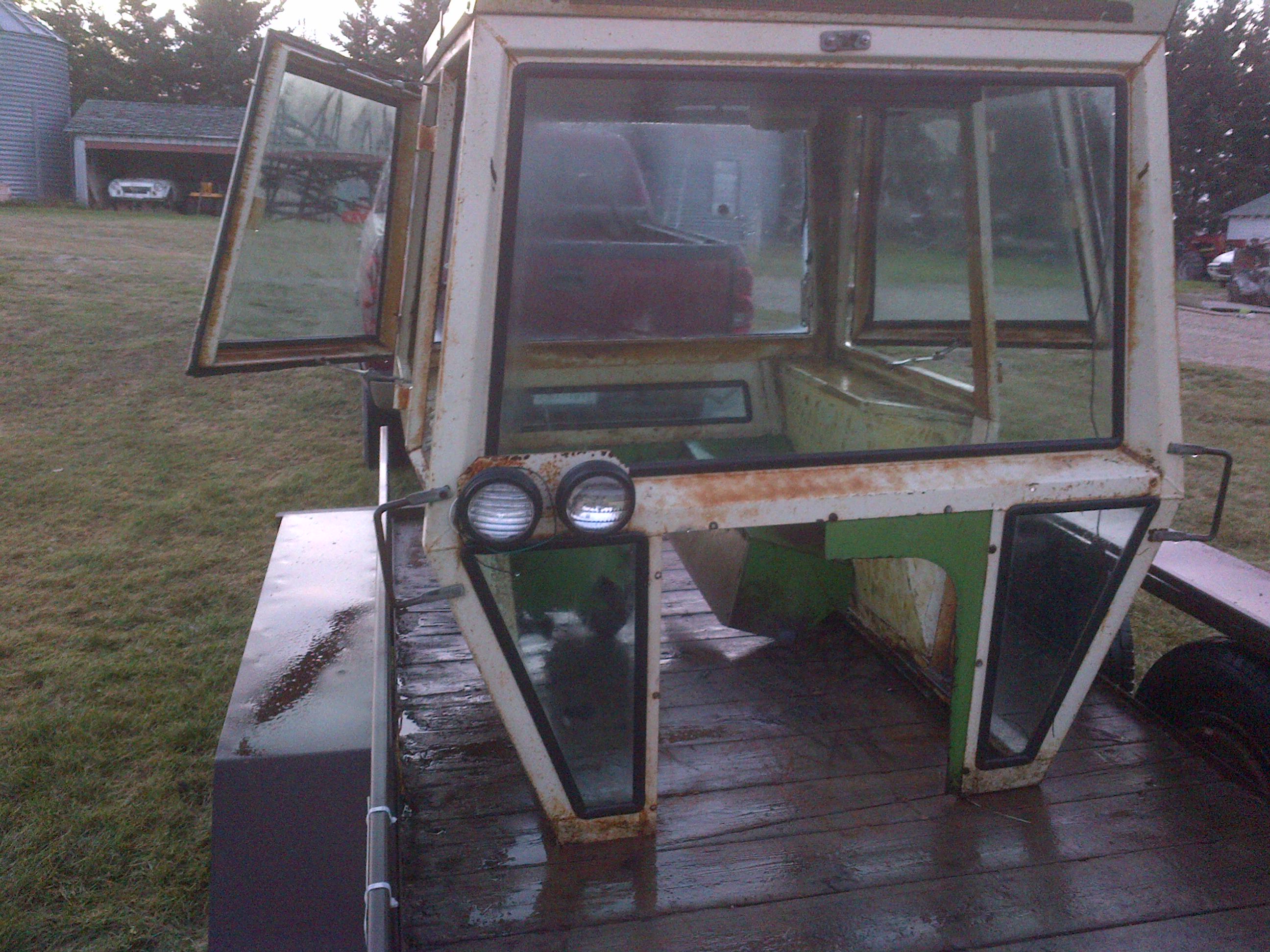

I didnt make a cab, I modified a cab from a different tractor to work. I dont have doors, but it makes all the difference in the world when blowing snow!
And we had lots of snow this year in Saskatchewan, didnt we!
