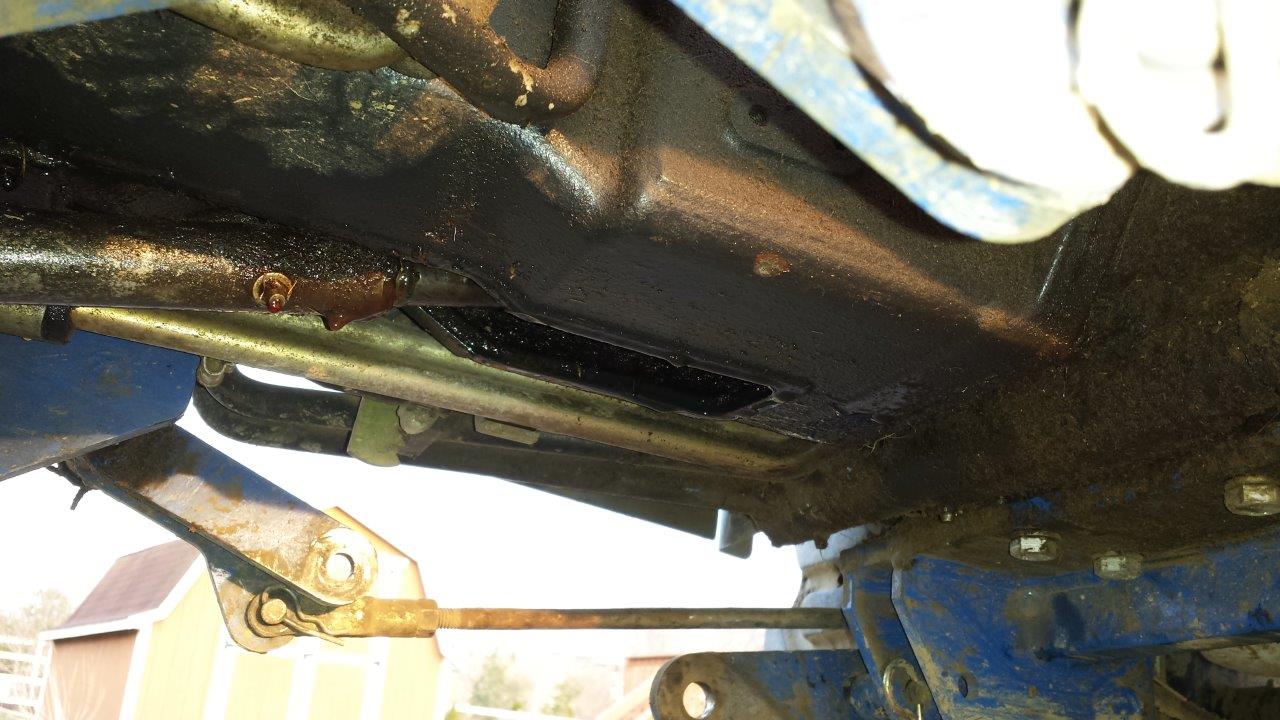

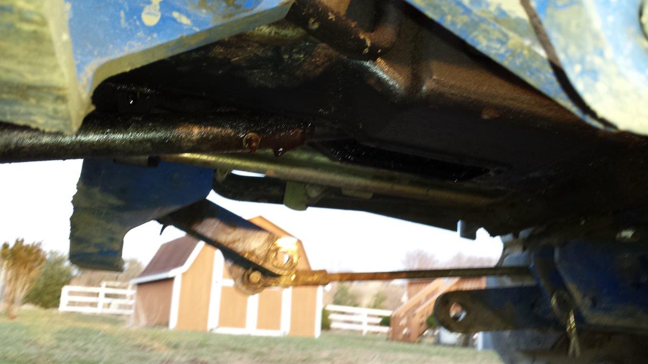

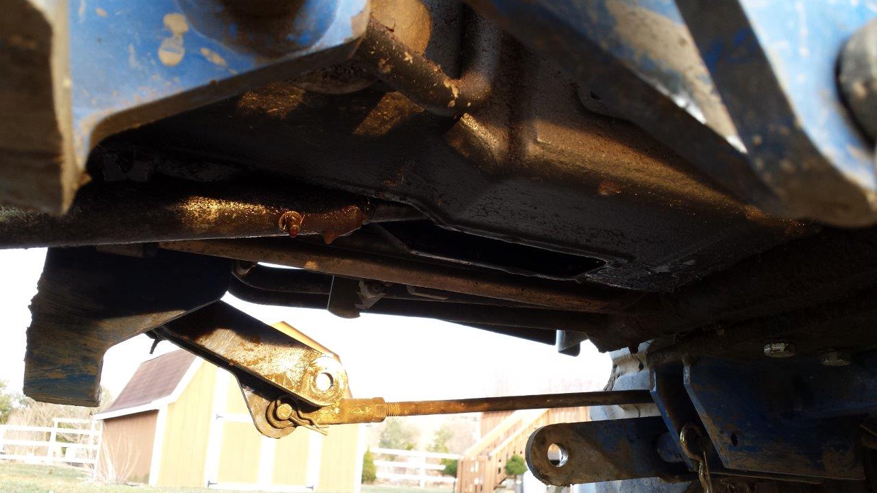

I've been moving a bunch of dirt into the new barn. The good thing is I'm getting close, the bad thing is I've been noticing some
oil drips in my "path." At first I thought it was from where the rubber line joins the metal line along the side of the transmission that I've fix a couple
times before (once under warranty). Well, unfortunately that isn't the case. As you can see from the pics, it is running out of the tranny itself and running down the front drive shaft. Not sure what I'm going to get into here. Looking on ebay to see if I can buy a repair manual for it. Not a good start to mowing 20140322_190722.jpg20140322_190810.jpg20140322_190840.jpgseason.
I guess would help to say, this is my 2003 New Holland TC-24D with a tick over 1700 hours.

Jim, I wish I could offer you some additional advice, but you seem to have done the correct analysis based on what I see in your photos. I think your engine or transmission seal is leaking. Can you tell if it is hydraulic or engine oil?
   / Major transmission hydraulic leak
Jim it is hydraulic fluid. I sent pictures to my wife's uncle. He is a New Holland mechanic. He said looks to be either a seal for the front drive shaft or possibly some type of line running up over top. Our temp dropped back down to about 38 for a high today so whenever I can get back outside and not have to be all bundled up, I'll let you know more. In the meantime if anyone else has had this please chime in.

I finally had a day to look at this, unfortunately I didn't make any progress. I crawled under it and looked up in the slot where the front drive shaft comes out with a flash light and I can't see where the fluid is coming from. I then pulled the mat off the operator platform and took the dash panel loose. I even removed the platform from the left side, I still can't see where the oil is coming from. I think the tractor is going to have to be split. I really wish I could get someone else to look at it and let me know for sure - the wife's uncle is out of the question at this point due to "family issues" and it doesn't involve me :). On the good side, I did find a manual on ebay tonight and ordered it, the bad part is it was $170. I almost ordered the CD from New Holland, but it would have set me back an additional $60, so I stayed with the paper version.
I added fluid to it tonight and tried to mow. I ran it for about 45 minutes and the belt and the entire deck of the MMM are covered in fluid. Without the MMM, I know not good, but at least I was able to drive it/use it by just keeping an eye on fluid. I don't see how I can do it with the MMM. Now hopefully after spending $170 for a manual, I can figure out how to fix it.
