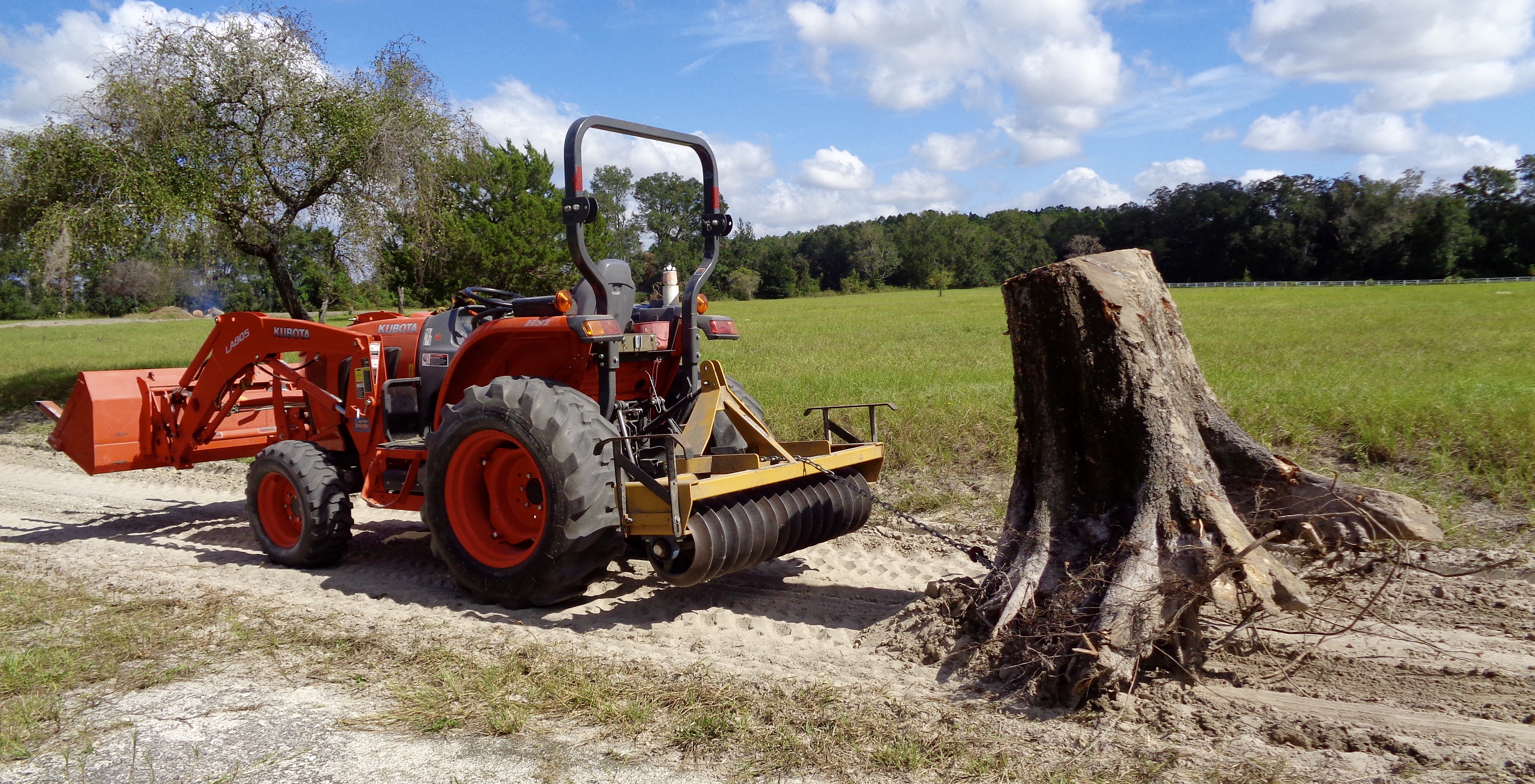

You can use a $7,000 tractor Backhoe for removing stumps. I would not. I would rent or hire in a tracked excavator to deal with the stumps, filling the pond and improving drainage along the road.
VIDEO: excavator removing tree stumps - YouTube

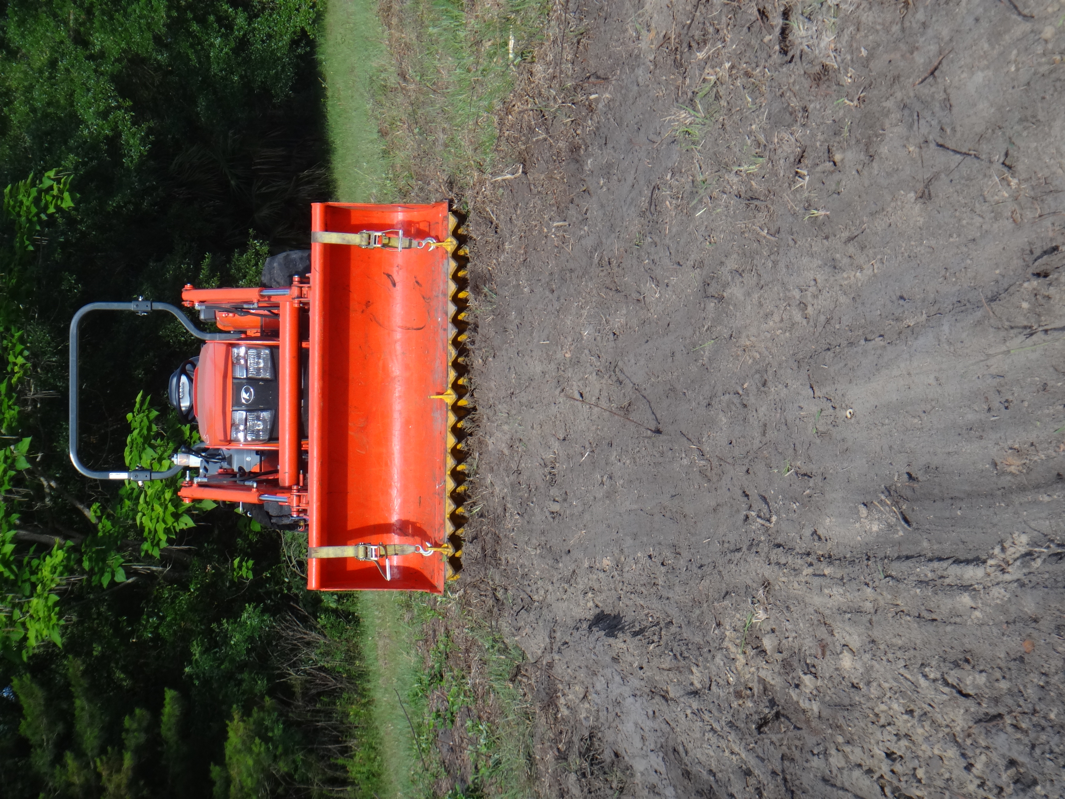

For aerating and root raking a Field Cultivator works very well. This was one of the first four implements sold for the tractor Three Point Hitch.
LINK: http://www.tractorbynet.com/forums/attachments/339095-dirt-dog-all-purpose-plow.html?highlight=

Rip the garden with the Field Cultivator.

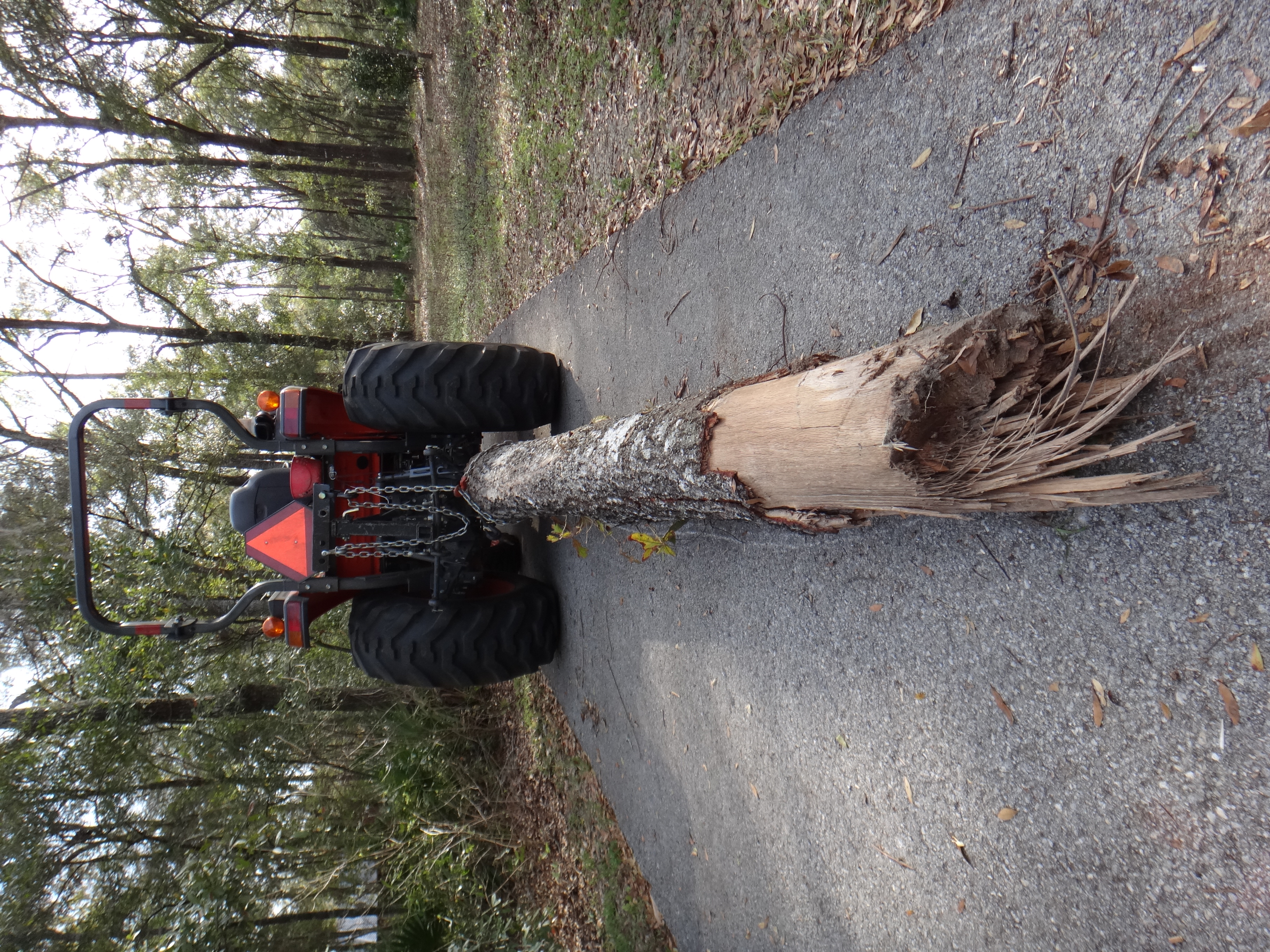

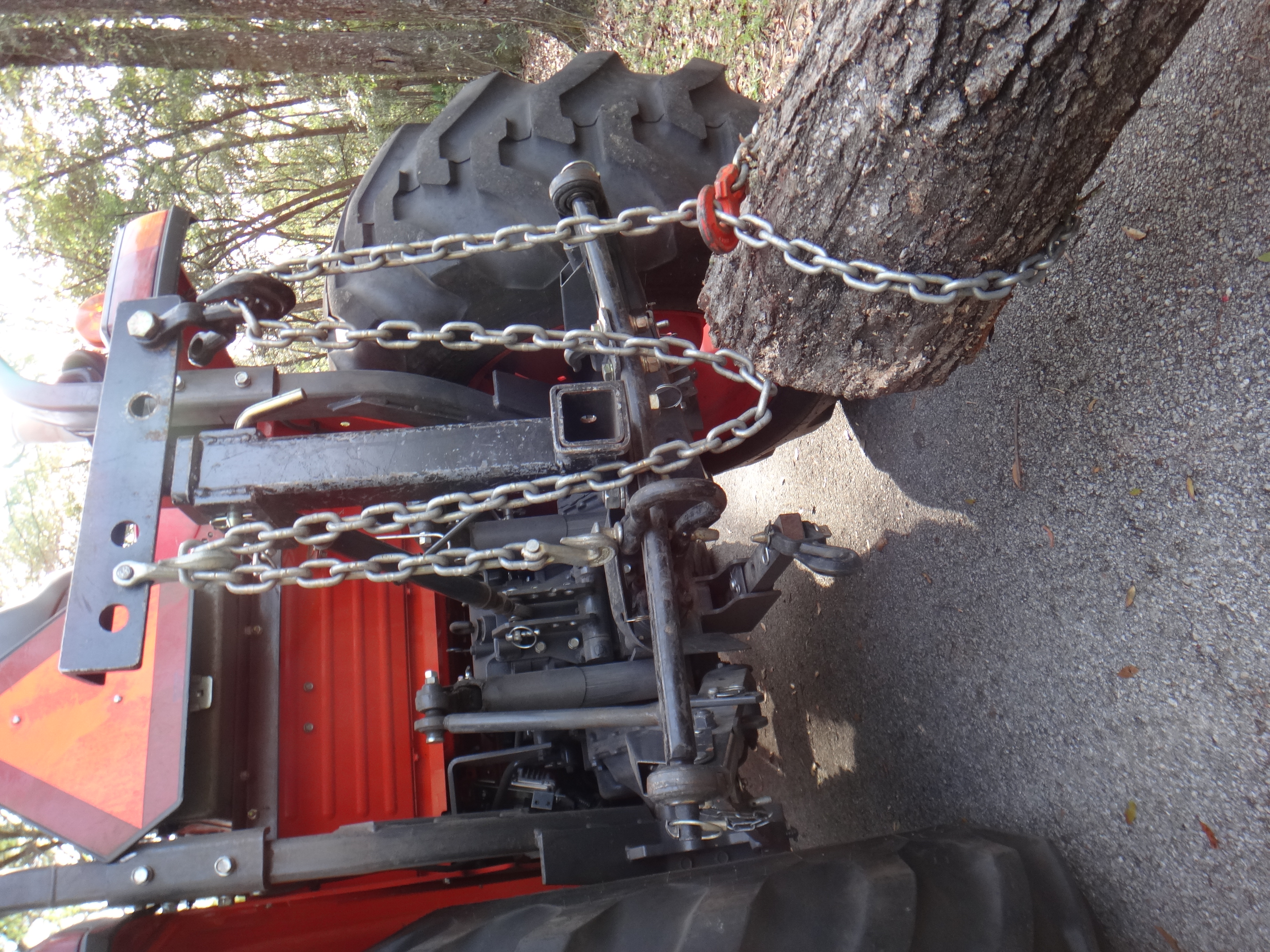

11. I have several large trees that are in various stages of felling due to storms, hurricanes, etc. I would want to turn them into fire pit fuel, building material, etc. so cutting, moving, dragging, needs to be done.
Tractors are geared down. Large rear wheels provide additional mechanical advantage. Not a difficult tractor task.

I might rent a rototiller for ground prep subsequent to root removal. The cultivator will become a lawnweight after the project. (jeffy generally refers to his own threads, an ego thing)

A field cultivator seems like way overkill for a family garden plot on a 4-acre property. You might want to google "no-till gardening" and "permaculture" then decide for yourself about that.
