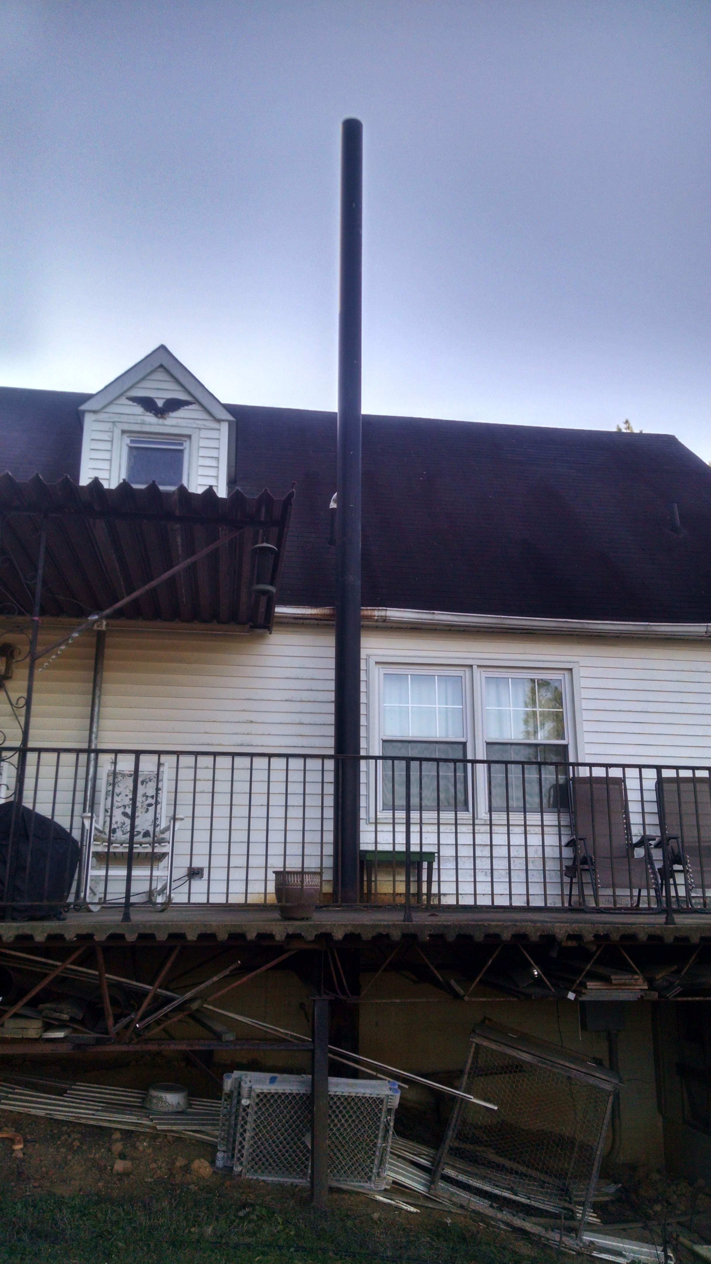

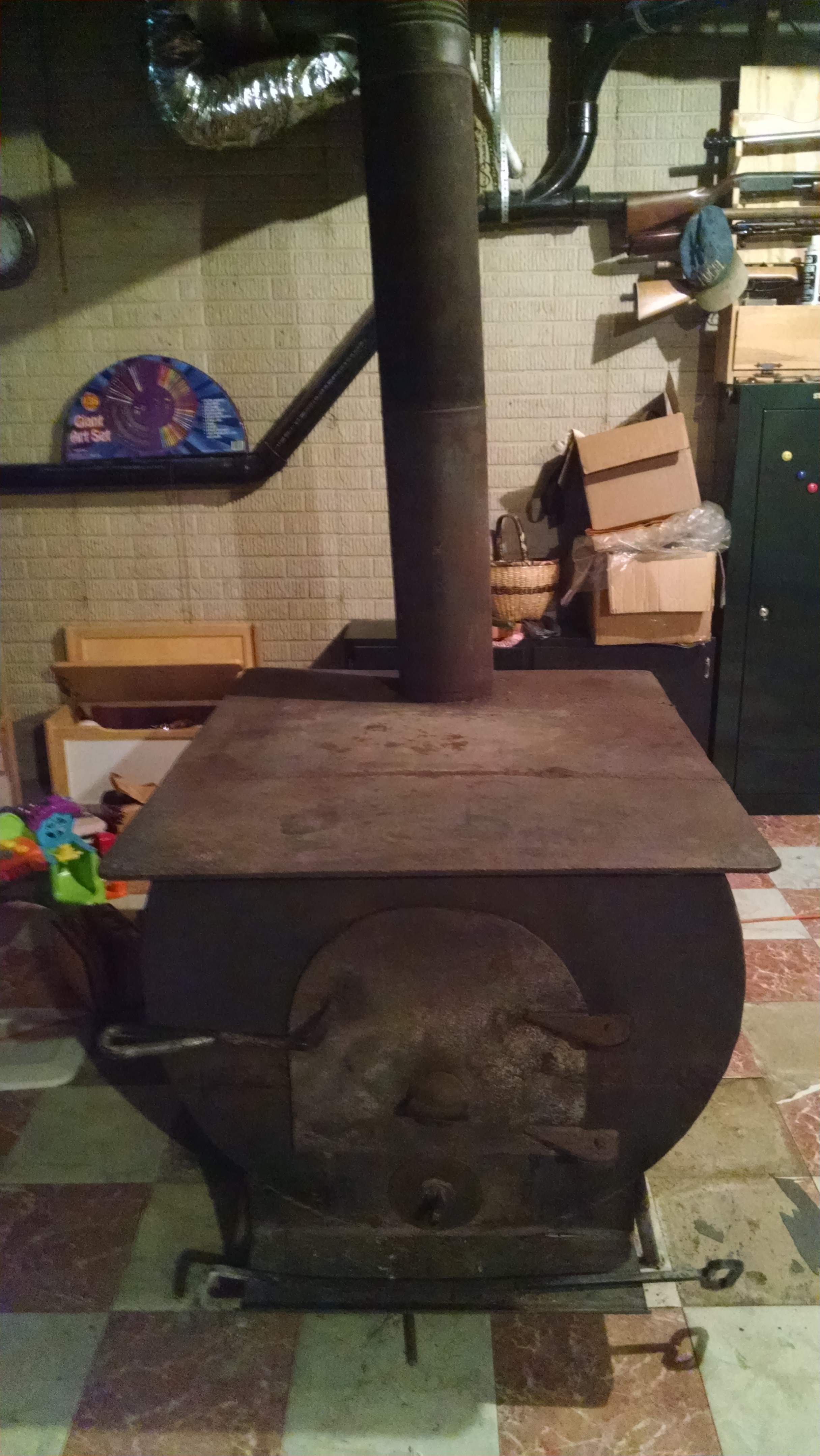

Here are a couple pics of the stove and of the chimney pipe...
Thanks in advance,
David

Looking at your pics and that long outside flue pipe I'd venture to say that a fair amount of preheat would be needed to get a fire going on a cold day. In fact it is too long IMHO and would probably draw reasonably well with about 5-6' above the roof edge. (there is a formula that I forget the exacts but by eyeball I guess 5-6')
   / Major issue with wood-stove - Need advice! #5
Now that i have seen your pictures , an outside chimney cools down very easily and also blocks up easier from cresote . As a chimney cools down from a small fire there will be less draft and any down draft will cause smoke to by pass a leaky door gasket .I can't tell from your outside picture but a chimney should be at least 3 or 4 ft. above the top of your roof level . Any tall trees in the imediate area can also cause a down draft . There should be a clean out somewhere under the tall section of chimney so it could be checked for any blockage and or the stove pipe taken off for inspection for both.

Personally I would replace the stove & modify the stove pipe.
No cap of any kind on pipe. It's a long pipe, you need to burn a real hot fire for a while to get it hot enough to draw. Insulating it would help keep it hot.
There are a lot of high temp sealants that you could seal the door with. If the air inlet seals tight you should be able to put the fire out.
A small fire with that much pipe is not going to work very well & under certain conditions a down draft will push smoke down the pipe. Proper cap would help.

I would turn that stove into scrap SOON before you burn house down around your ears...no floor shield ( stove on exposed vinyl tile??!!!!!)- WAY too close to cardboard/ wood and a HUGE chimney to preheat for descent draft ( no wonder house filled with smoke).... ( pellet stove would work better/ safer and you could go through wall for venting/ air supply)
