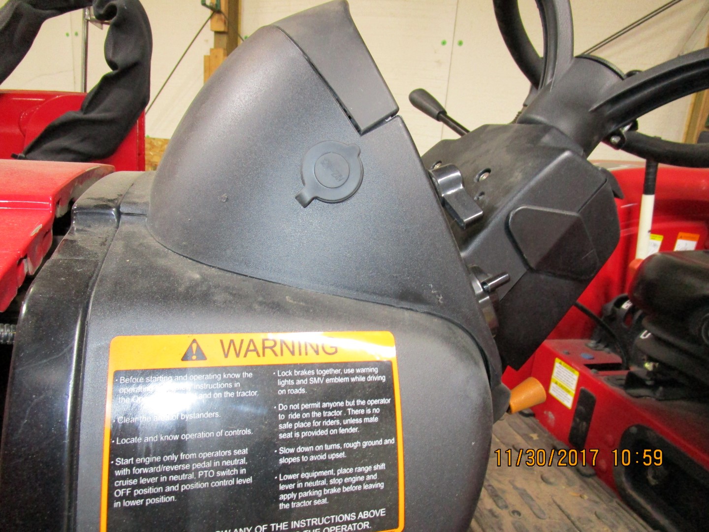

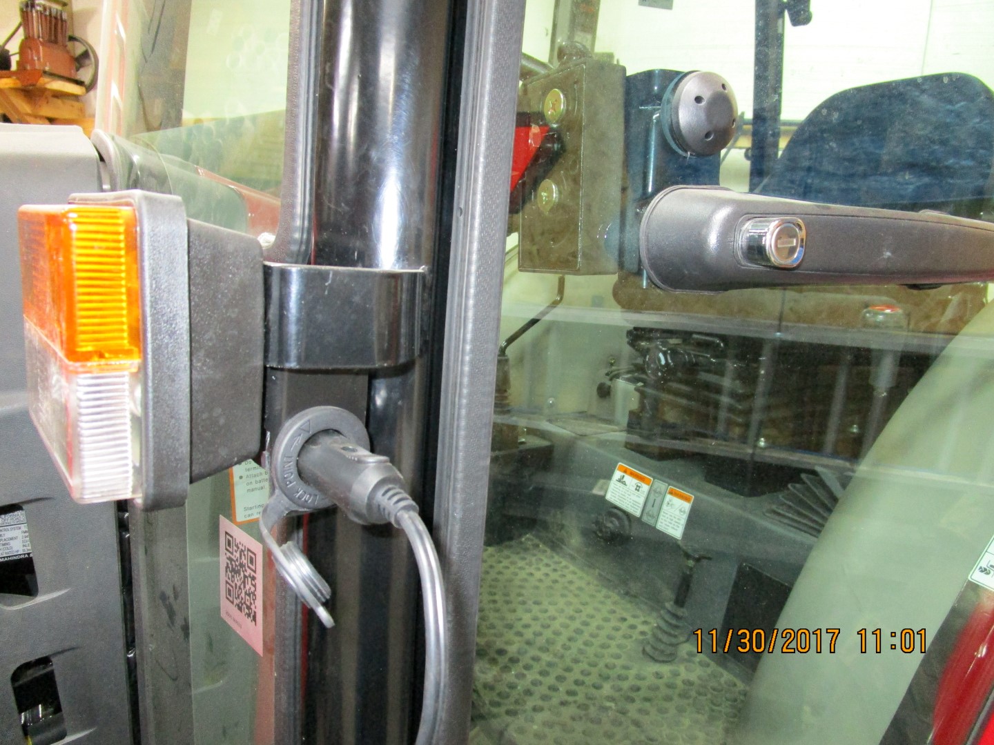

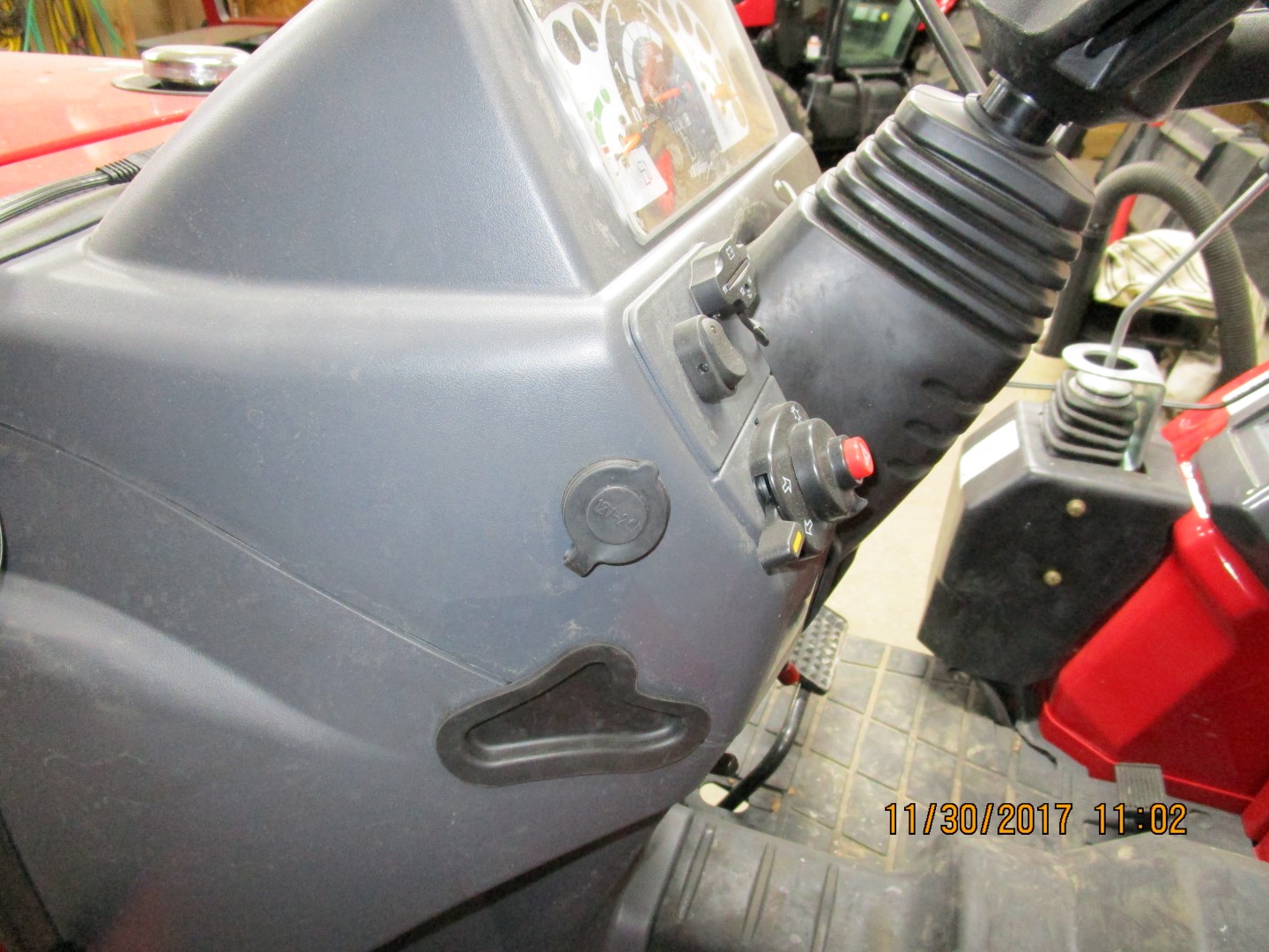

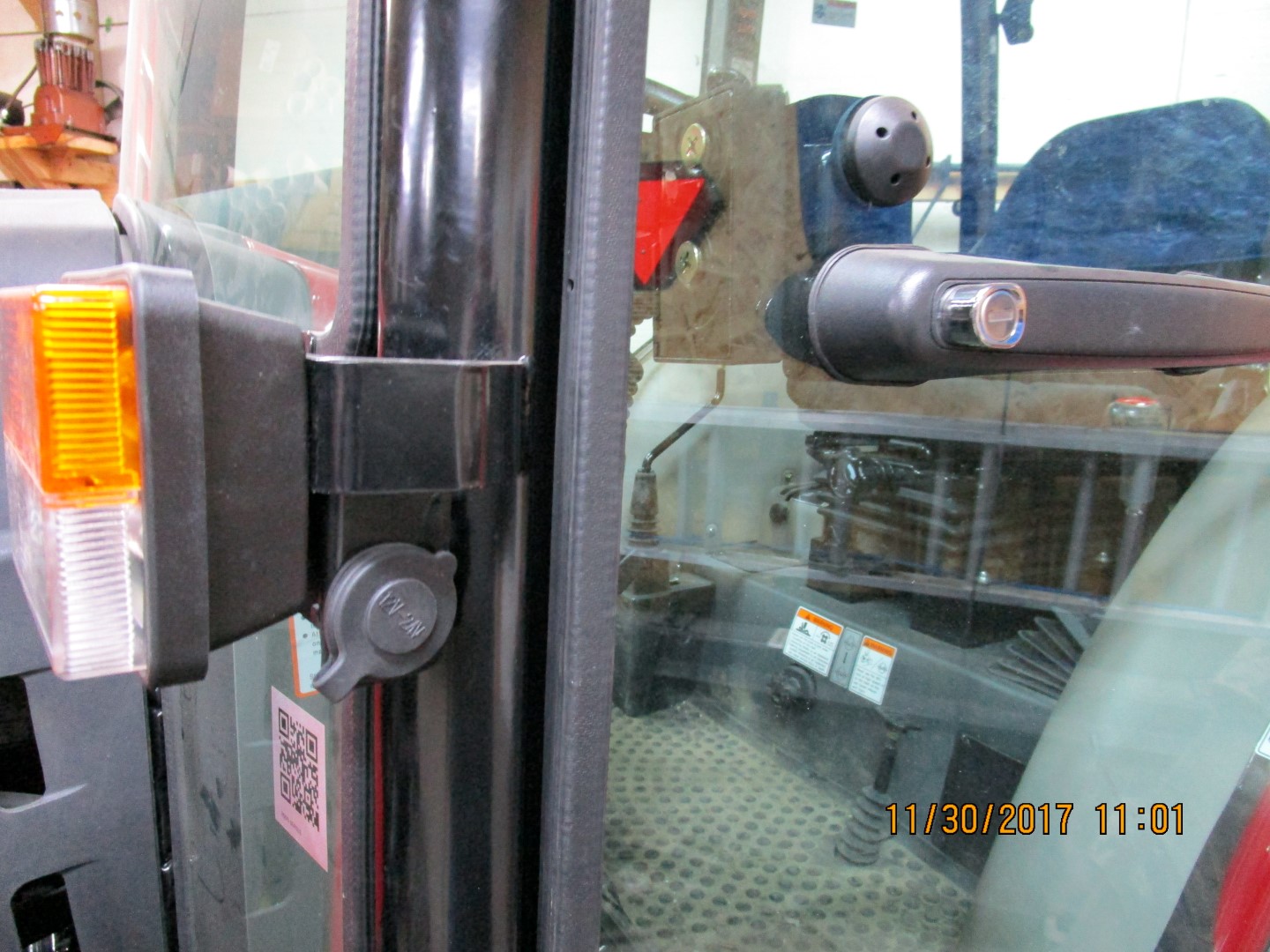

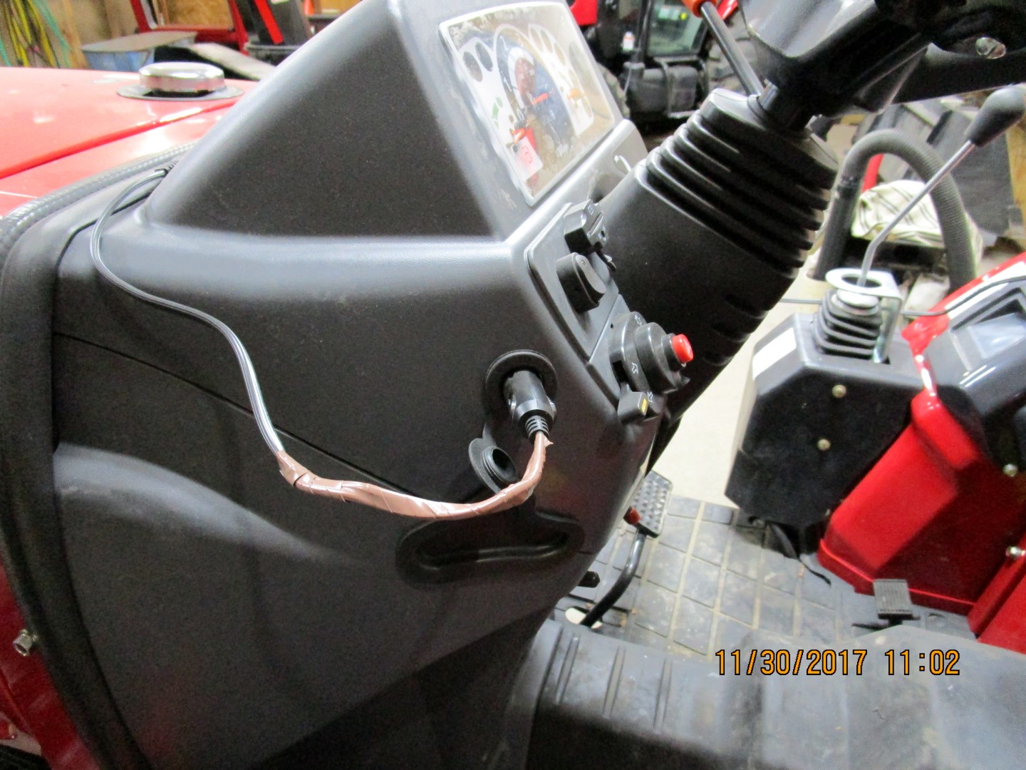

Just finished changing over my fleet of Mahindri so I can hook up the trickle chargers without opening the hood all the time, or clamping the positive onto the starter lug on the 2555. Also get to use some of those cig lighter adapters that came with most of my Schumacher maintainers. First picture is of the old 5035, then the 2555, and finally my new little 1526....

I applaud your efforts, although for 12V trickle chargers it's not a big issue, but one should NEVER use a /plug/ on the powered side of a connection, if that were a high current capable charger that didn't have electronic protection from short circuits, if someone accidentally pulled the plug out of that socket, and it arc'd to something, it could be a potential fire hazard!!!!!!!!!
I do the same thing with all my battery enabled equipment, but I chose to use Anderson connectors (yes, they are overkill on a trickle charger, but...) with a fairly high current lead on the implement side so that should I need to connect a charger bigger than a trickle charger, the same connector will allow that. If you've got a fleet of any size, safety is a big concern, the loss of multiple units due to a fire could be devastating to a small business operation.

Thanks for the concern, but as an old retired electrician, I think I am safe.... Every thing is fused, and the Shumachers won't turn on unless they sense a correct polarity when they are plug'd in. I used to blow the krap out of stuff with real M80's [ even fished a little as a kid with them ], lived thru two tours in Nam with everything physically intact, back fed many a house with a generator hooked up to a welder or dryer plug, played with matches, did not go blind, and other than being allergic to penicillin from too many jaunts to Saigon or Manila... am generally in pretty good condition... [ physically again ] :)
