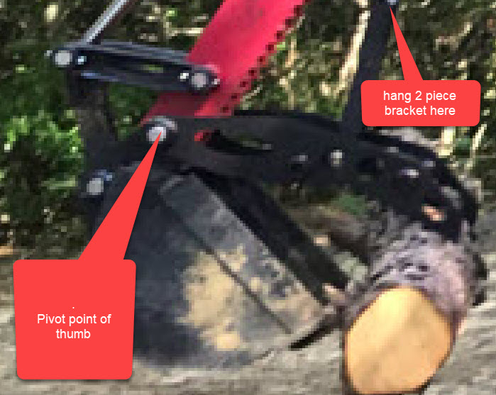

I am stuck out here in God's country a new thumb and can't find directions.
Looks like multiple ways to assemble it. Hoping someone has a good picture of one to see which bolt goes on top vs. bottom and see which way the C channel, adjusting bracket faces.
Thanks for any help as google was no help

Who manufactured the thumb?
Mahindra?

yes, thanks for asking..AMEMHB1746
   / Mahindra with 60B backhoe #4
I too am looking for any instructions on the Mahindra Thumb AMEMHB1746
I never found any instructions but I got it working.
I am not close by to take a pic and I don't have a good one but...........
I do have a bad picture that I enlarged. Hope it helps.
Once you know which pin to remove to install the thumb, it starts making sense.
I still don't know it the C shaped brackets should go but I hung it and it worked. You can see to make adjustment of it after you connect the thumb and the bracket.
Hope this helps.

Thank you. Between your picture and YouTube I think I can figure it out. Fingers crossed
