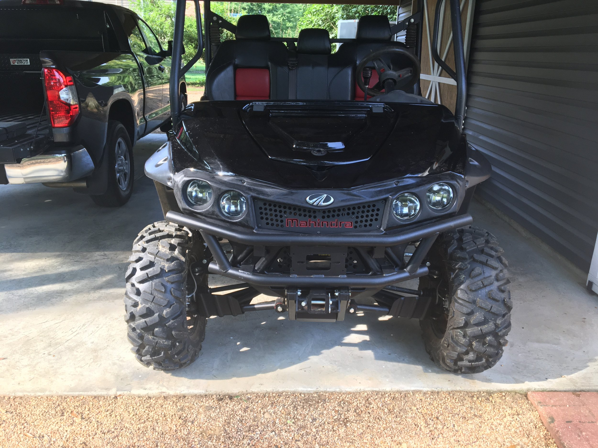

Recently repainted the front grill (famous for fading) and decided while I had it off, not an easy task with the frame at the front receiver hitch, I decided to fix the openings at the lights. I have always been bothered by probably 25% of the lights being covered by the grill.
This is what I did. From the back side of the grill heat the openings with a propane torch until it starts lightly smoking and insert a 4” PVC coupling from the front (what I had, or anything around 4” in diameter).
The end result looks much better and provides better lighting. Sorry, I forgot to take before pictures.
