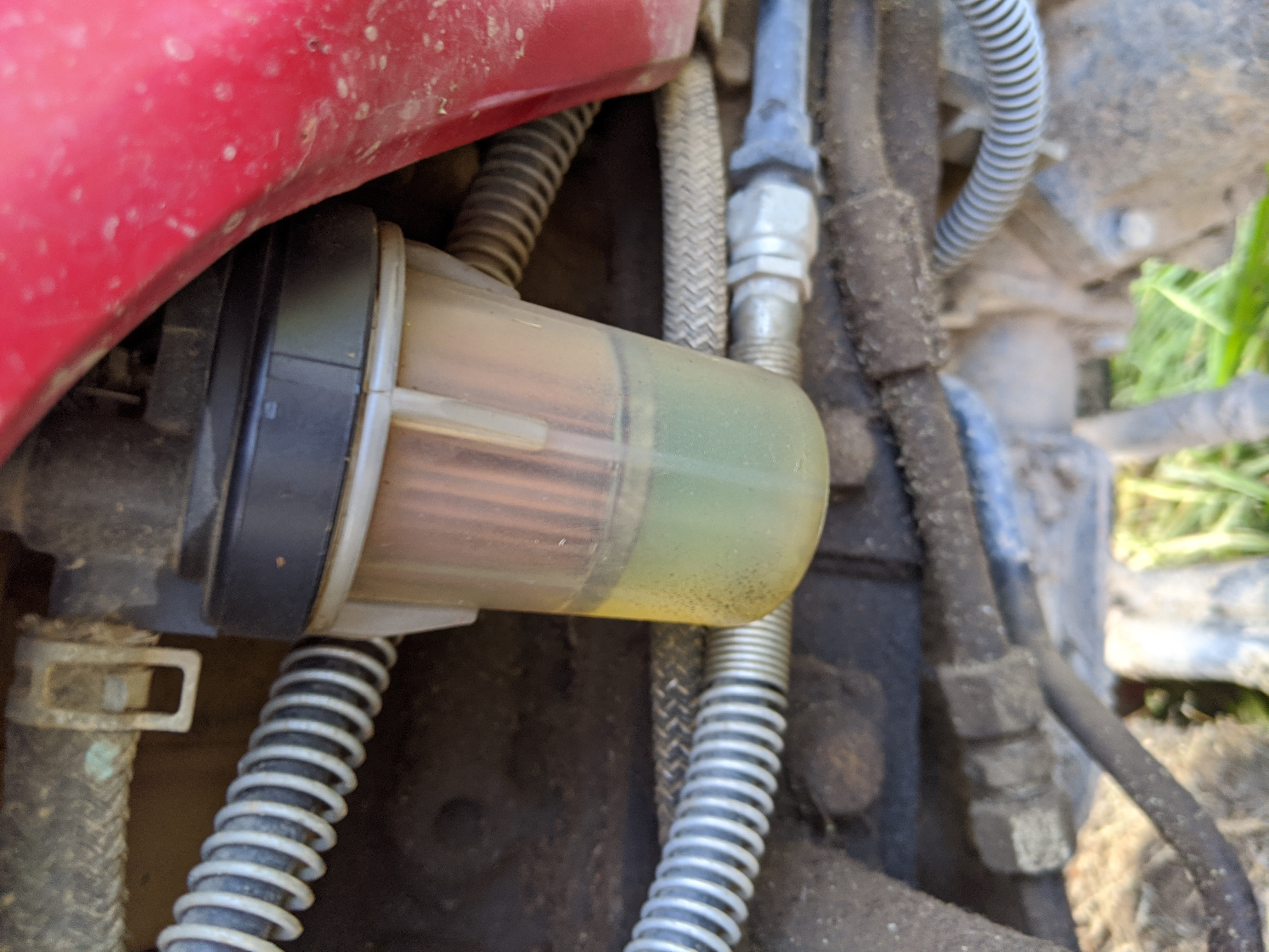

Looking for some advice here... I'm stumped. I keep getting air in my fuel system, and I have no idea where it's coming from. I'll check the fuel filter cup before I start and it's full of fuel. I'll run for a bit, and then I'll have a sudden power loss and the RPMs drop to idle (or lower). If I jump off and check the fuel filter there will be a big air pocket and most of the filter will be exposed with fuel only below the filter.
I'll shut the tractor off and run the auto-bleed routine (turn key to on, leave it there for a minute, system self bleeds) and it's a 50/50 shot on whether or not it fills the fuel cup up again. If I got lucky and it did fill the cup, there is still a good chance I'll have the power loss happen a second or third time.
I've checked all the fuel lines... no visible breaks and no fuel leaking anywhere. Removing the gas tank cap doesn't have any affect on it, but it does have negative air pressure (vacuum) because I can hear air rush in a lot of the times.
I do have an issue with my fuel gauge, the float keeps getting sucked into a crevice in the tank. This makes the gauge read wrong and maybe it's creating some sort of flow restriction? Anyone else have tips / tricks that I should look at to try and figure out what's going on here? Thannks!

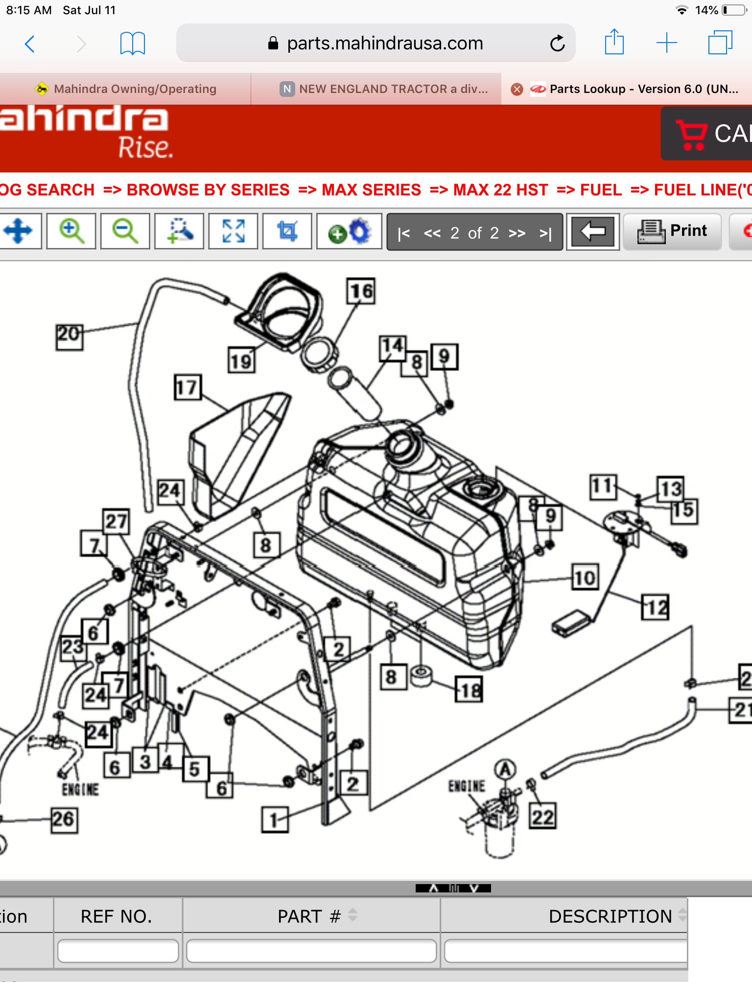

Item 14 is the fuel filter. It is a pretty fine mesh. Be pretty tough to get something in the tank if it’s in place.
/ Mahindra Max - fuel supply issues #14
Yep....I'd agree that should work. Same thing Honda does with their small engine tanks. But my Yanmar came with a big hole and no screen. Both times my tank plugged, it was bugs.
