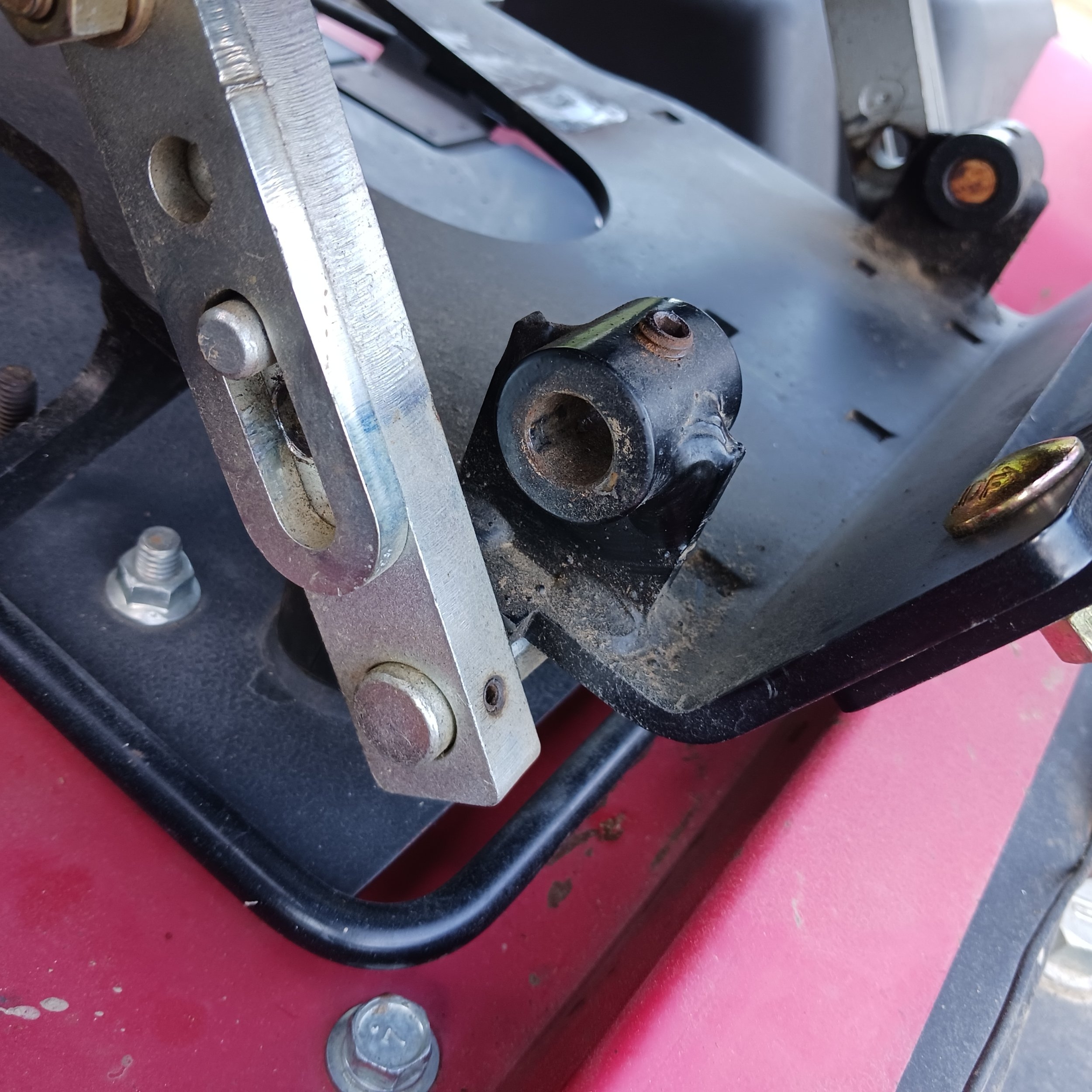

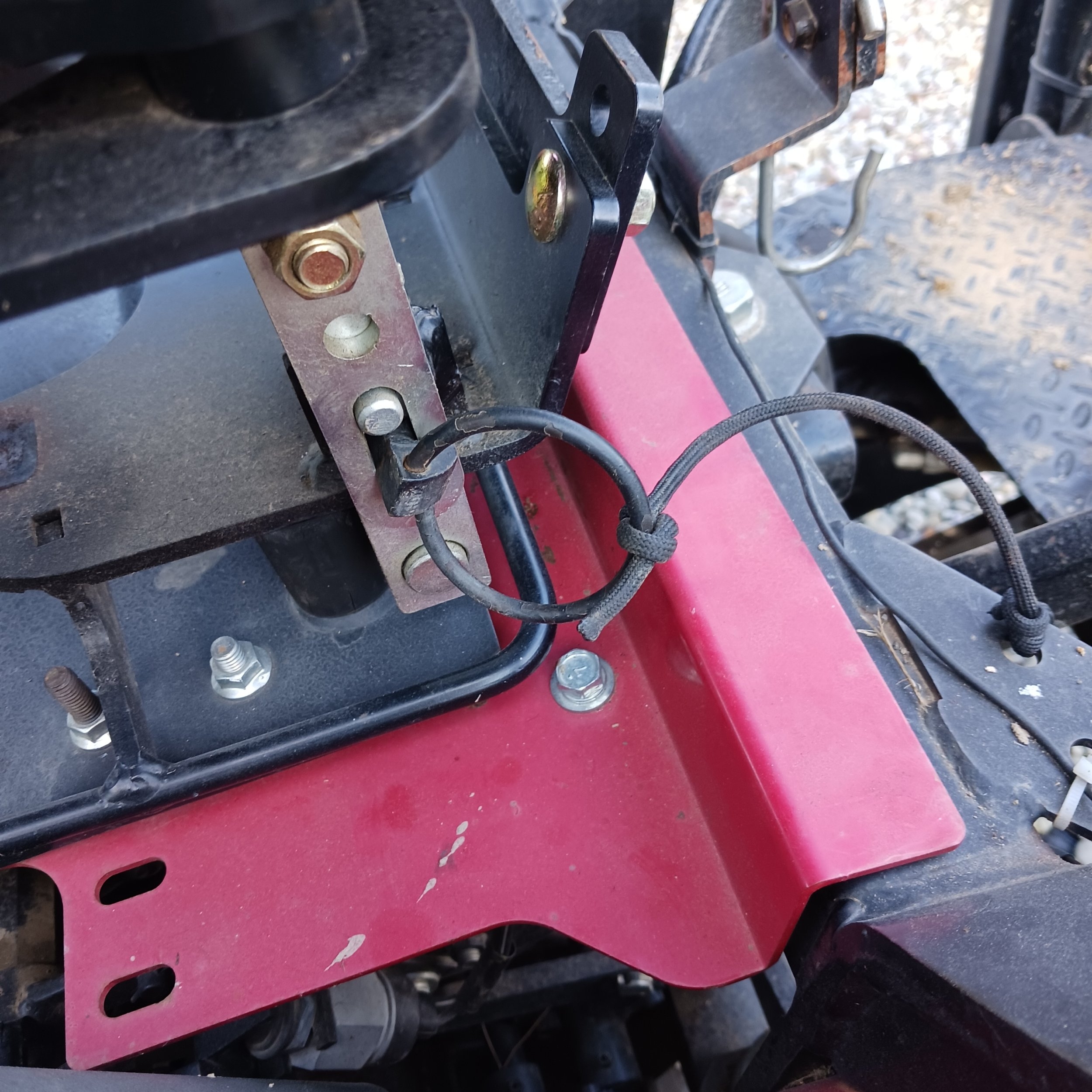

Found a fix for that knuckle breaking seat on my Max 24. (When trying to spin it around for backhoe use.)
Just have to remove the 2 balls that are SUPPOSED to hold the seat up while you spin it.
See pics.

Another fix is to oil or grease the balls so the lubrication allows the steel to not get hung up on the ball/detent.
   / Mahindra Max 24 backhoe seat #3
Great! I did exactly the same thing a year ago after hurting my back trying to manipulate the horrible seat design.Kudos!
