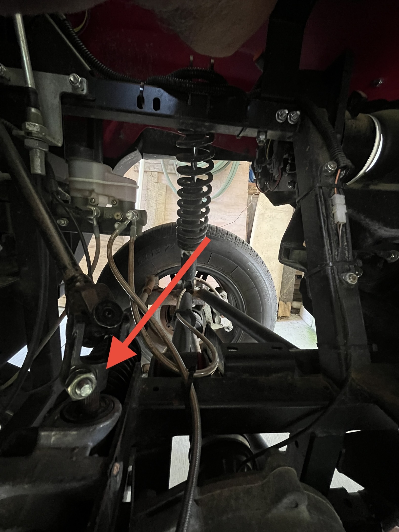

the U bolt on steering shaft will not tighten to rack & pinion stud. No help from dealer. Tried different angles positions with nothing holding…will get it tight & seems the rod will wiggle down. What’s the trick?

Wriggling down could be fixed with another collar below it but I have concerns about the fit between that “u-bolt” and the splined shaft. I worry they you are one bump away from slipping and stripping something.
Maybe the “u-bolt” is as tight as it will get due to wear from slipping up and down?
Personally, I would replace what is out of spec/get better fitment with whatever it takes
Keep us in the loop
