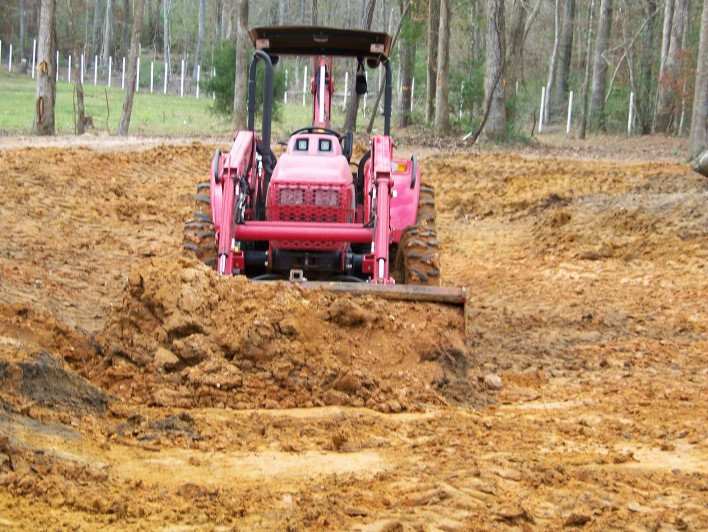

I started my pond with my 6520 4wd with a ML275 loader just pushing dirt like a bulldozer:D and making a basin. She was up to the task.:) I stopped pushing dirt and started using the backhoe because my pond was too narrow to continue pushing dirt and turning around in the basin. A larger pond would have been easier.;) You can check out that project here :cool:http://www.tractorbynet.com/forums/projects/135413-i-finally-started-my-pond.html
hugs, Brandi

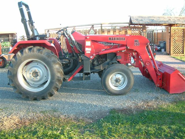

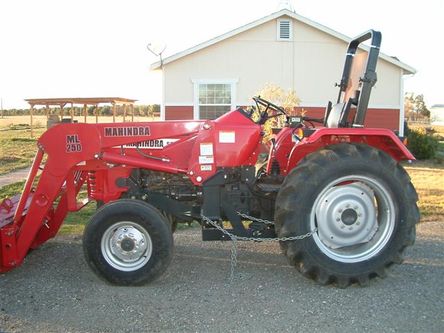

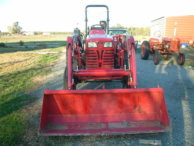

No, I haven't used my 2008 Mahindra 5525 (54 hp engine, 45 hp pto, 2WD, gear tranny 8F/2R, power steering) beyond work around my 10 acre place (discing, plowing, grain drilling, etc). It has the ML250 FEL (6-ft wide bucket, 2980 lb lift to 10.5 ft height). The FEL has the skid steer quick attach option. And the bucket has chain hooks welded on by the dealer.

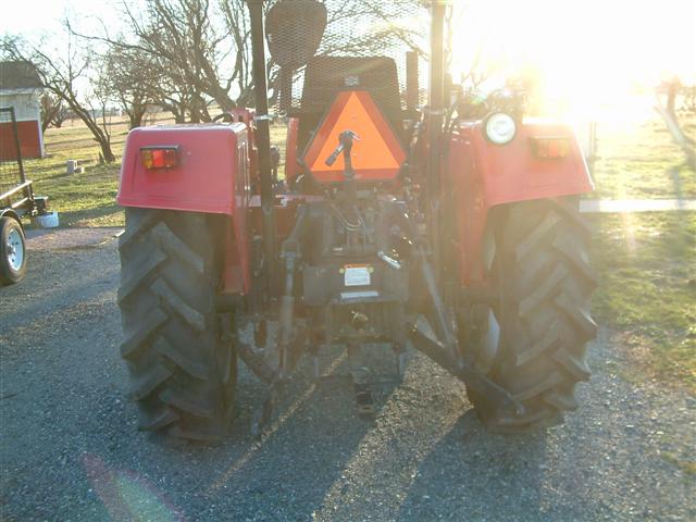

I had the dealer install triple remotes ($750) on the right rear fender.
Total cost was about $20K.
The FEL bucket is pretty stout, but if you're going to be lifting boulders, you might want to weld some stiffeners on the lip and maybe on the sides.
If you prefer a fully synchronized tranny, Mahindra has the 6025 (59 hp engine, 49 hp pto).
Good luck.
