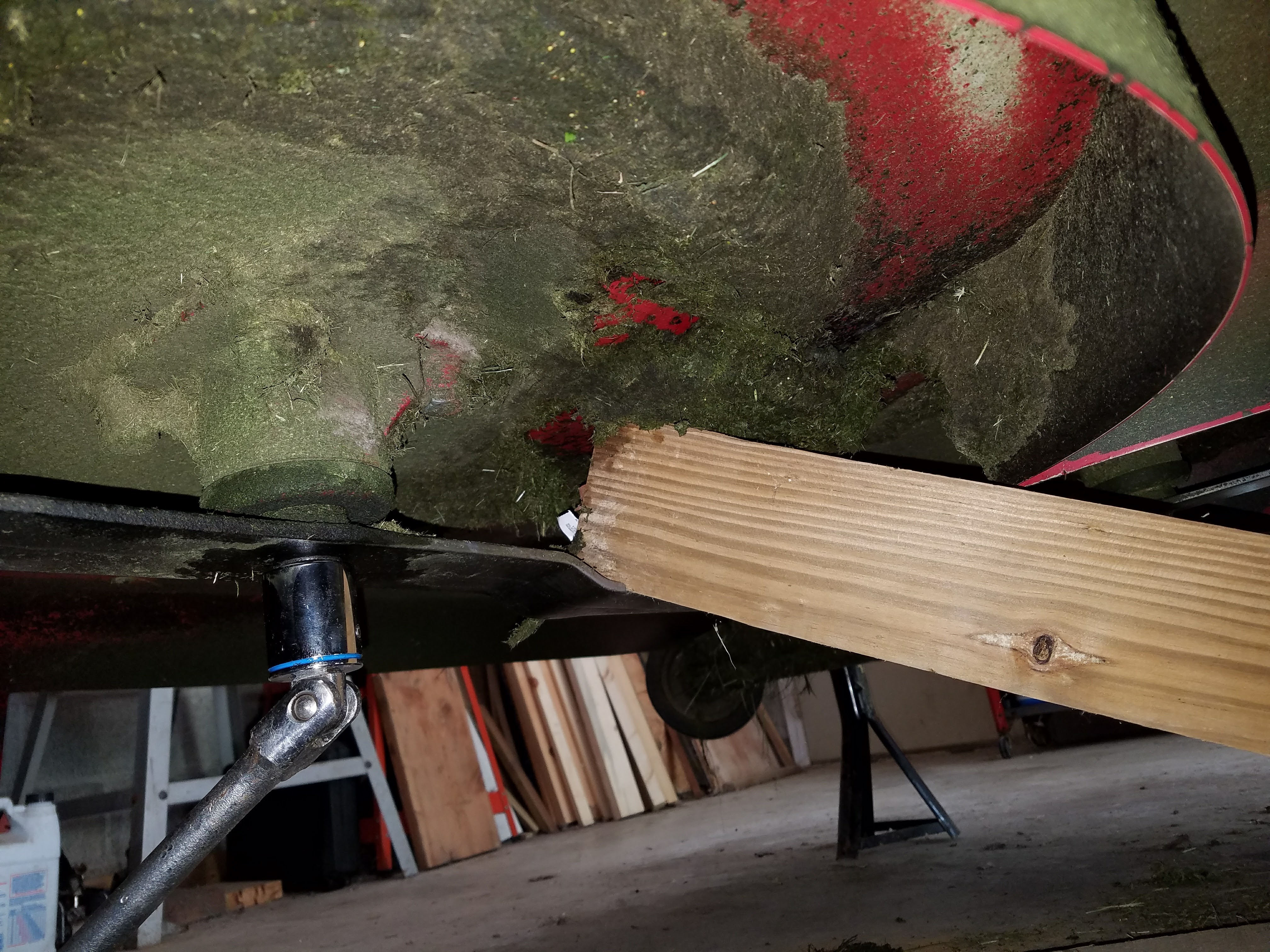

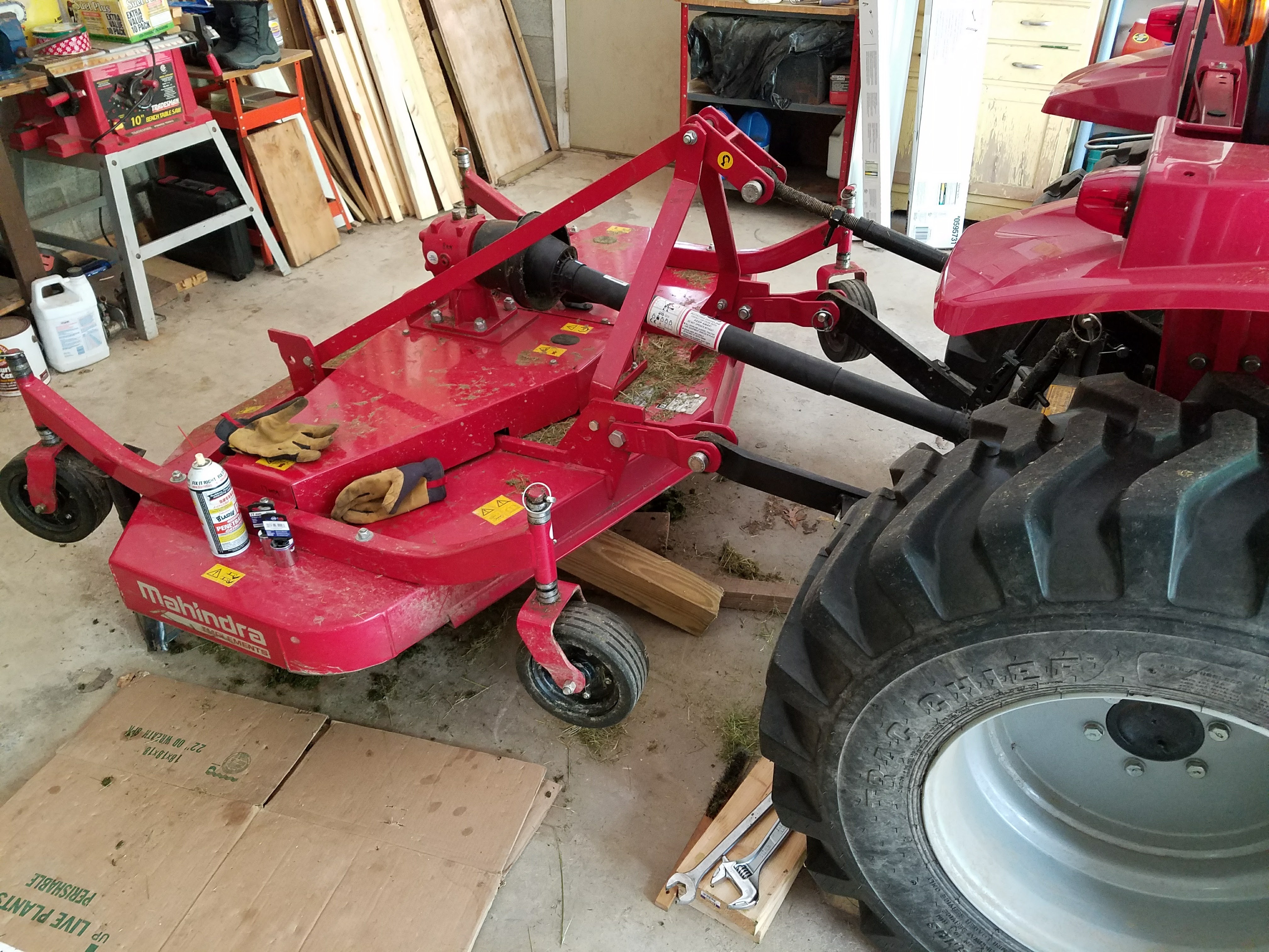

I own a 3016 Mahindra with a 3 point hitch finish mower. I'd like to remove the blades and sharpen them, but can't seem to figure it out. No help from dealer or Google, so I thought I'd try here. It seems the bolts connecting the blades are 26MM, but I cannot get any wrenches to the top bolt to keep the blade from spinning. The manual is not much help. Any ideas?

Maybe block of wood to wedge the blade from moving

I just removed mine and sharpened them a couple of days ago. I used a 2x6 braced against the housing to stop the blade from spinning. The next issue is figuring out whether the shaft is right hand thread or left hand. It took a 4 foot cheater bar to break loose the nut, then it was easy sailing.

Finally got one of the blades off with my breaker bar, a 26MM socket and a 4x4...now my grinder went out! It looks like if I could have gotten a wrench up on the top spindle, it would have been 32MM. I also found out the threads are normal.

My neighbor had a grinder he let me borrow, along with an electric impact wrench and 1 1/8 high impact socket and that worked great!
