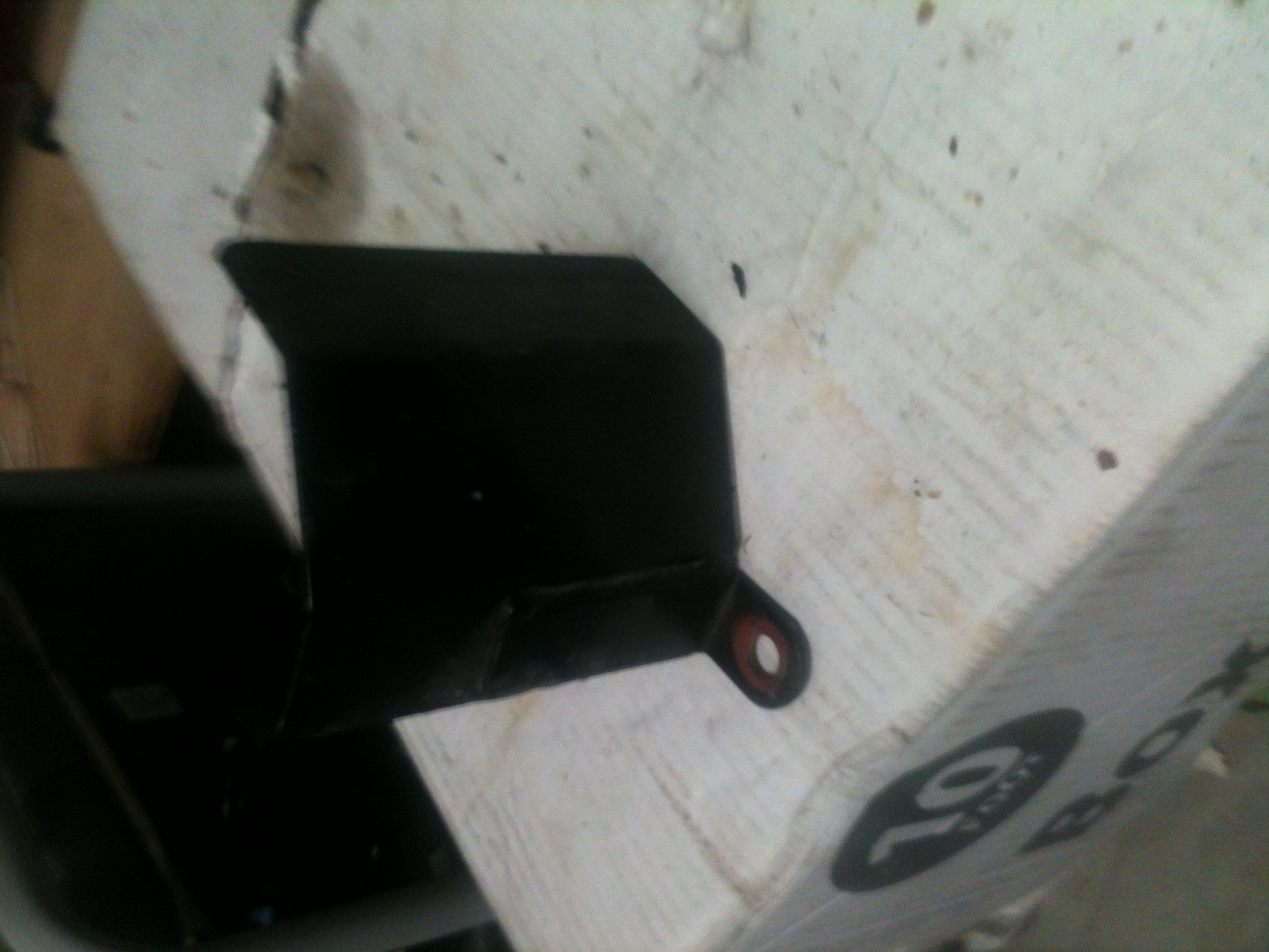

Oh yeah. One more thing. While attempting to get stuck oil filter off last week I discovered a black metal plate that was found lying in the area between oil filter and exhaust pile. Abiut 3"x4" curved metal with a single drilled hole for a bolt. I never kniwlingly moved it. I'll upload pick and see if someone can help me determine where it goes. I though maybe the side panels I removed utilized it, but I don't think say. It does have some red over spray paint on it. Any idea where it goes? I'll upload pic later. Thx

Any idea where/what this piece is?
   / Mahindra. EnglishMetric? or a combination? #8
I would bet that it was a cover piece for when the thing went thru a paint booth at the factory that fell down when it was removed... [ but that's all you get for your 2 cents.... :) ] You don't need to remove all those other plugs to drain, but you should clean off the magnets next time....
