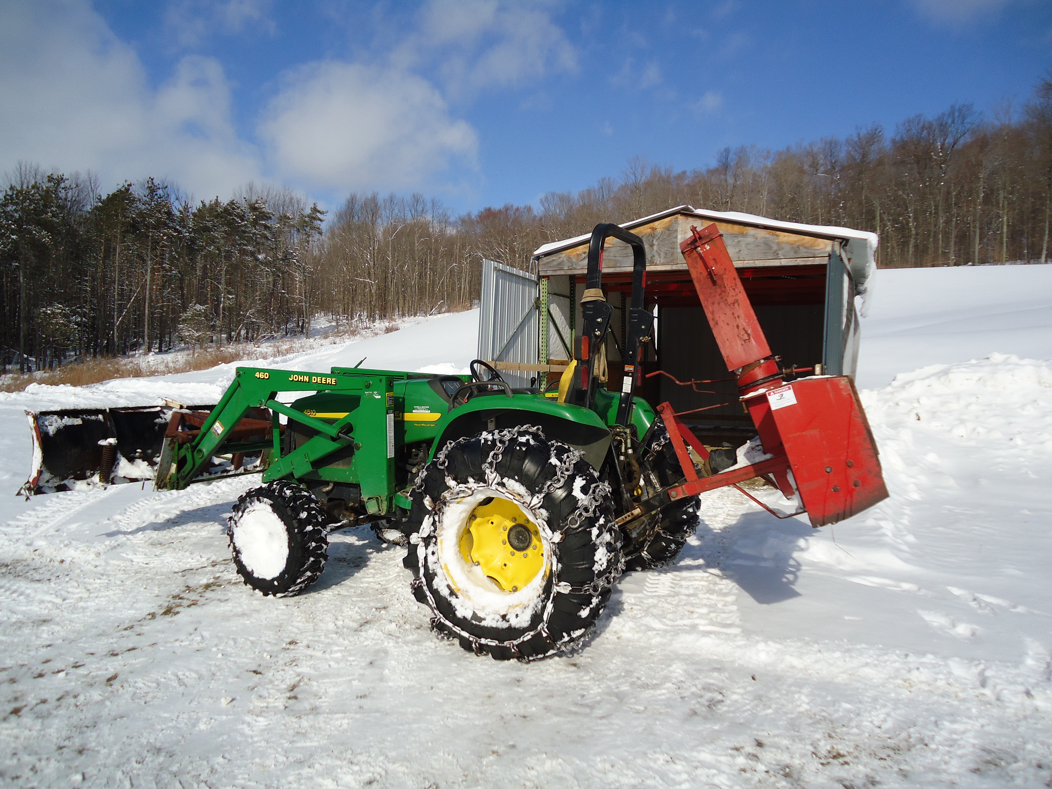

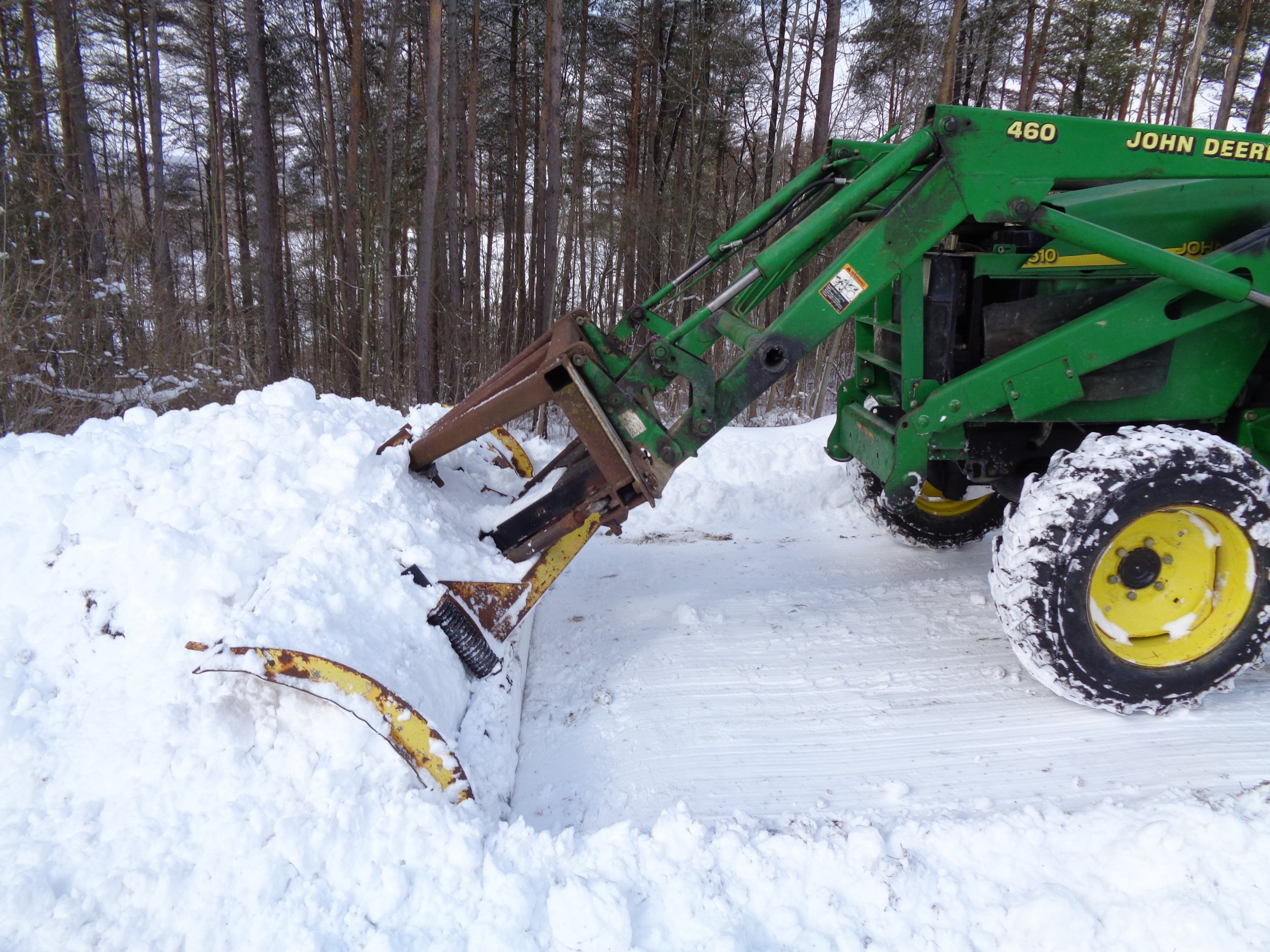

In my experience using a snowblower to clear a 600Ft double wide gravel driveway, the problems I found using a 6ft blower off my 3 PT 540 RPM on a gravel driveway, is that at night you get a meteor shower and defoliate any shrubs nearby. I found this to be true no matter how one adjusts the hitch height, tilt, whether the drive is froze, etc.. You get the added bonus of taking a 1/2 inch (13mm for the guy north of the border) of gravel off each year.

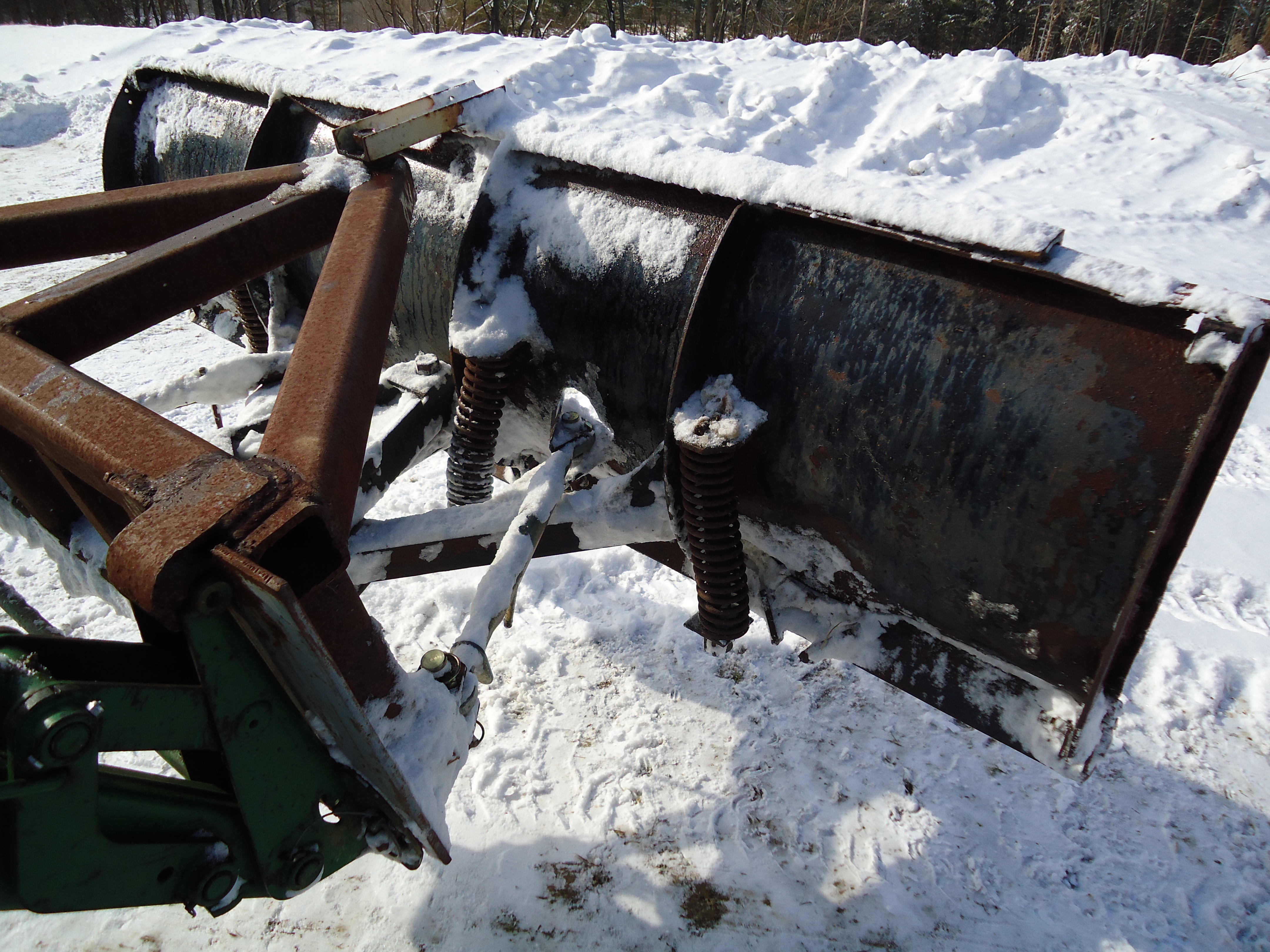

I ended up using an 8Ft. commercial Fisher Snowplow and frame from some guy selling one for $100 USD along side the road. Another $300USD gets you a new cutting edge, pivot pins, 2 snow shoes and a few of the trip springs with mounts. You can weld up your own trip spring compressor if you really think about it. I built a HD (3" x3/8") square tube adapter frame to mount the plow onto the JD quick attach of my JD4510 FEL. You will probably need to pickup one of the "universal" skid steer mount that Northern Hydraulics sells for $100, buy a heavy duty one if available. The Fisher uses a bottom trip, a must on a gravel driveway versus a Western which justs flop down every time you try to push heavy snow. The adapter frame allows the use of factory Fisher turn cylinders. I did need to fabricate a mount for the top of the blade to the frame adapter. This allows some form of rigidity and flex, so that when you inevitably get stuck in the roadside ditch pushing snow back, you can tilt the bucket and "push" yourself out. Trust me when I say this, using a FEL attached Western plow and frame in that way, will destroy plow and mount. The big thing here is you can get down pressure to scrape accumulated snow from vehicle tracks. That down pressure is not available with any front or rear snowblower, they either skate on shoes or 3PT top tilt. Oh and get a set of 2 link spacing or ring chains for the back, rubber tires don't do any good on the ice and snow, worth the $150 USD from ICE. Depending on the amount of clearance between the rear tire, the top fender and the tire to inside of the side of the fender, you may be able to go only with a "bar" style chains. The chains on the JD are double rings, I have 6 inches of clearance all around and work well in snow or out in the woods dragging whole trees down to be cut for firewood.
An 8Ft wide snow plow will probably be too heavy and require too much weight at the rear of your small tractor. You might find a Fisher that was on a Jeep or cut down a more commonly found 8 footer to fit the Mahindra, still needing weight or buy a rear 5FT 3PT PTO driven blower for the extra weight and utility. Six of one , half a dozen of another. If you do go with this setup, my JD has an "option" to "float" the tilt of the bucket. This bit of "give" allows the plow to follow the dips and rises in the driveway, keeps the blade from scalping. Not sure if you have this "float" option on the Mahindra. I would suggest NOT trying to mount the Fisher plow to the bucket of the Mahindra. You have to mount the Fisher too far down to clear the trips, causing a whole bunch of problems trying to keep the plowing geometry/force low enough to the ground.
You still will scrape gavel off of the driveway but most of it will be in spots that you can spread it back out onto the driveway once the snow melts. I plow the driveway into a convient spot and then if and when the piles get too big, especially at the bottom of the driveway at the roadway, I blow the snow piles back to allow trucks to see me and I them before I pull out.
I am looking to purchase a Kioti CS series 2510 for mowing the 1 1/2 acres of hilly front yard. This is about the same size as the Mahindra you were asking about using a blower on 1000Ft of driveway. Personally, I think bigger is better when plowing, especially doing 8ft versus 60" snowblower. I'm not sure if I would use something like that on a large driveway as yours. Your mileage will vary.
See attached pictures for the JD4510 front plow Setup
