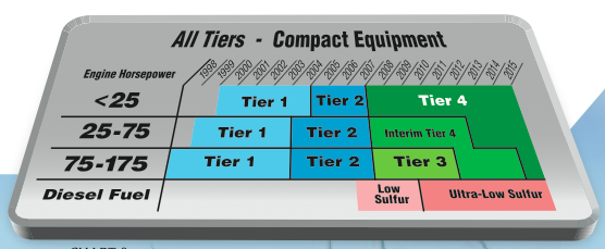

I don't think that machine was Tier 3 -- that only covered tractors over 75HP, from 2008-2011.

   / Mahindra Cold Weather Cranking Experiences #9
If I am reading the chart correctly, the deadline for 50hp tractors meeting the Tier 3 emission standard is 2008. The chart link is below.
Emission Standards: USA: Nonroad Diesel Engines
Here is the Tier chart that applies to your tractor:
attachment.php
A 2011 machine in your HP range would have been Tier 4 Interim.
attachment.php
Thanks for clearing up the confusion I had about the stages/years. I think it's gov't meddling in areas where there is not a significant problem.
