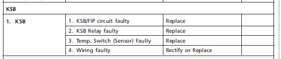

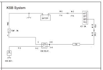

I have the Mahindra Owners/Service manual on CD. Was in my purchased folder.
I'm going to try to attach a couple of pictures.
From the Service manual on the CD
-ksb1 describes the function of the KSB system
-ksb2 is the troubleshooting guide
-ksb3 is a wiring diagram
I have replaced the KSB relay twice.
Looks like I need to check/replace the "KSB unit" and check/replace the "Temp switch"
The KSB unit is at/attached to the injector pump - I'll have to find the Temp switch.
If this doesn't solve the issue, I'll move on to the next tier of possibilities.
