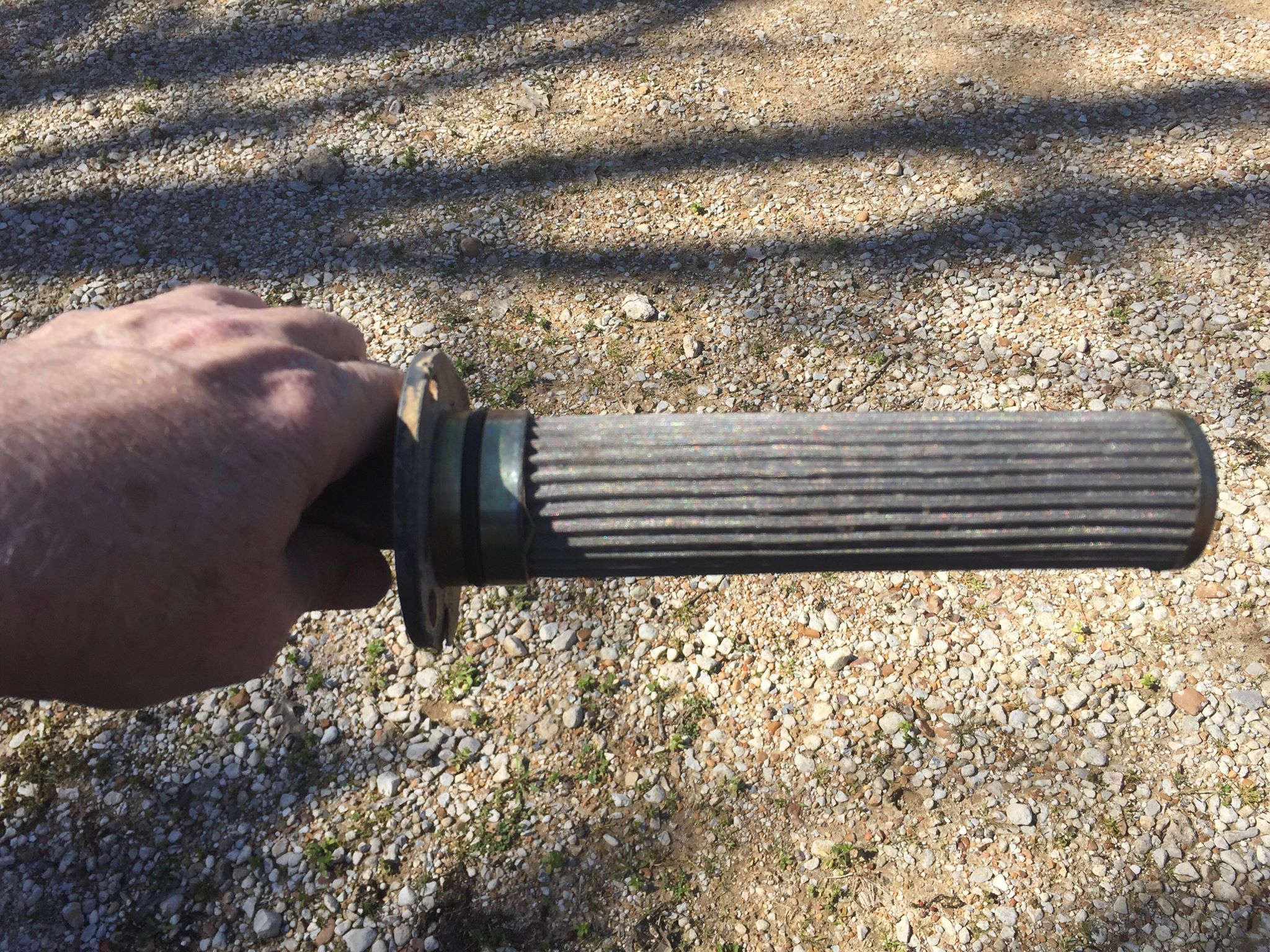

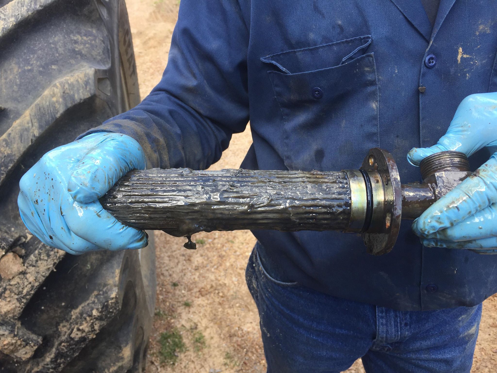

   / Mahindra 6530 (2wd non-shuttle) hydraulics have almost completely stopped working
I thought it might help someone down the line to see what fixed this.
It was the strainer in the bottom that was stopped up.
I took a couple of cleanings to get it back to 100% and stay that way.
It was the sump screen.
It just took more than one cleaning to get it back to 100%.
It looked like a dissolved paper towel was mixed in the sludge.
This was actually the first thing we checked, but it didn't' occur to me that it would stop right back up, so we were looking for a different issue, when we really just needed to clean it again.
