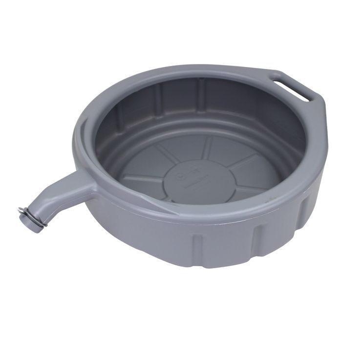

I have three HST tractors that contain up to 10 gallons of fluid to drain. My largest is tall enough to use two 5 gallon pails. But lately I have been using two 5 gallon oil drainage pans, bought on sale at Advance Auto.. but avail lots of places. I put a large piece of cardboard down, then situate the two pans in a handy position and have at it... Works OK even with my shorter clearance tractors...
I've had those for years; they are great, make it easy to dump into a waste drum, and if you are reusing the fluid after your repair, you can dump it right back in.
