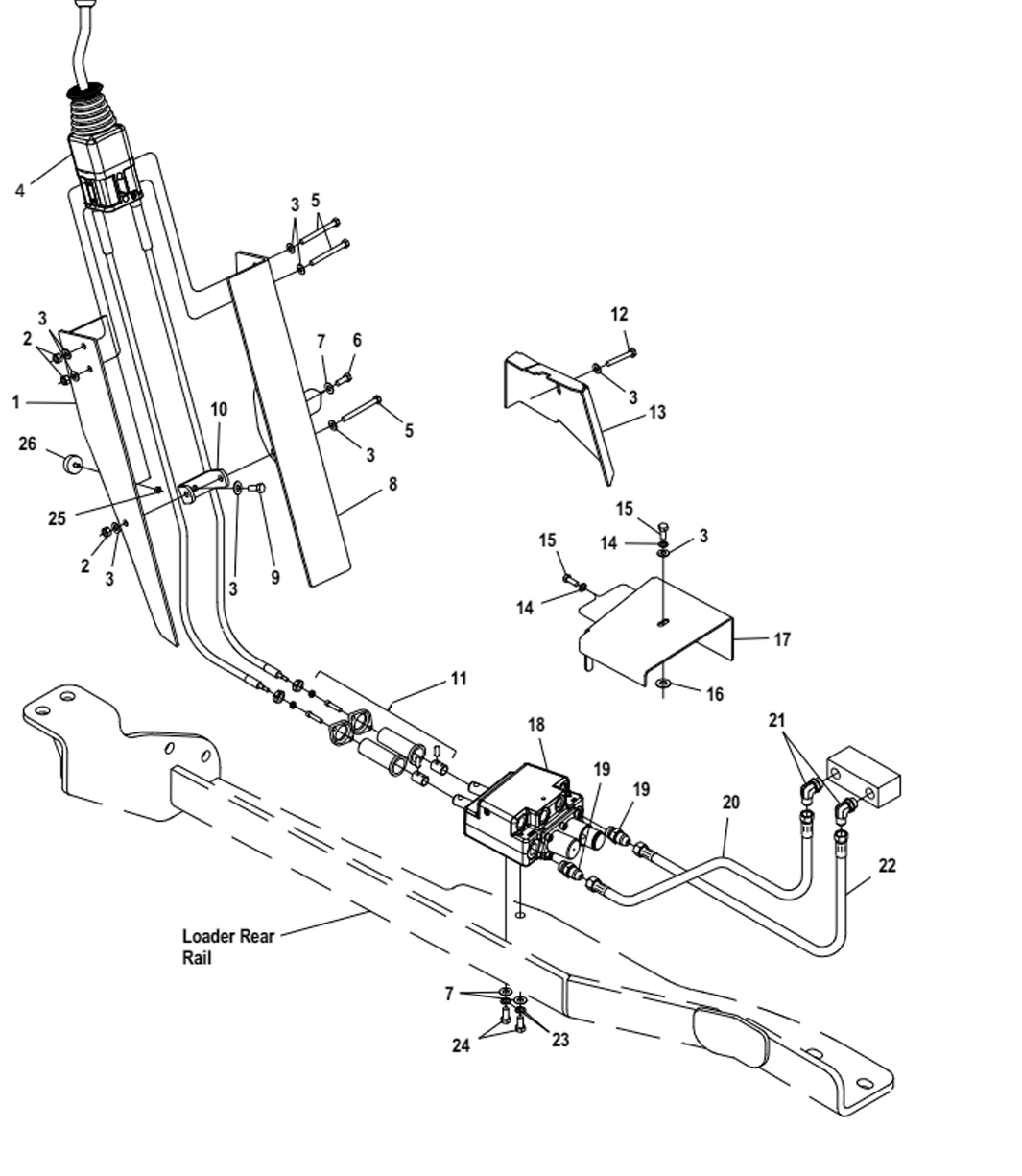

I was moving some logs with the grapple and i went to raise the FEL and nothing. All other functions work as normal but when i pull the control back to raise it doesn't raise and feel very limp.
I took the cover off of the controls and it looks like 2 cables going down under the tractor to the valve body???? Anyone had this issue? only 42 hours on this machine.
   / Mahindra 5145 FEL wont raise.
#2
The cable going to the cassette came unbolted. I went and got new bolts but if i tighten them so they will stay in it binds the cable. If i loosen them so it doesn't bind i am afraid they will fall out again.

Only 42 hrs since new, or 42 hrs since you added the loader? If it's new you should be crying warranty. Let the dealer sort it out, or you will be on the hook for it forever.
42 hours since new. I've had it 3 months. I talked to the dealer today and he will fix it. I had to get it to raise so I can load it on the trailer.
