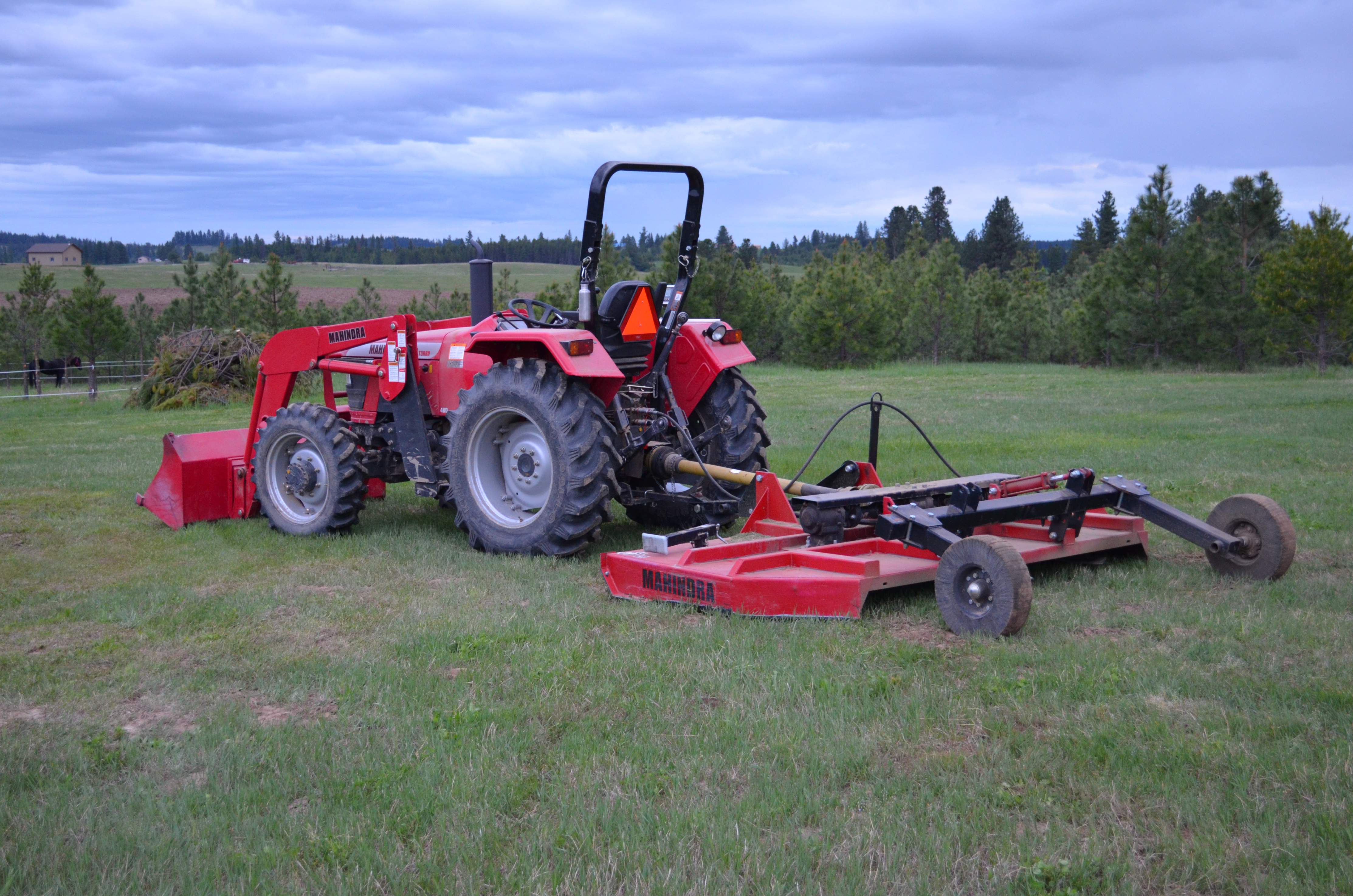

It takes less pto hp to pull a 10' pull type than a 3 pt hook up.
Idaho2
