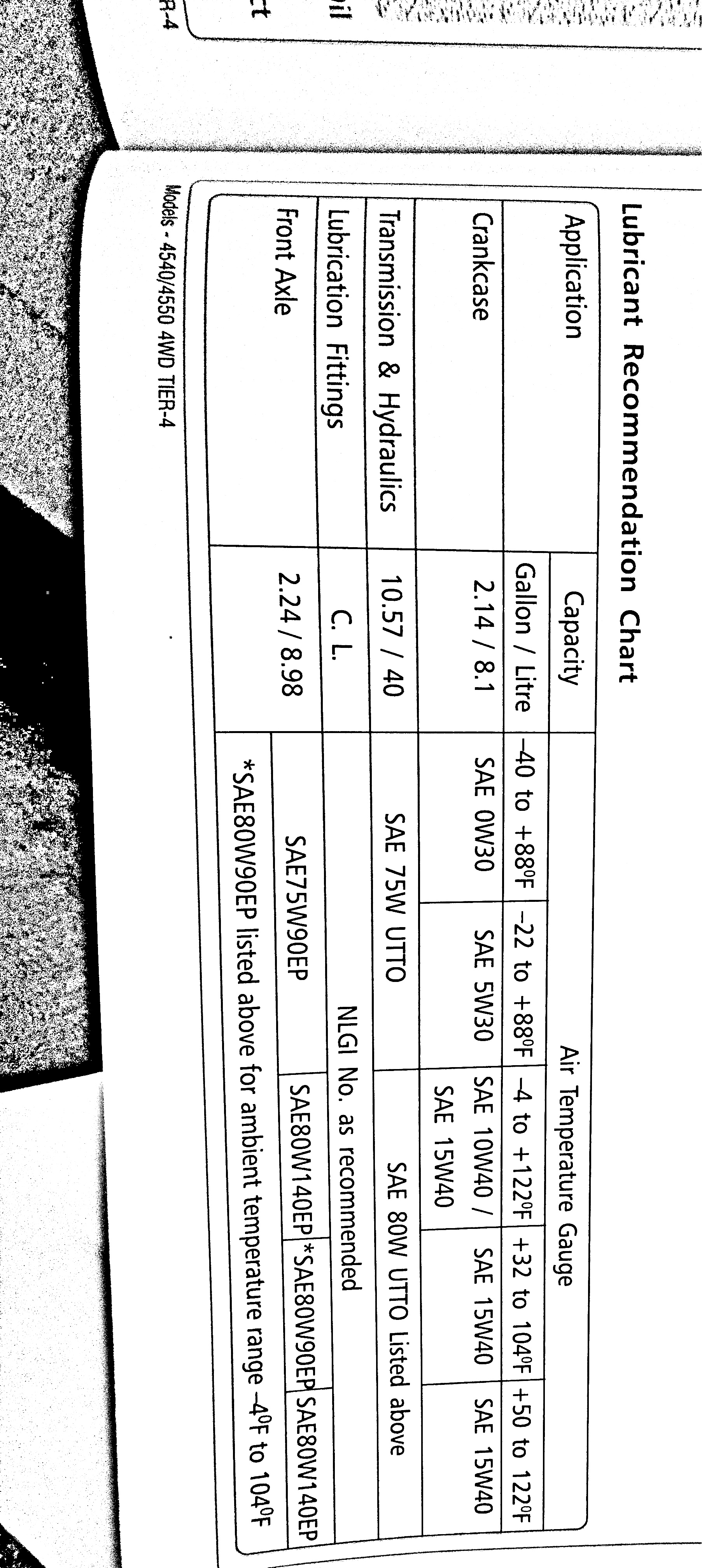

Mahindra 4540
I致e had some issues looking for several things that should pop up easy on internet search. So, I decided to starting a thread for others with a Mahindra 4540 looking.
Engine oil capacity 2.14 gal
Transmission/Hydraulic capacity 10.57
Comparison Universe Tractor Fluids
Mobil fluid 424
shell Donax TD
Tractelf BF 12 or C4- 1000
TSC brand Traveller universal
I知 using the Rotella HD from TSC, which I致e researched to find it comparable to others Mahindra list.
Cooling system capacity 2.25 gal
Depending on your climate here is a chart from the owner manual
