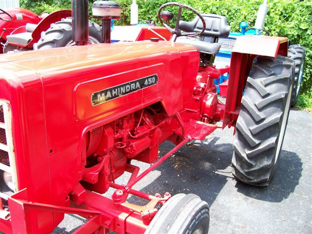

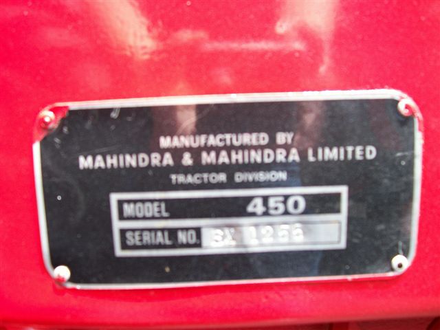

I recently purchased a Mahindra 450 2WD tractor. Where could I purchase filters (oil, gas, etc) and an operator’s manual from?
Further, could someone provide me with some specs on this tractor and possibly the year along with a readers digest explaination on what the two knobs do on either side of hydrualic plate situated beneath seat?
Serial # SX 1256.
Thank you so much for your time,
Kirk Veid
   / Mahindra 450 info #2
sorry nobody has replied, are you sure this is not a 4500, i have never herd of a 450, maybe one of the 0's got scratched off. if it is a 4500 let us know, they are some good tractors, i know i have one.
   / Mahindra 450 info
Thanks for your response. It is definitely a 450.
