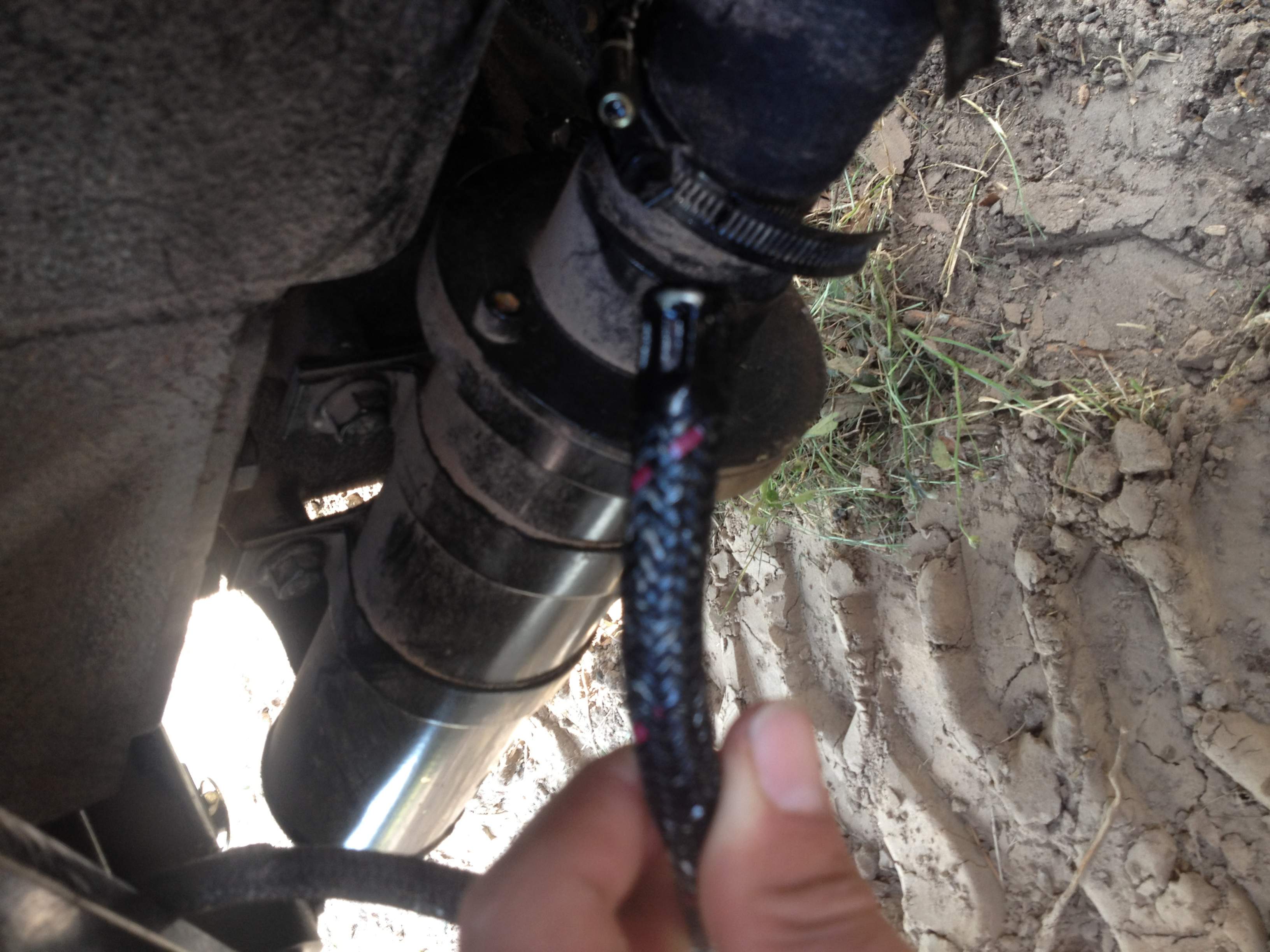

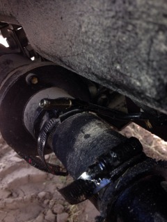

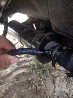

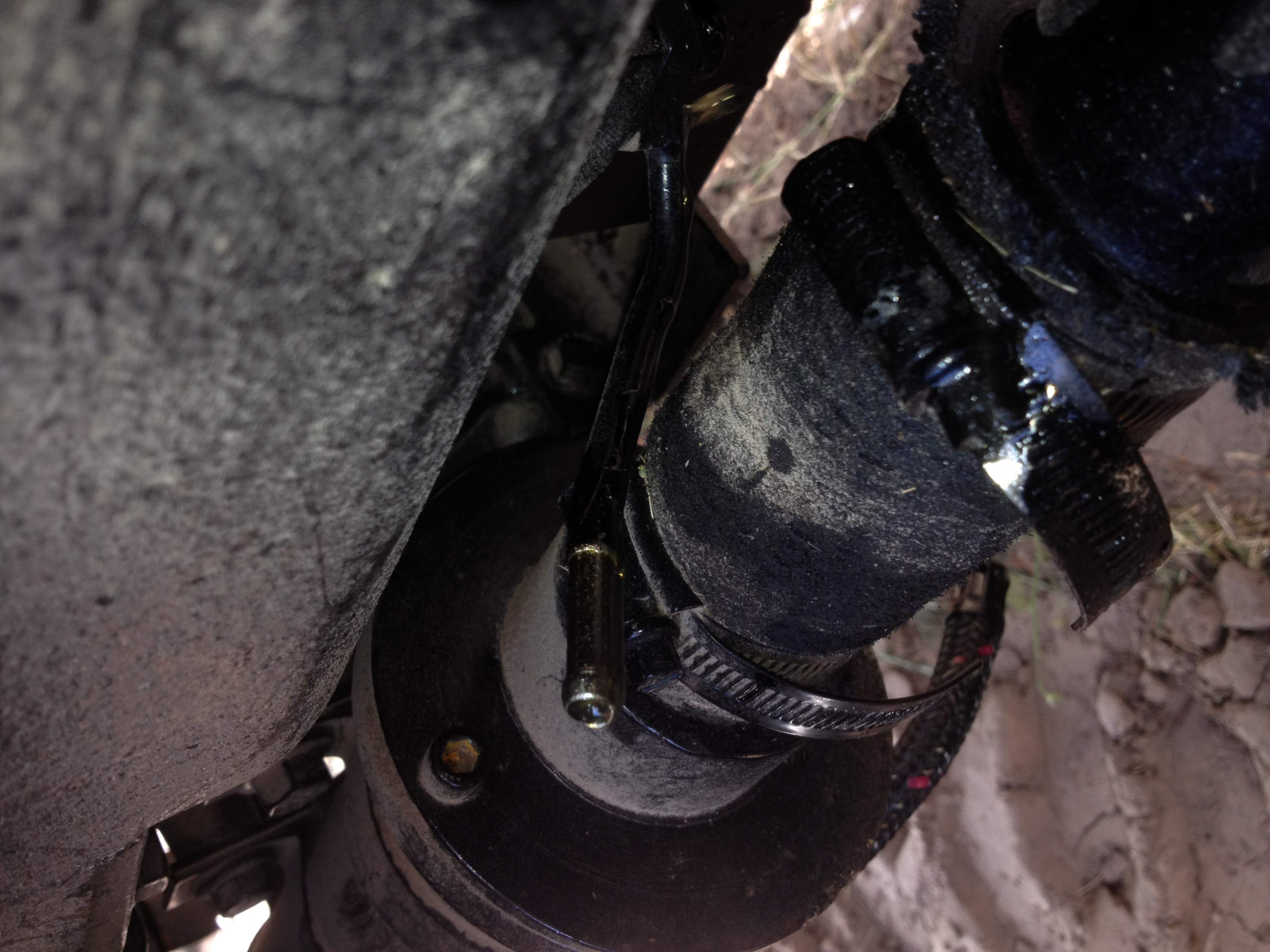

I cut a tree down yesterday and it fell the wrong direction... so now its across the driveway and I was cutting it up and dragging it into the pasture to burn it. The tree was over 5ft across at the base so this isnt a tree I could drag with the 4 wheeler and a couple weeks a go a kid fell asleep and hit my truck so its in the shop so I cant use it either...... My tractor blew a hydraulic hoser on the right side by the frame rail. Ive only messed with a couple hydraulic lines before on trucks at work and theyve all been threaded on the ends so I got no clue what kind this is. I called the dealership and they closed at noon and dont open till monday so Id like to find a way to get it fixed to get it out of my driveway. Heres a couple pictures, its kinda hard to see since its all been painted black.

I'm pretty sure its the return line going back to the pump...ie. very low pressure. My 6000 has pretty much the same thing on top of the trans going back up to the pump...also, you can't run high pressure with just a hose clamp...move your thread over to the Mahindra forum... there's a couple of really good dealers that can help you out there. BobG in VA
