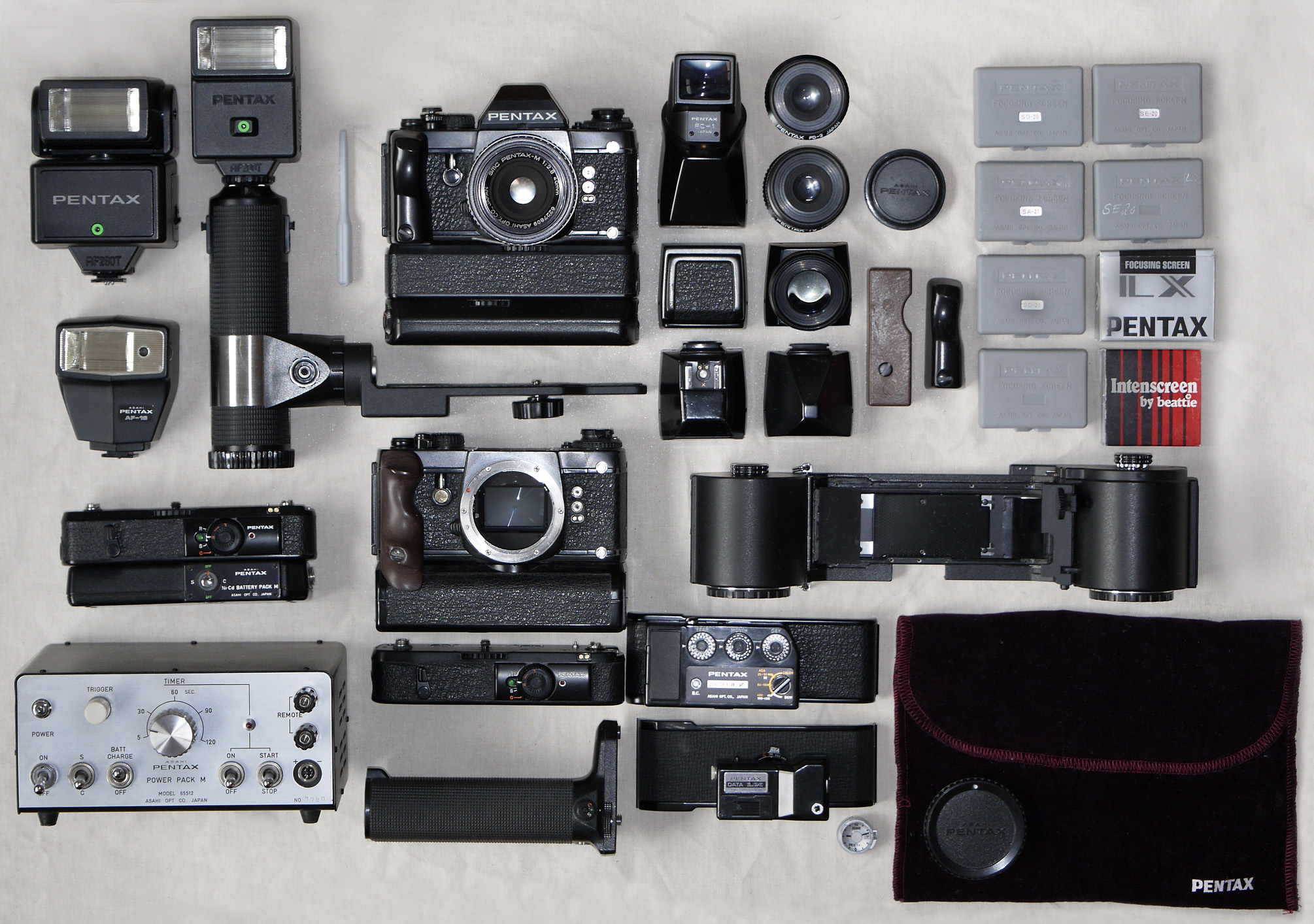

I was once into photography pretty seriously and shot a boat load of Kodachrome 64. I used to by that stuff and duping film by the brick. I even got to go through the Kodachrome processing lab in Palo Alto. Kodachrome had to be lab processed by one of the few labs that Kodak had scattered around the country. It was once the National Geographic standard. Then again I also have myself to blame for helping to bring film cameras to an end as my last gig in electronics was making camera chips and image sensors which made digital cameras and then cellphone cameras possible.
Anybody wanna screaming deal on some well cared for professional grade camera gear? LOL Pentax_LX_Accessories_01kln.jpg
I'd intended to do a bunch of printing in retirement but they took Cibachrome away too so I EBayed my enlarger a few years ago. I guess if I ever do anything with all the slides I have it'll have to be electronic on the computer. I have the scanner but like the guitar, I just haven't gotten around to it yet. The tractor and all the other projects are keeping me too busy. Maybe when I'm too old to move around anymore.
