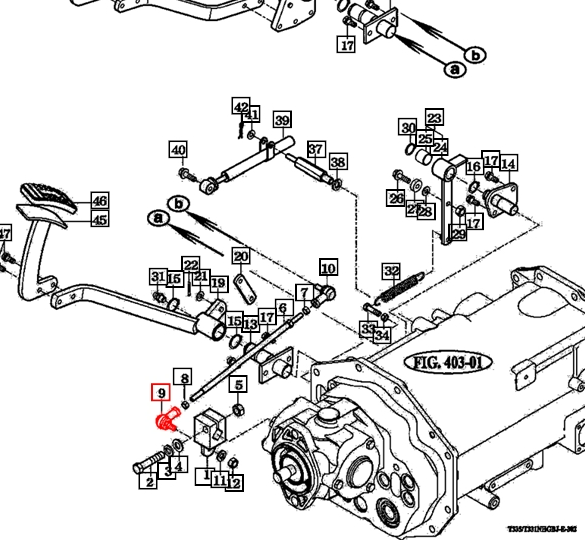

   / Mahindra 4010 HST no power when moving forward or backward
Hi all,
Update on the issue. I had a local tractor mechanic come and take a look as I wasn't able to see anything glaring me in the face. He climbed underneath and found the connecting rod from the pedal assembly had come unbolted and had lots of slop/play in it and wasn't engaging the actuator for the HST completely. The first image is of the elbow that had come loose. Tightened it up and forward and backward movement is like new again.

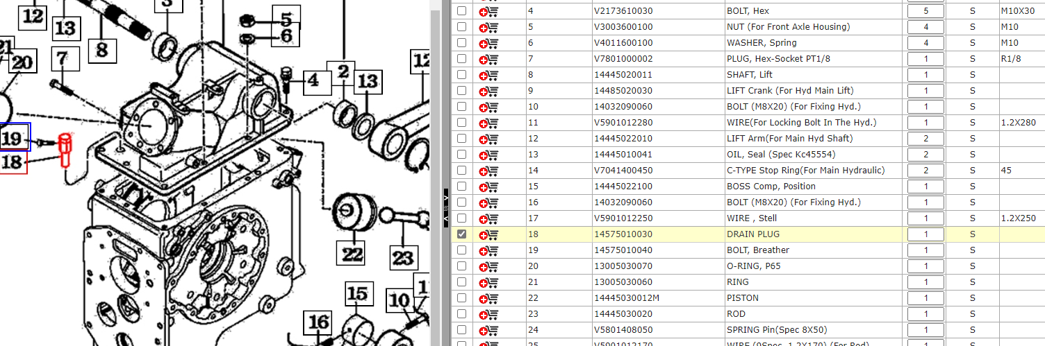

As for the leak. We found that there is a fitting on the top case where the lift cylinder is at that is noted as a drain plug with a breather screw. This was loose enough to unscrew using fingers. We tightened it up and fingers crossed that it is no longer leaking. Second image is of the "drain plug". Why would there be a drain plug on the top of the lift cylinder assembly?

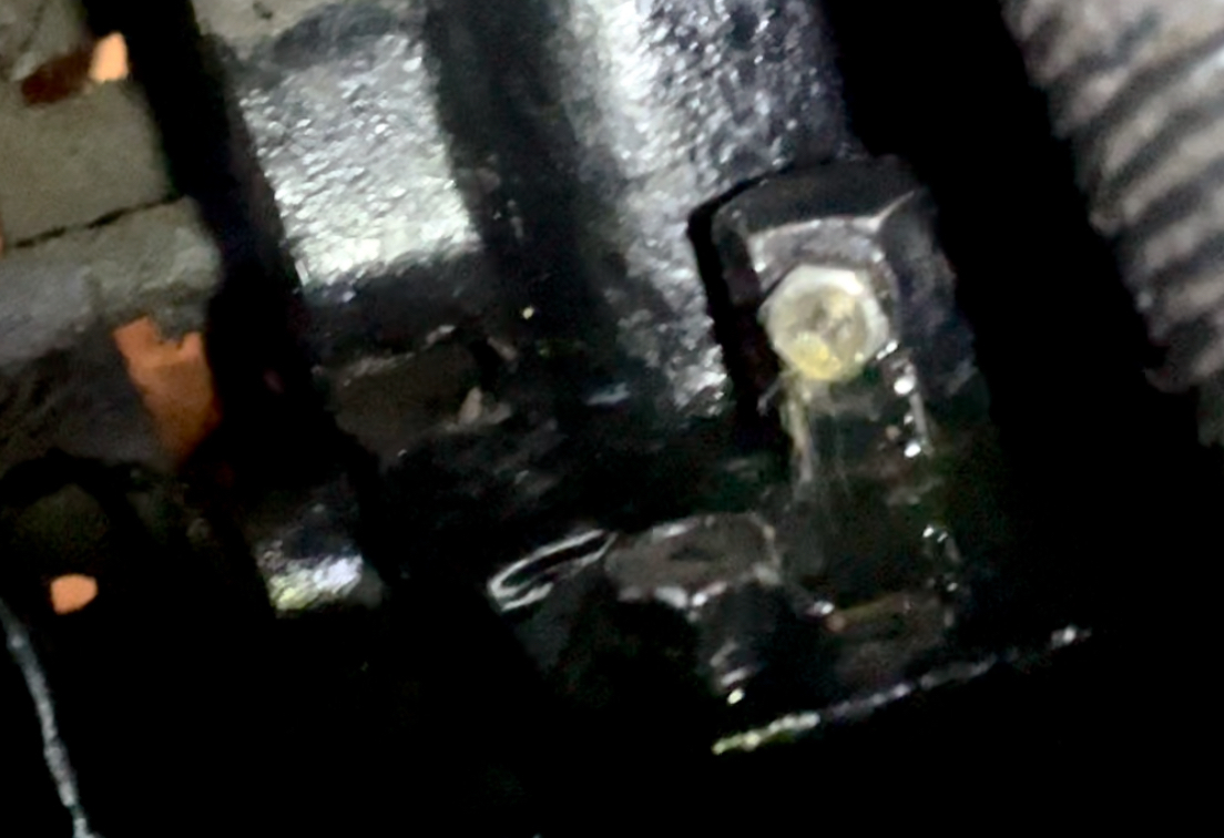

Found my leak. What is the purpose of this “drain plug”. The fluid is spitting out from the center of the screw.
I’d add video but not sure I can.
Try this
   / Mahindra 4010 HST no power when moving forward or backward #9
Looks like a breather plug. Is the reservoir overfilled?
