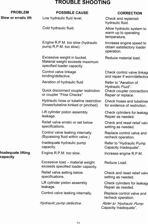

As I mentioned earlier in this post I was shoveling topsoil from the bucket by hand into some flower boxes for the wife. Had the bucket about 3' off the ground and by the time I filled the boxes, the bucket height was below my knees. When I finished I raised the bucket empty to 5', turned off the motor, and recorded the height every hour for the next 5 hrs. It dropped about 1 1/2" per hour. Thats when I looked in the loader manual troubleshooting section. I called the dealer and told him my results and symptoms. He said that 5" in 24 hrs. would be acceptable but not 7 1/2" in 5 hrs. He told me he knew of the problem and would order the heavy duty valve for me under my warr. He replaced mine when it came in. I'll try to attach the relevant troubleshooting pages for inadequate lift and loader drop.

Second page attached. Both symptoms indicate an internal leak in the control valve. Hope you can read them.
