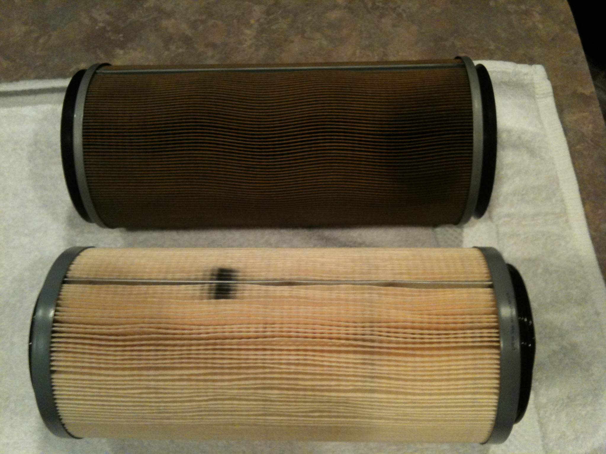

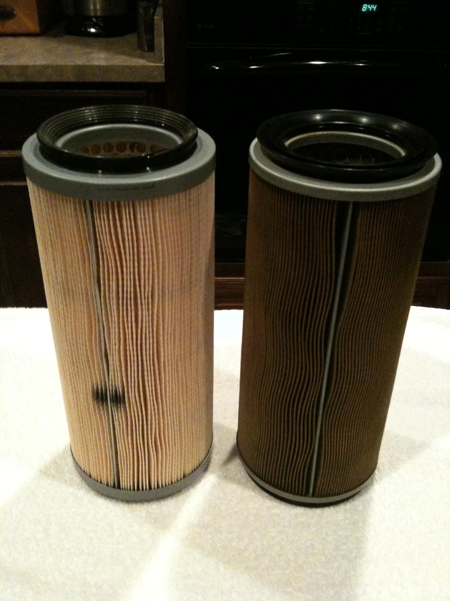

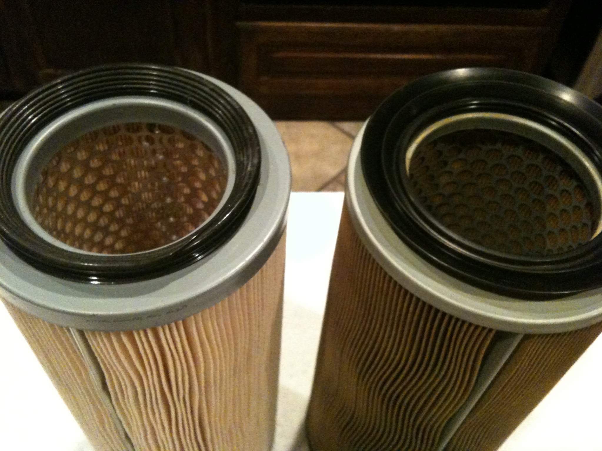

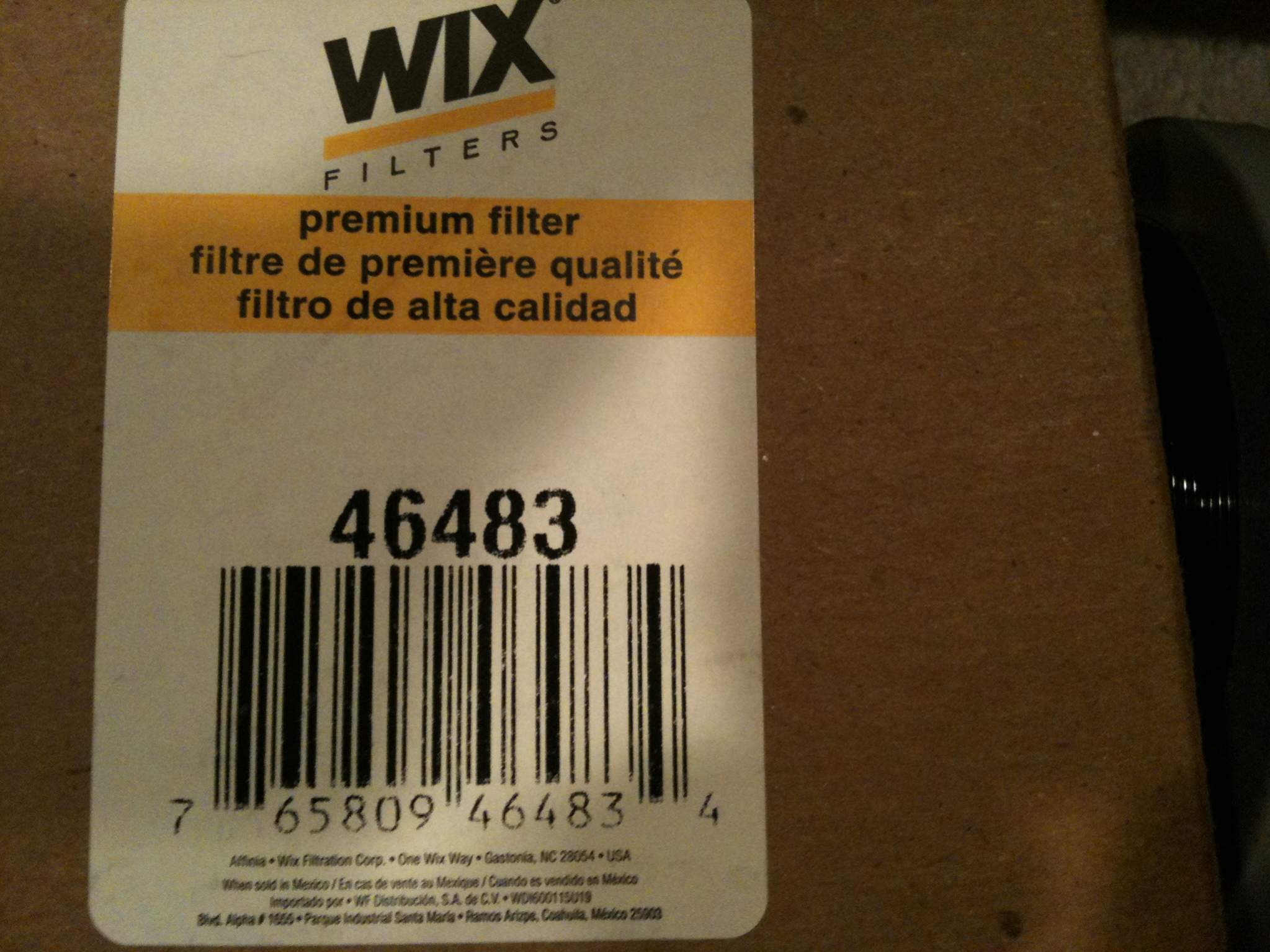

I searched and found references to a Wix air filter for the 2816 (Mine is Gear) and seems everything I found had the wrong cross reference part number for the wix. I can confirm that part # 46483 is correct. Got mine at O'Reilly's. Here are the pics to prove it. Installed and working :) ...and btw, cost was $31 , less than half price of other sources. Ordered 2 more from Amazon for $23 http://www.amazon.com/Wix-46483-Air-Filter-Pack/dp/B000CSIP9I

I found the same WIX filter for $20.27 at this supplier that I use. Froedge Machine & Supply Company, Inc..

It looks like the OEM filter has more filter media, like the pleats are tighter. It would be interesting to cut apart a wix and an OEM filter and stretch out the media and see if there is a difference, and how much. In dusty conditions, the bigger the filter the better. The second question would be if the media quality is the same. I know Wix makes good stuff, so probably so.
I know the OEM oil filter has quite a bit more filter area then a Wix, because we had one torn apart. We never tried the experiment on an air filter.
Let's say the OEM filter has 10 or 20% more filter area, and of course that is questionable at this point, but that would make the OEM filter a little more valuable in my book. It would still be hard to explain why the OEM filter is twice as much $$, but I suppose that is the norm that an aftermarket company is going to sell cheaper then OEM, or why bother buying non-oem.
It does look like the correct size.

I've kept the old one and when I replace the WIX I'll cut them both open and report back. It did fit fine when installing.

Good. I think if we can demonstrate to Mahindra/Mitsubishi that there is a truly equivalent filter for a third the price, we can ask for a price reduction. We have been successful a couple of times over the years. I bet we end up finding the OEM to have more filter area. Not three times more, but more. :thumbsup:
