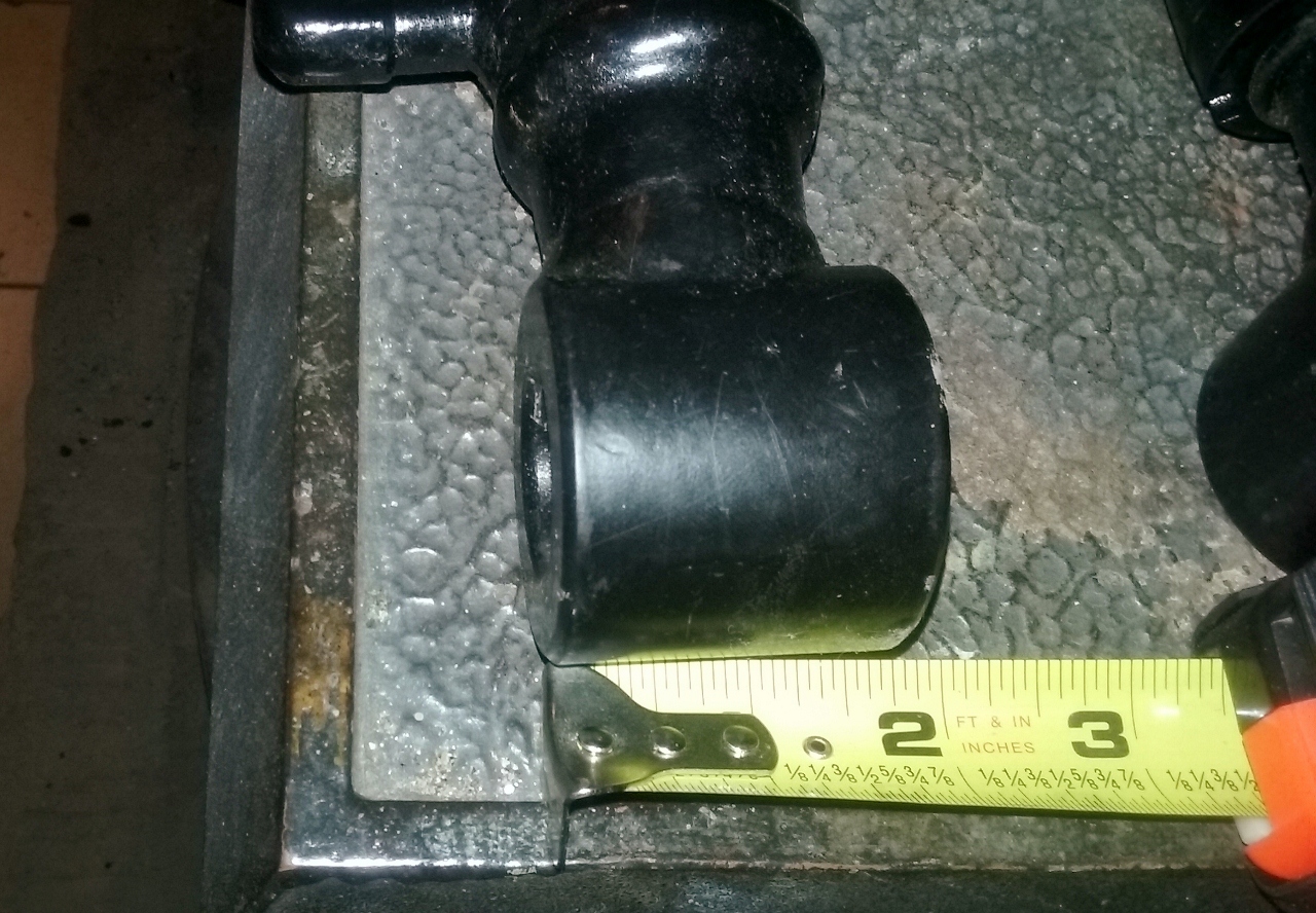

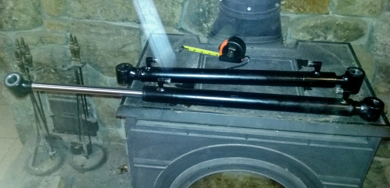

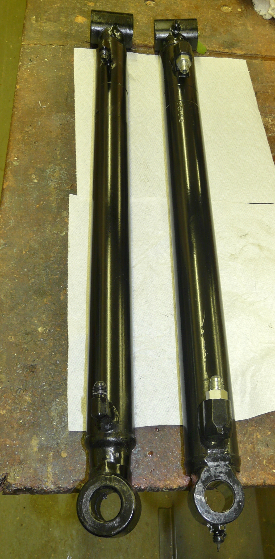

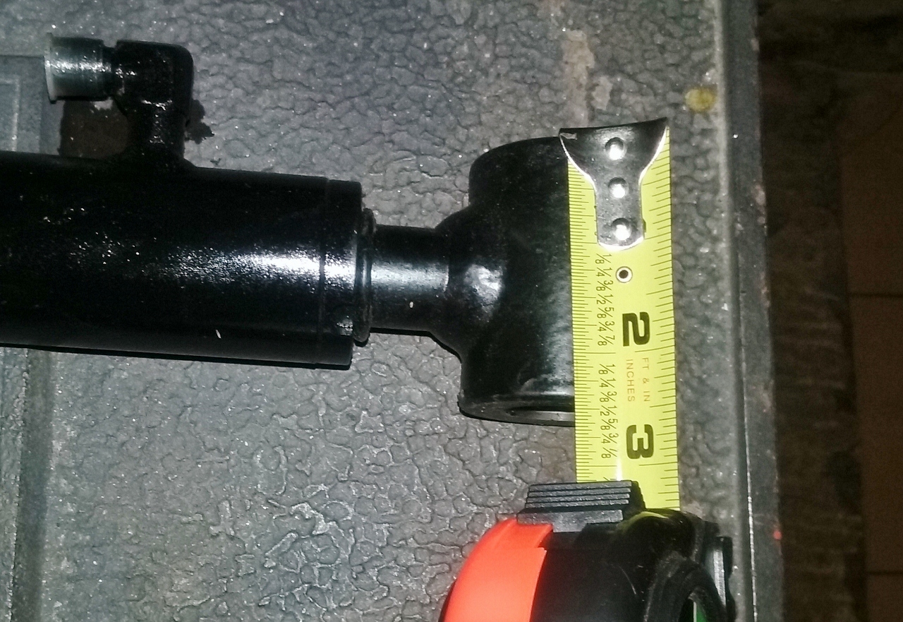

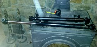

I bought both 1526 bucket cylinders that have 40 mm bores with a 453 mm stroke, (644mm retracted /1097mm extended pin center to pin center). These new nearly identical length bucket cylinders replaced the OEM ML205 loader bucket cylinders.
The 1526 bucket cylinders are Mahindra PN is KMW31502148 for $380. As I upgraded the Max 28 Bucket cylinders, they are now just sitting on a shelf in my lean to. PM me if you want these original Max 28/max26 OEM 35mm bore clyinders, 80 hours on them.
http://www.tractorbynet.com/forums/...loader-curl-possible-solution.html?highlight=
The first 4 photo's are of the Max cylinders I just photo'd.
See the last photo of original Max cylinder vs. 1526 Clyinder or the right. It does not look much bigger, but 40mm is a lot bigger than 35 mm.
