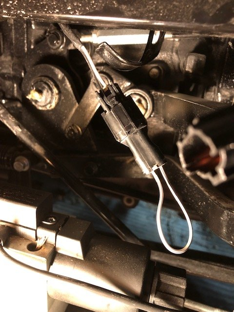

Mahindra 2638 HST
I have a Mahindra 2638 HST and purchased the cruise control kit. I have installed the dash switch and magnet... But I cannot locate the prewired factory plug to plug in the magnet? Must be hidden well. I did find one two wire plug with a loop connector but is measures 12v weather the switch is on or off..... Thanks

I think mine was tied up high and tight so it wouldn't get damaged by anything. If I can remember tomorrow I'll try and get a picture of what it looks like. The kit isn't hard to install at all, for me the hardest part was finding the right plug behind the dash and fishing it out where I could snap it onto the switch.

Mine is up behind the right side of the instrument panel.
