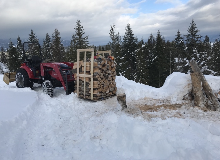

Hey folks, im contemplating on purchasing skid steer forks for my 2538 HST. wondering what the max weight can be lifted (lifting like 6" off the ground)? I have a backhoe on this model. I will be having a large shipment of pavers this summer, each pallet is 2800-3450#'s and id like to be able to move them. any input would be appreciated!

Are you talking about clamp on forks or a full fork lift attachment?
The clamp in forks are generally lighter weight, plus may bend the bucket. I have clamp ons for my tractor bucket and I think they have a 1,000 lb limit (each fork)
The skidsteer attachment forks are probably much stronger, and you are probably only limited by your skidsteer lifting limits
   / Mahindra 2538 HST max fork lift weight? #3
Lift to full height (at pin) 1634 lbs So maybe 1000lbs on a 48x48 pallet .The further out you go the less you lift

I have the 1538 and a set of SSQA forks. I think the lift is similar.
The lift cylinder angle actually makes the lift capacity worse when it’s close to the ground. I don’t think you will be lifting those pallets- or even coming coming close. I’d say the post above is about right- #1000
I can lift granite rocks about 24-30” square with chains and the bucket 4’ in the air.
Here is a photo of about the max I can lift. It’s larch and cedar. Adjustments.jpg
