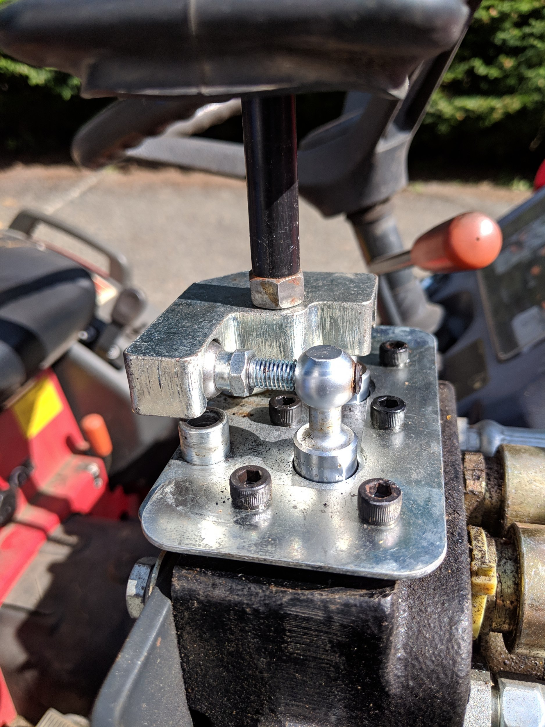

So I figured out the problem yesterday. What essentially was happening was that one of the ball joints was loose, and causing binding. It wasn't really obvious until I took it apart and put it back together. In the pic (which is not my tractor but looks the same) you can see the threaded piece. It must have slowly come loose. So once I tightened it properly (including the allan key screw that is supposed to hold it from loosening), everything worked well.
Thanks for all the help.

You might want to invest in some Loctite 242 ( medium) thread lock so it does happen again.
