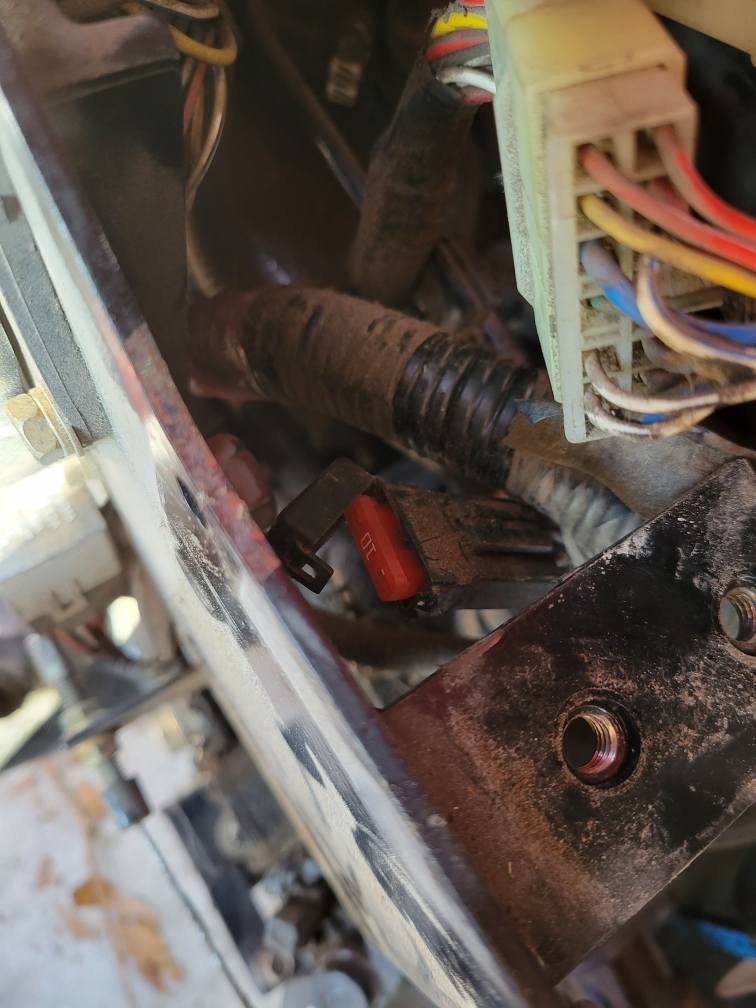

22 emax and a rk37
need help finding a good electrical dwg for my tractor.
or if there is a relay that provides the 12 v need to move the fuel solenoid. it has the lower voltage to hold the solenoid once unit is started.
we have checked all the fuses we can find. and even the hidden 10 amp
the tractor turns over fast. i have fuel to the filter but not to the injector. if I let it sit over night it will start and run for about 10 sec til it is out of fuel.
my solenoid has 5 wires going to it. like previously stated it has the lower voltage to hold it open but not the higher voltage to open the solenoid
when i trace the wires back they appear to go into the woodward APECS. is there some place that works on the APECS if that is where my problem lies.

only recommendation i have gotten is to check the three remaining wires for continuity.
still looking for a place to get the APECS checked out.
   / mahindra 22 emax 2015 fuel solenoid not getting power
those wires were good. found a relay that mounted next to the ecu that just appeared to be bent but in actuality the plastic was cracked and the relay went to ground. replaced relay from a local tym dealer for half the price as Mahindra and running like a champ again
