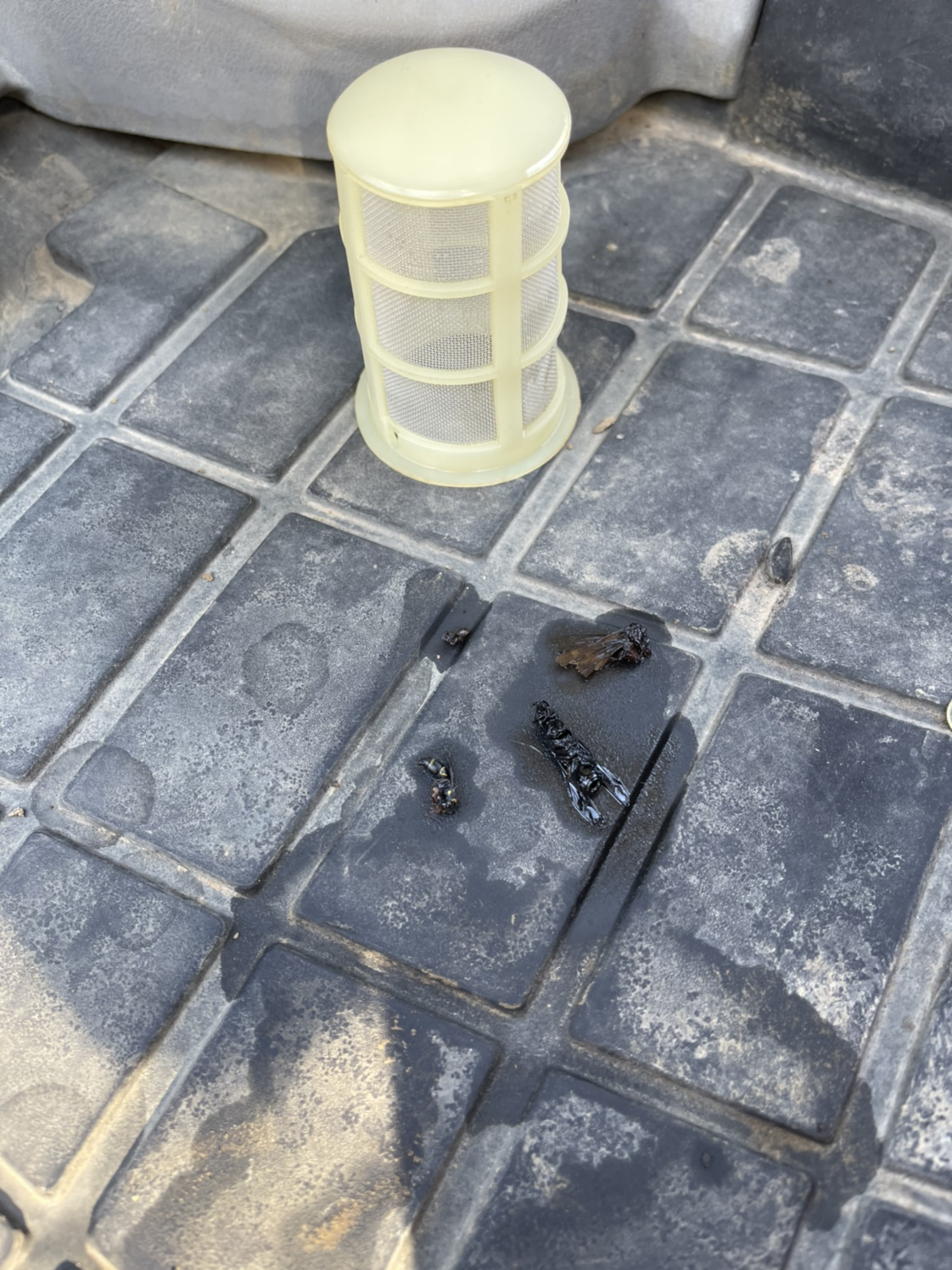

I let mine drain out over night (dribble at a time), then used a Rigid inspection camera (Under 100 bucks at Home Depot) to look at the bottom inside. Small bug was obstructing the fuel outlet, got it with a pair of 'grabber' tongs.
After the 2nd time, I fixed the problem with one of these inserted in the fuel outlet:

When gas level decreases to 1/4 or so, gas will reduce output flow to a dribble. If air is blown backwards into tank, regular flow is restored. I just read another 1526 owner had the identical problem I have. The parts diagram for this tank shows a screen filter in the fill neck. Mine is missing or has been pushed into the tank as the other gentleman discovered when he took the shroud and dash off to get to the top of the tank to remove the sending unit. He discovered a wasp in the bottom of the tank as well as the screen filter that should be at the top of the fill tube under the cap. If TnAndy has a 1526 and a camera can come in from the fill, I may try that. The fill has a right angle that my be hard to navigate a camera or snag tool past. Otherwise I will be pressed to duplicate the method that the other 1526 owner did to get inside the tank.

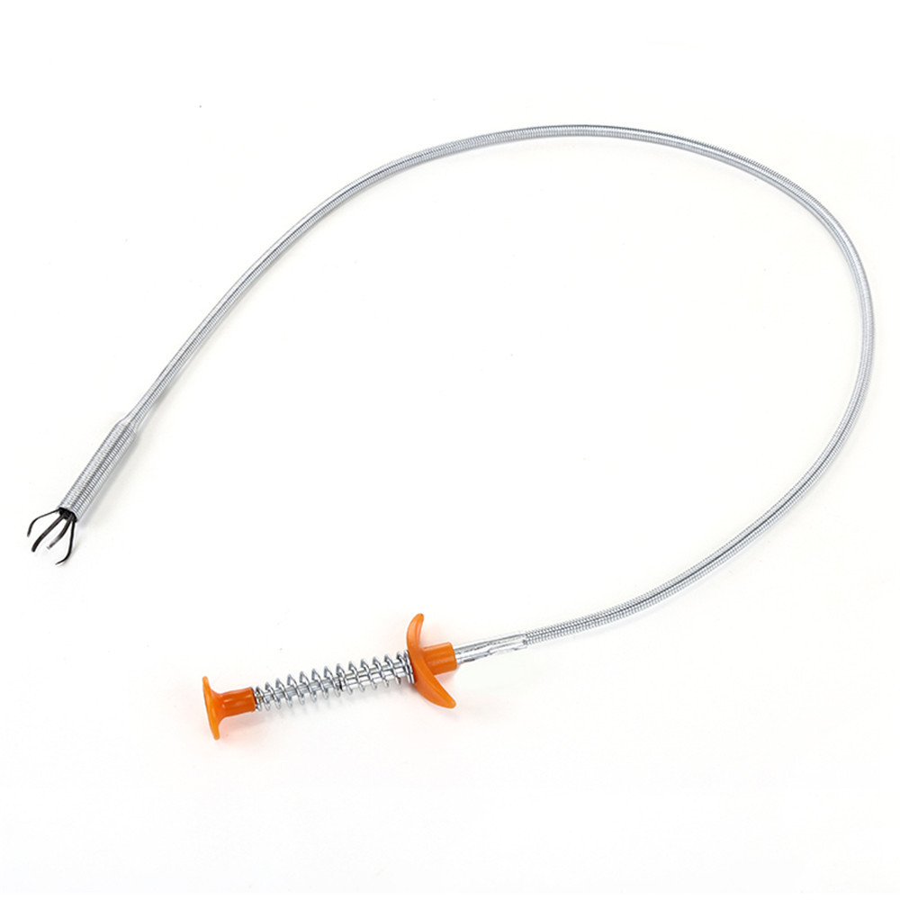

We had an almost brand new Vermeer trencher will an obstruction in the fuel tank. Our mechanic disconnected the fuel line right before the filter, pinched off the return line, then used compressed air to blow whatever was in the tank out with the tank still full of fuel. He did all this while smoking a cigarette!
   / Mahindra 1526 clogged fuel tank
LOL, I was going to get an unvented gas cap and drill a hole for a Schrader valve, pressurize and watch it split the seams
