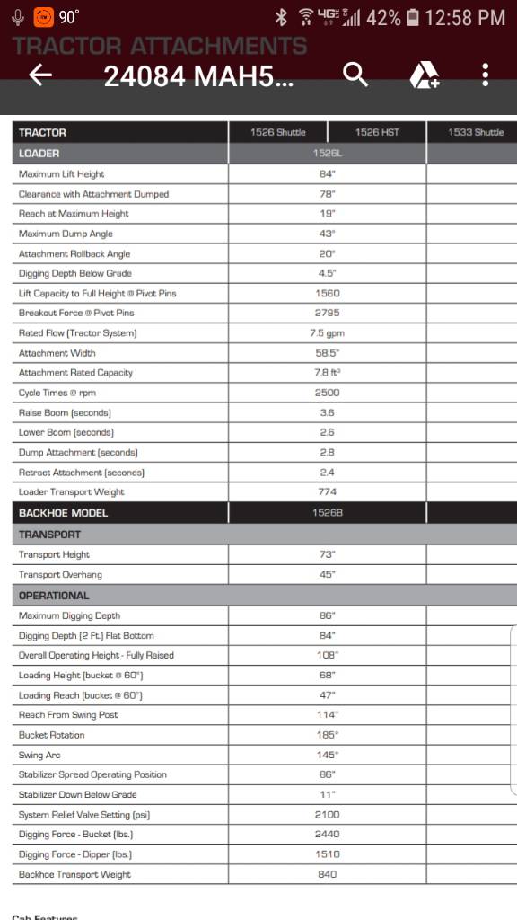

Does anybody know the Bucket volume of the stock Mahindra 1526 bucket? I'm looking to get concrete delivered, but i'll need to bucket the concrete from the street to the project location. I'm wondering how many trips it will take and how heavy the bucket filled with concrete would be.

7.8 cubic feet or 0.288889 cubic yards according to the Mahindra attachments catalog.
   / Mahindra 1526 Bucket volume? #3
According to your specs you have a bucket that can support 7.8 cubic feet calculate that to square yards. A truck will be able to bring 8 to 9 cubic yards at a time. If you can at all make it able to back up to the project area it would be in your best interest. Companies that deliver like to just go to a site drop the load and go as fast as they can. Just an FYI. Screenshot_20190910-125812_Drive.jpg

I'm looking for 5 yards of concrete, so rounded down to .25 yards per bucket it will be 20 trips at 1,000 lbs per bucket load. If the truck is willing to back across my yard and dump direct even better, but the bucket is sure better than wheel barrow's!
