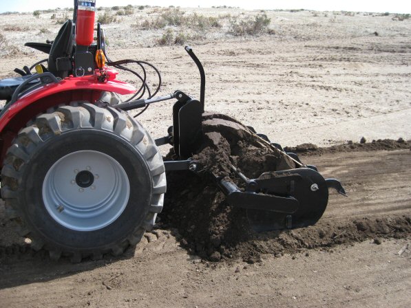

This 65" roll over box blade (ROBB) is what I consider to be the perfect box blade for your tractor. Good width, good weight, good versatility. :thumbsup:
