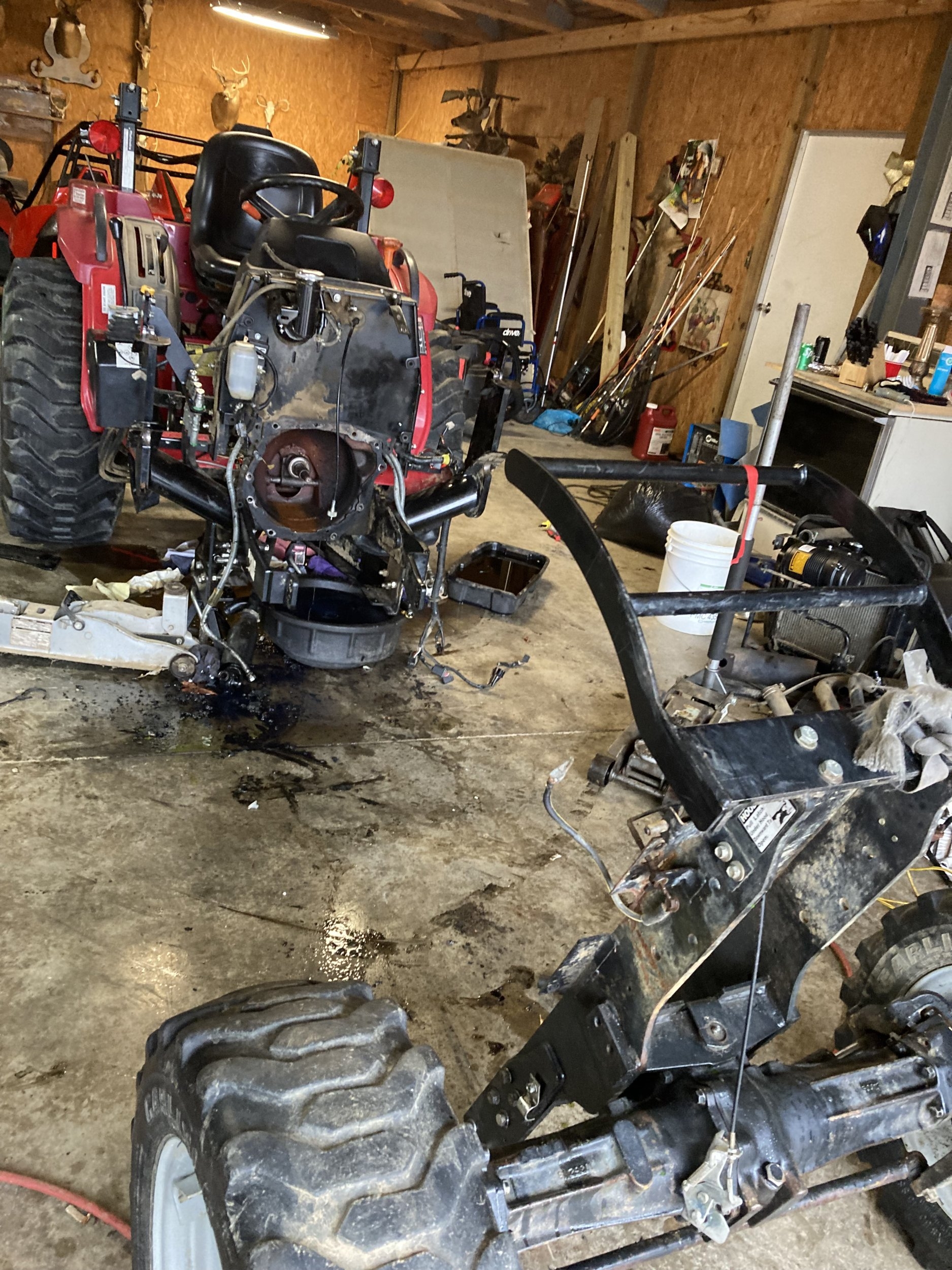

I am look for a motor for my Mahendra 3016
3 cylinder, 28hp, 1.3L, Mitsubishi.
The motor is locked up.
Thanks for any information.

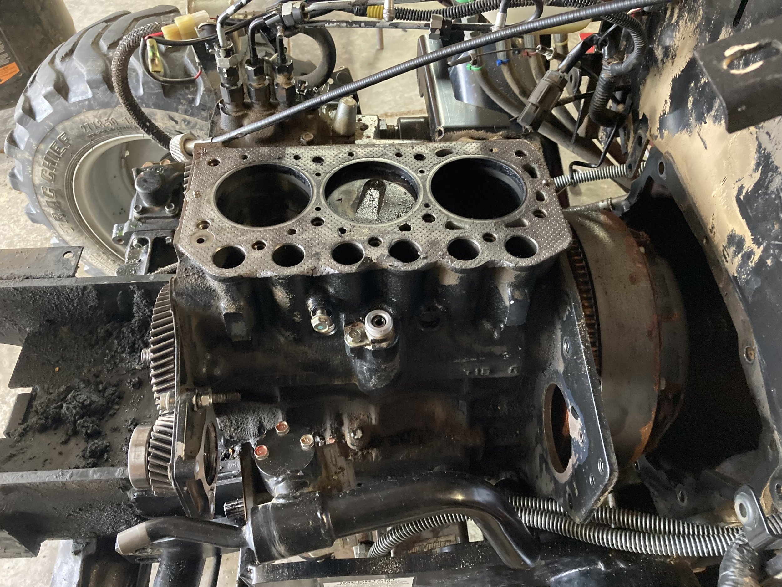

Just started to tear it down...
The valves in the first cylinder one open, one closed. The second cylinder both valves are open. Third cylinder one open, one closed.
I am not sure if both valves on the second cylinder should be open.
The motor is not at top dead center. (its locked up)
Taking stuff off to eventually pull the motor out.
Thanks for any info..

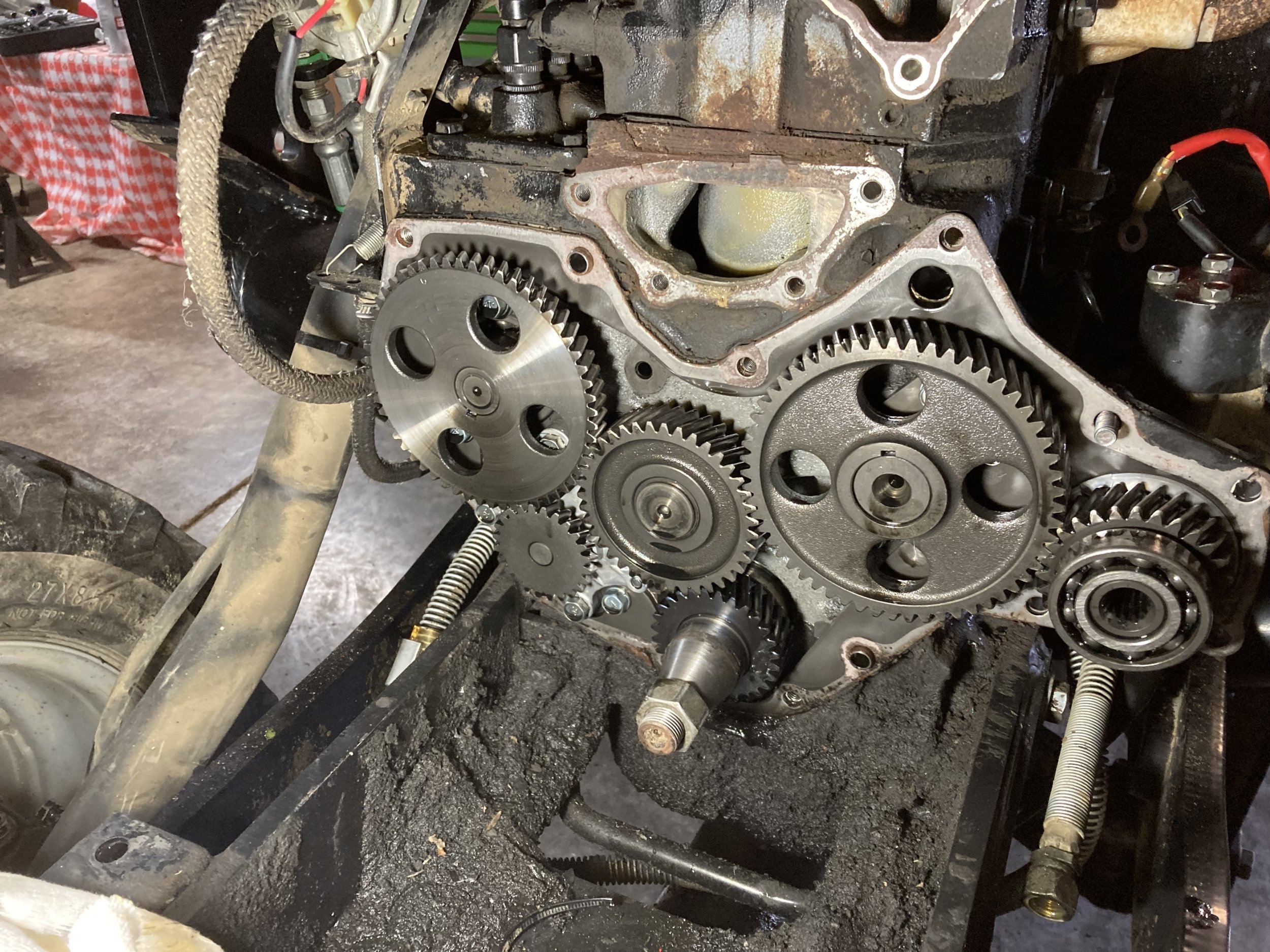

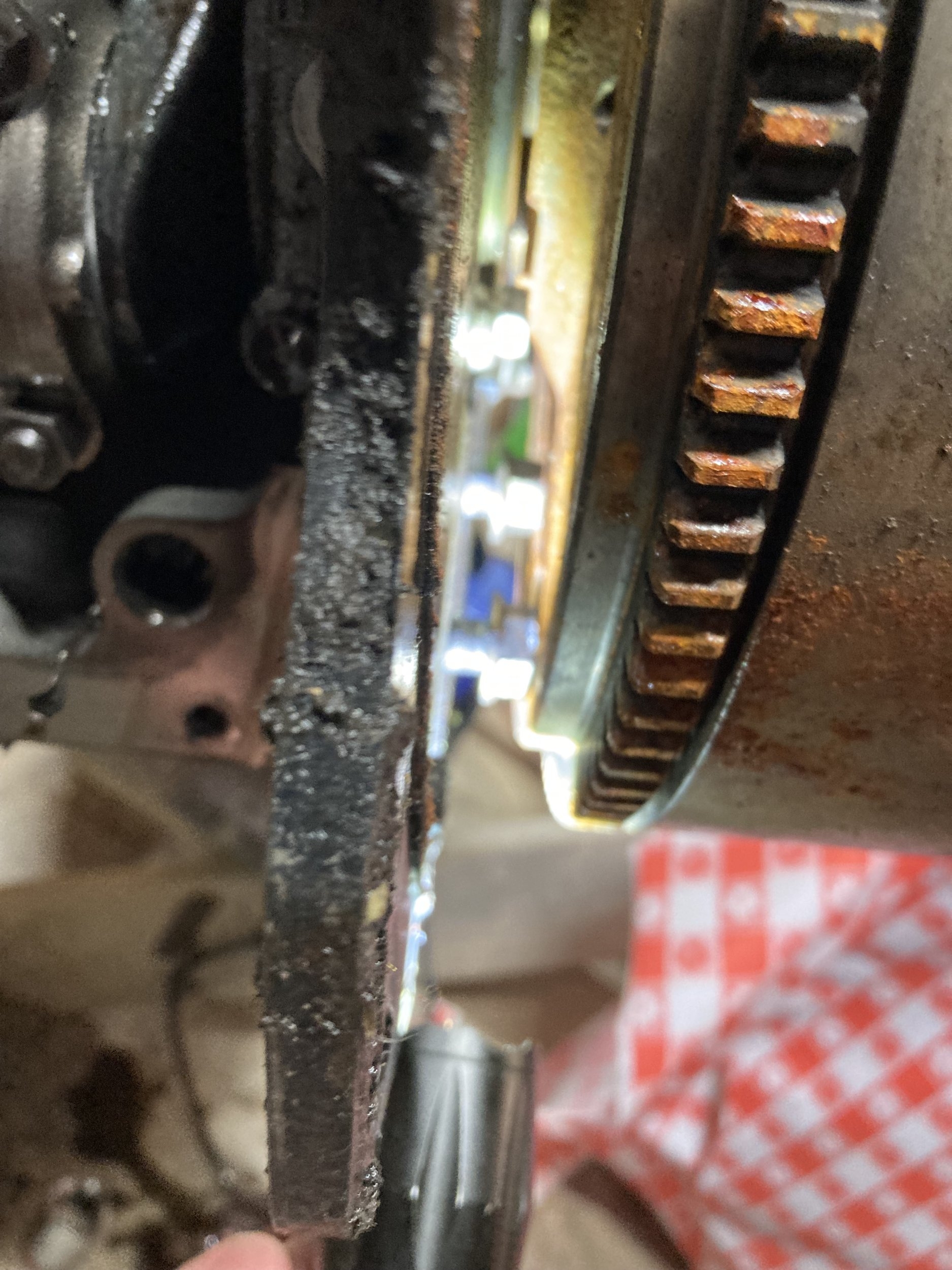

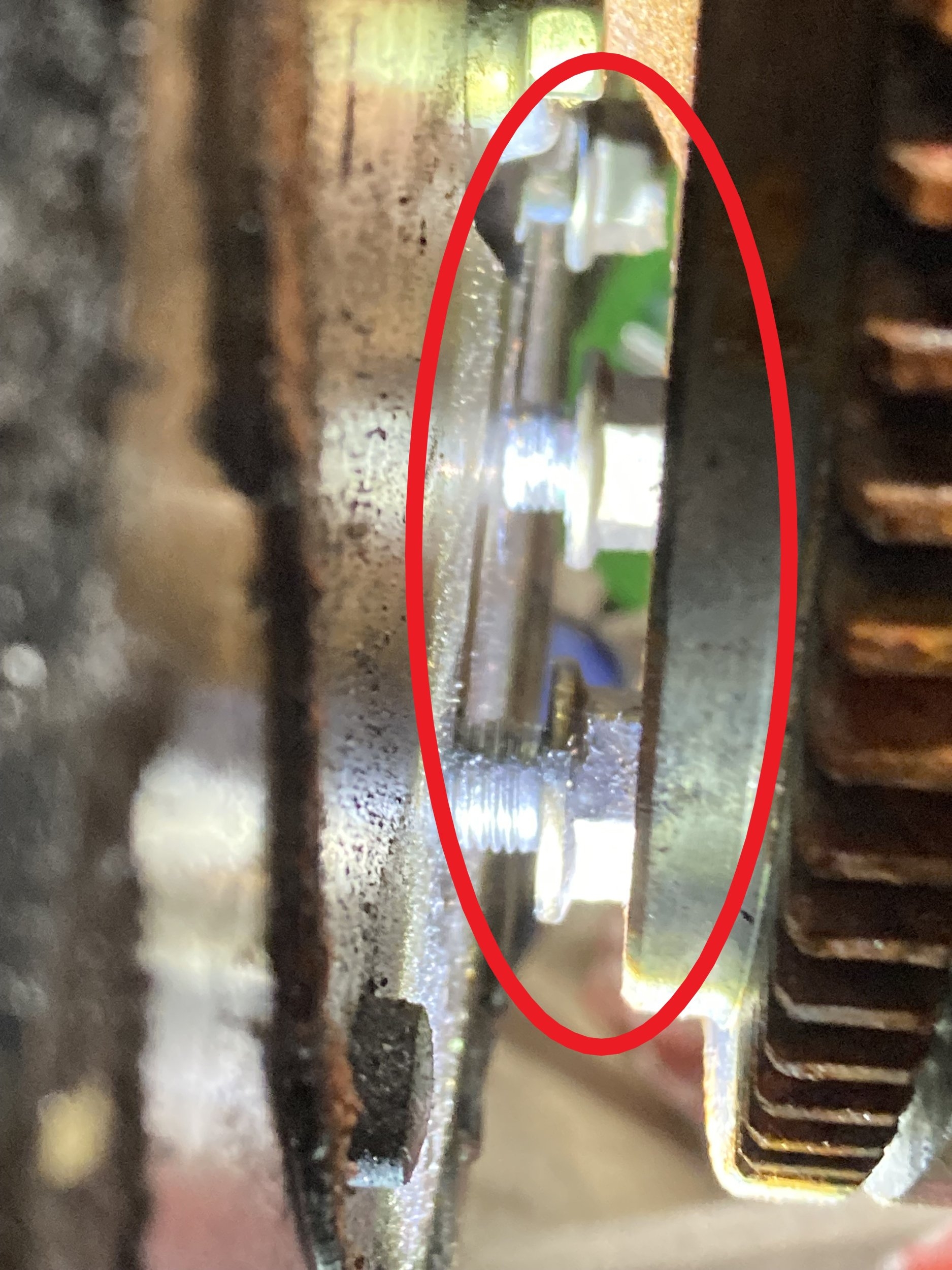

   / Mahendra 3016
#9
UPDATE
3 Flywheel bolts backed out into the clutch plate and would not let the motor turn.
Screwed the bolts back in and now the motor turns with a wrench. (will sent pic's later.)
I am wondering how to get the motor back in time.
Everything was fine until the only gear with no key way fell out. everything else is in the same position.
