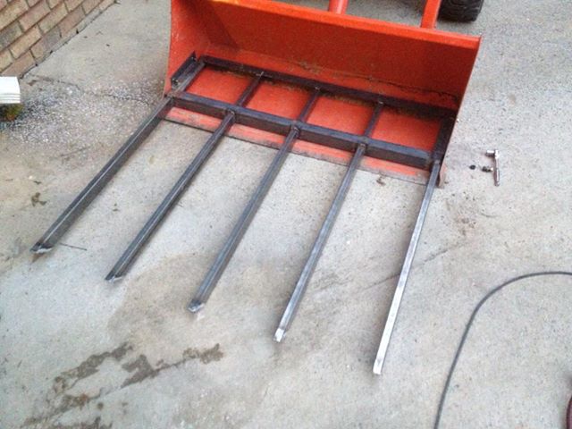

I emailed Bro-tek to get a price on their brush forks to find out they don't make them anymore. So I decided to take things into my own hands and make my own. I'll post some better pics tomorrow after I get them painted.

1" x 2" rectangular tubing.

Looks good!
Also, :welcome: to the forum.

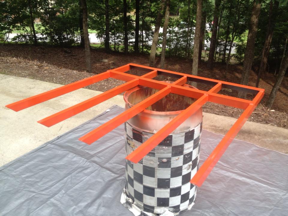

Got some paint on it. Too bad I gotta go out of town and won't be able to try it till next week.

The brush forks look good. I am making a set out of 1.5x3" rectangular tubing. I have it all cut but have not had time to weld it. It will hang from my bucket lip and be secured beneath the bucket. I have a set of heavy duty forks for heavy duty work but the brush keeps falling between the tines so the brush forks will solve that problem. Both sets will work with a grapple that I will build later.
Give us an update when you get to try it out.

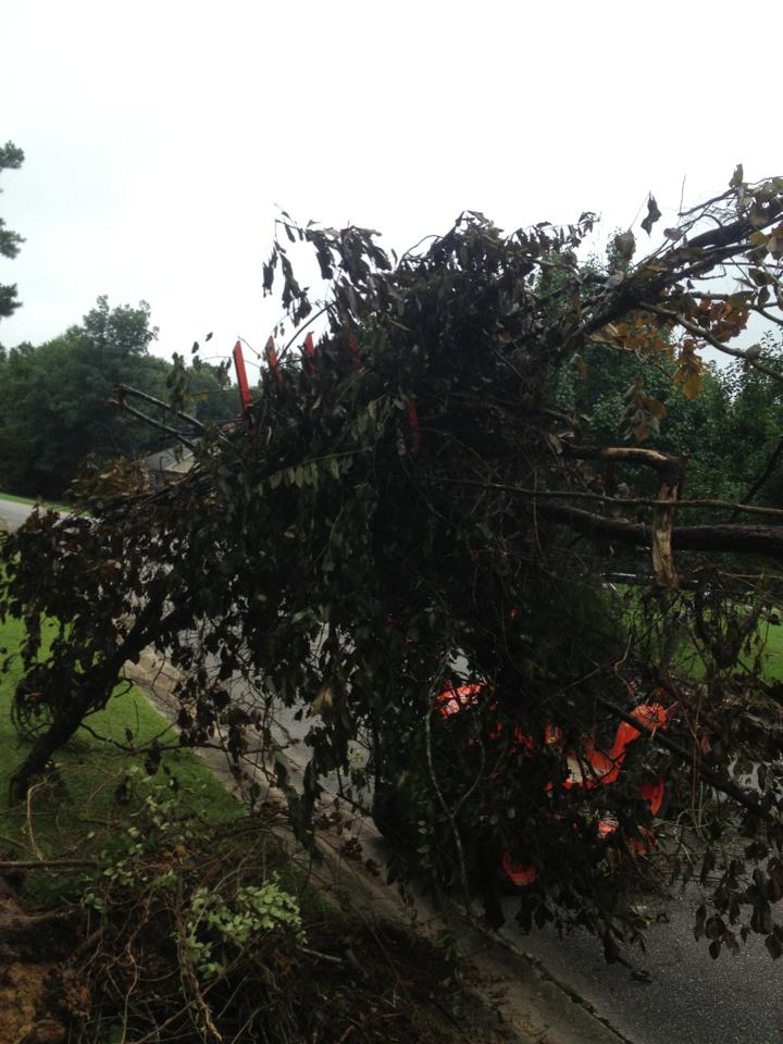

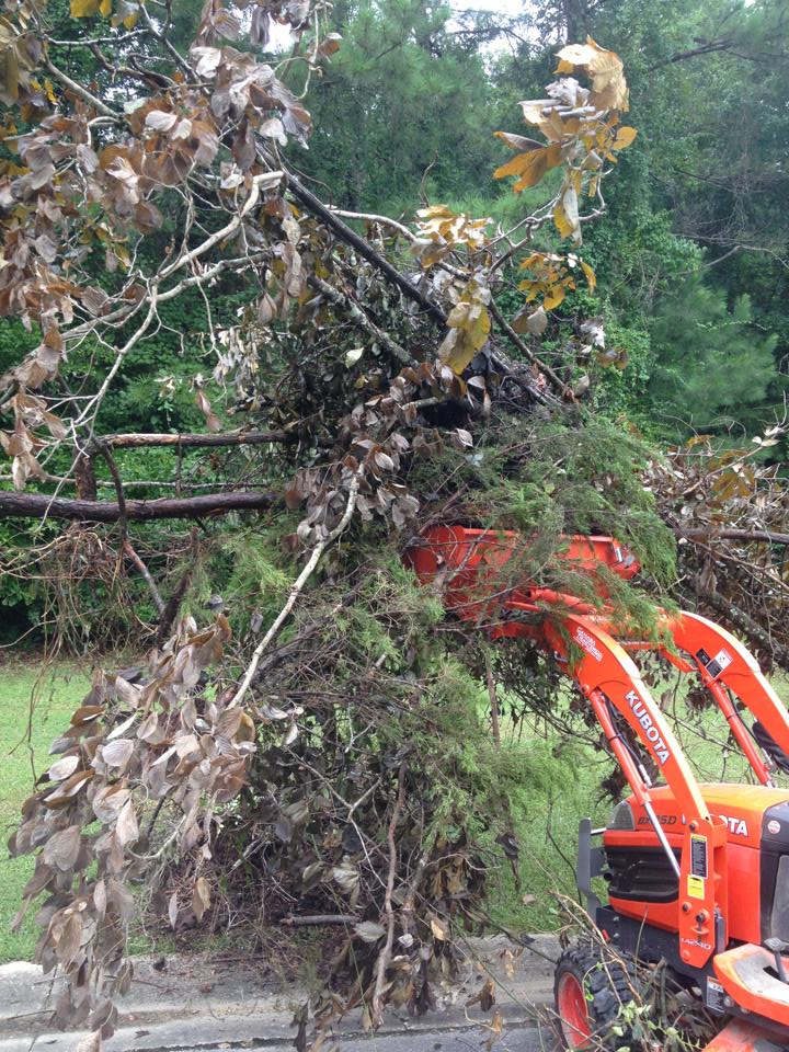

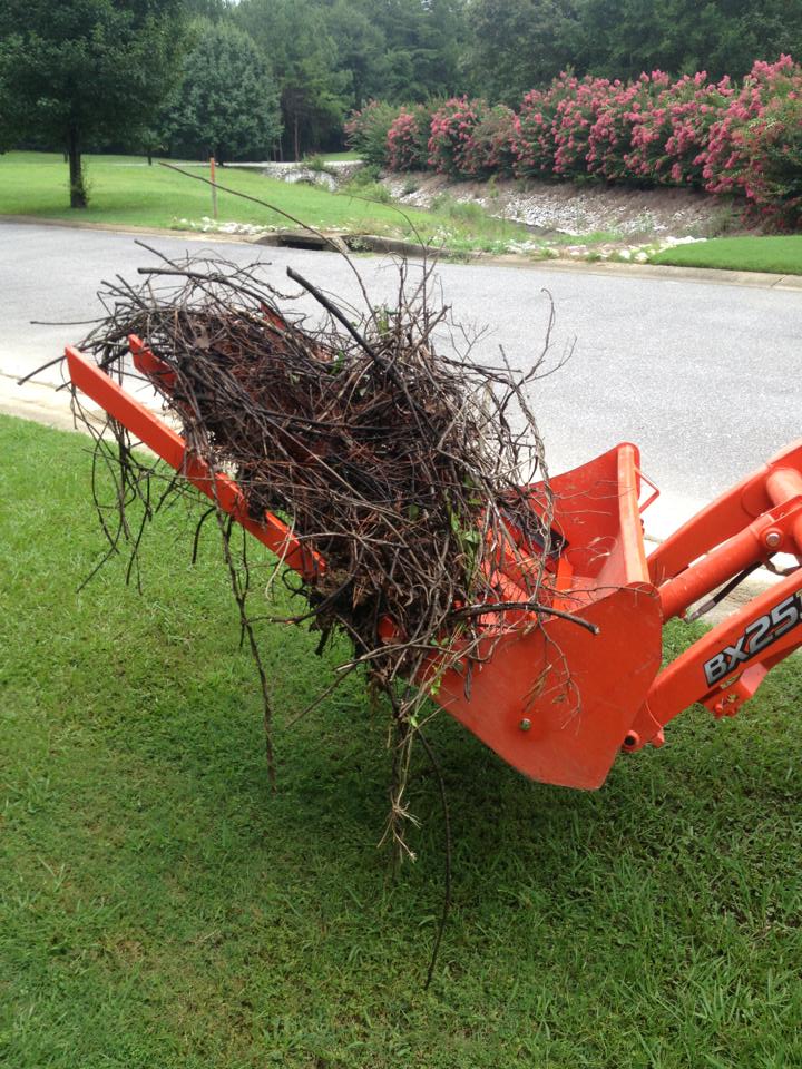

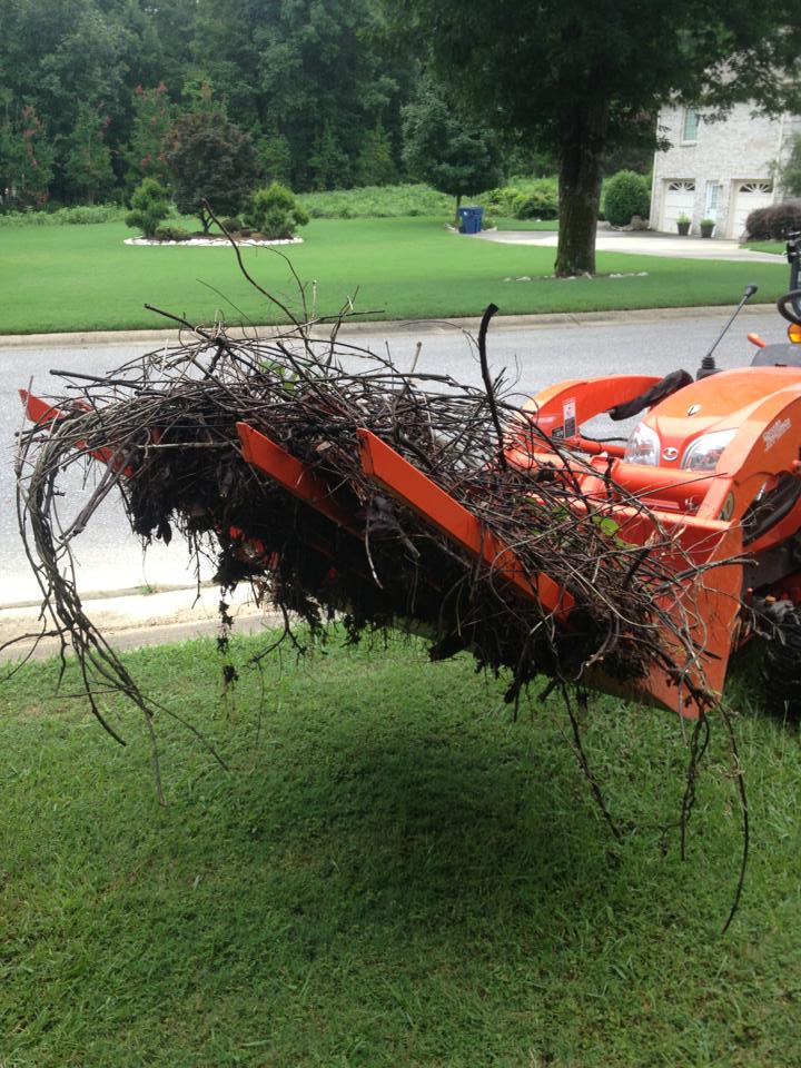

Finally got to thy them out today. They work absolutely awesome. I had a huge pile of brush including 3-4 20ft long trees and a pine stump that was 12" around and about 5 ft long. It picked up the hole pile in two trips! It is unbelievably strong! I even picked up a huge rock that was about 20" around and bounced it up and down on the tips of the times and it took it just fine! Anyway, I snapped a few shots for you guys to check out:
