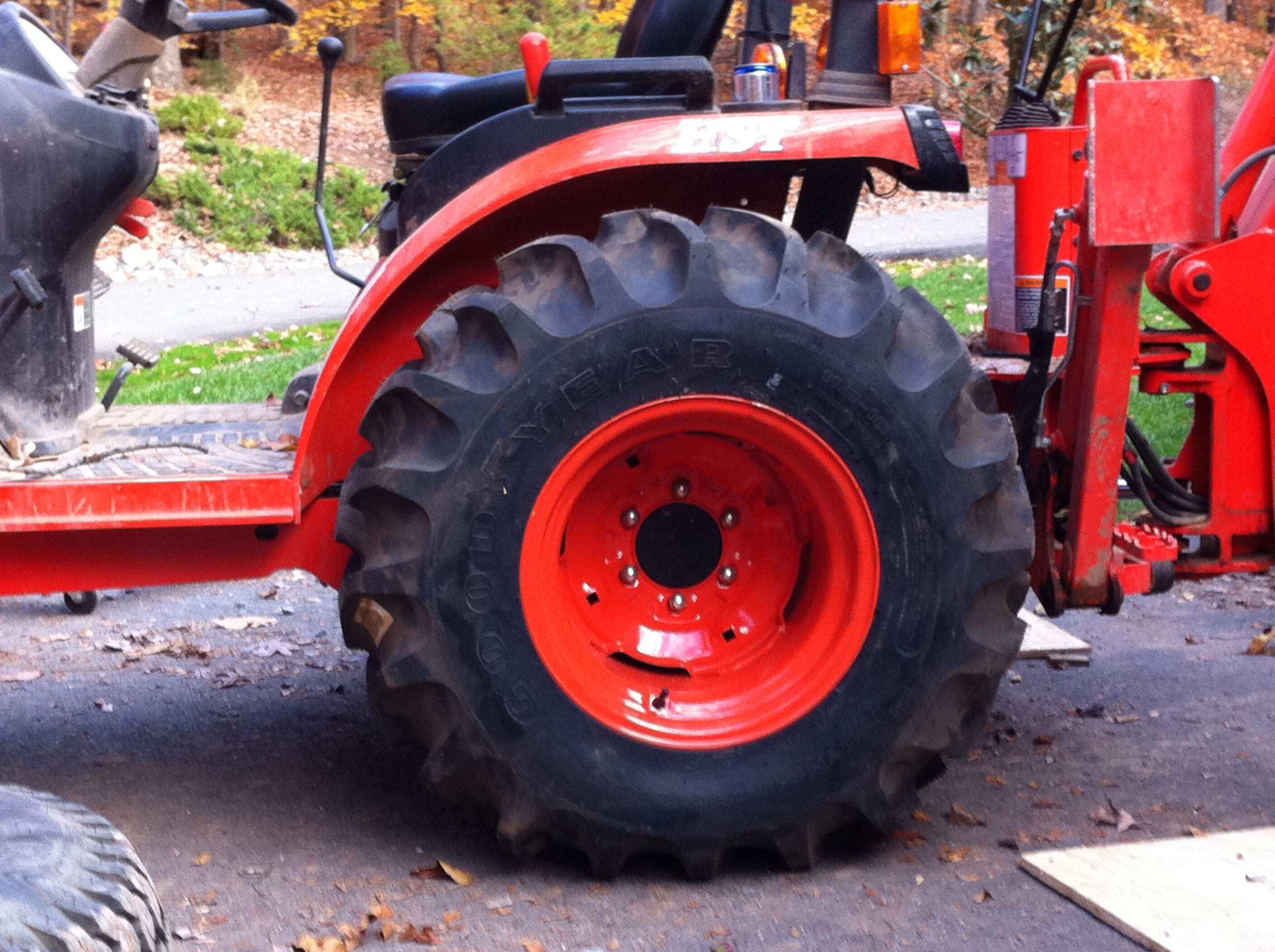

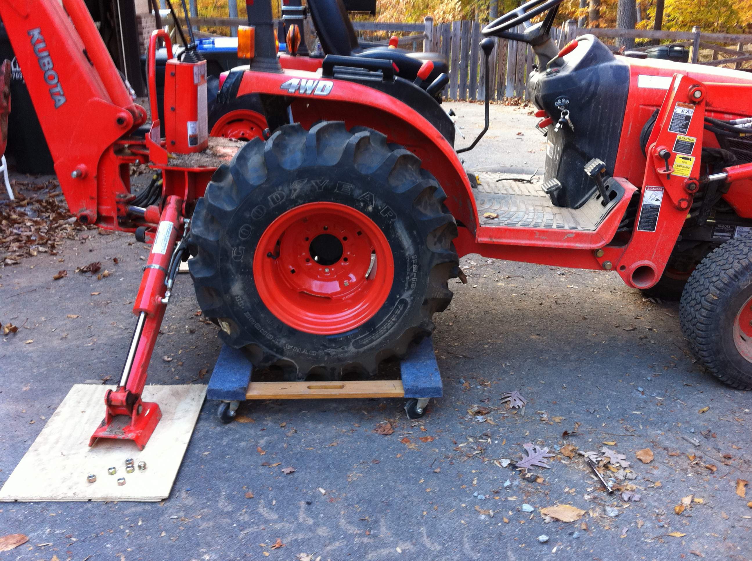

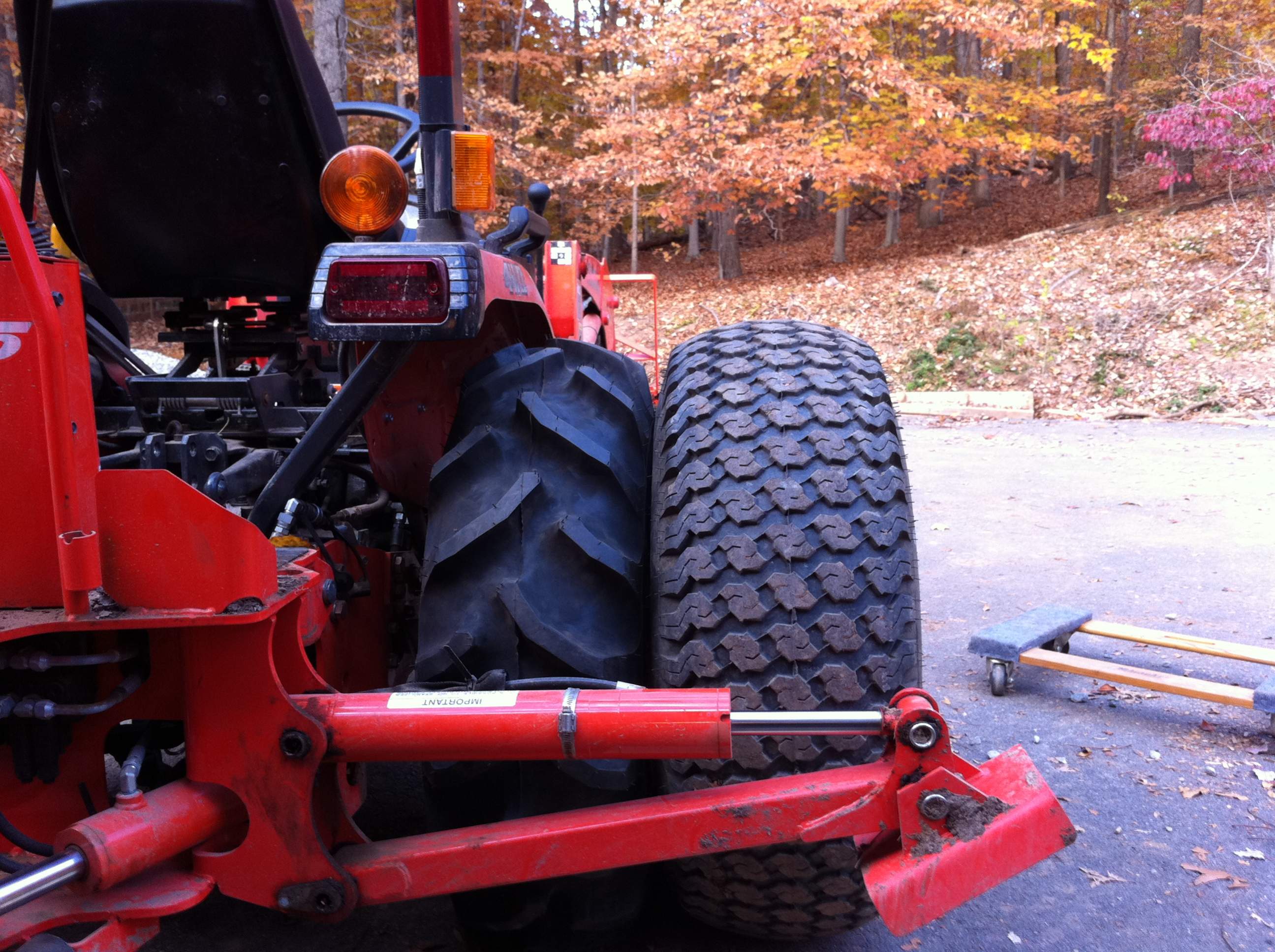

I have been dreading this because of the weight of the loaded read tires. I tried using dollies but it was actually easier just to lean the tire onto the hub and use the backhoe to move the tractor up a little. It only took about 30 minutes. It makes a big difference in the way the tractor looks. I think some people buy the R4s because of how good they look versus the turfs. I know turfs are not supposed to be great for loader work - are ags better or worse? I am really hoping these will be great in the snow.

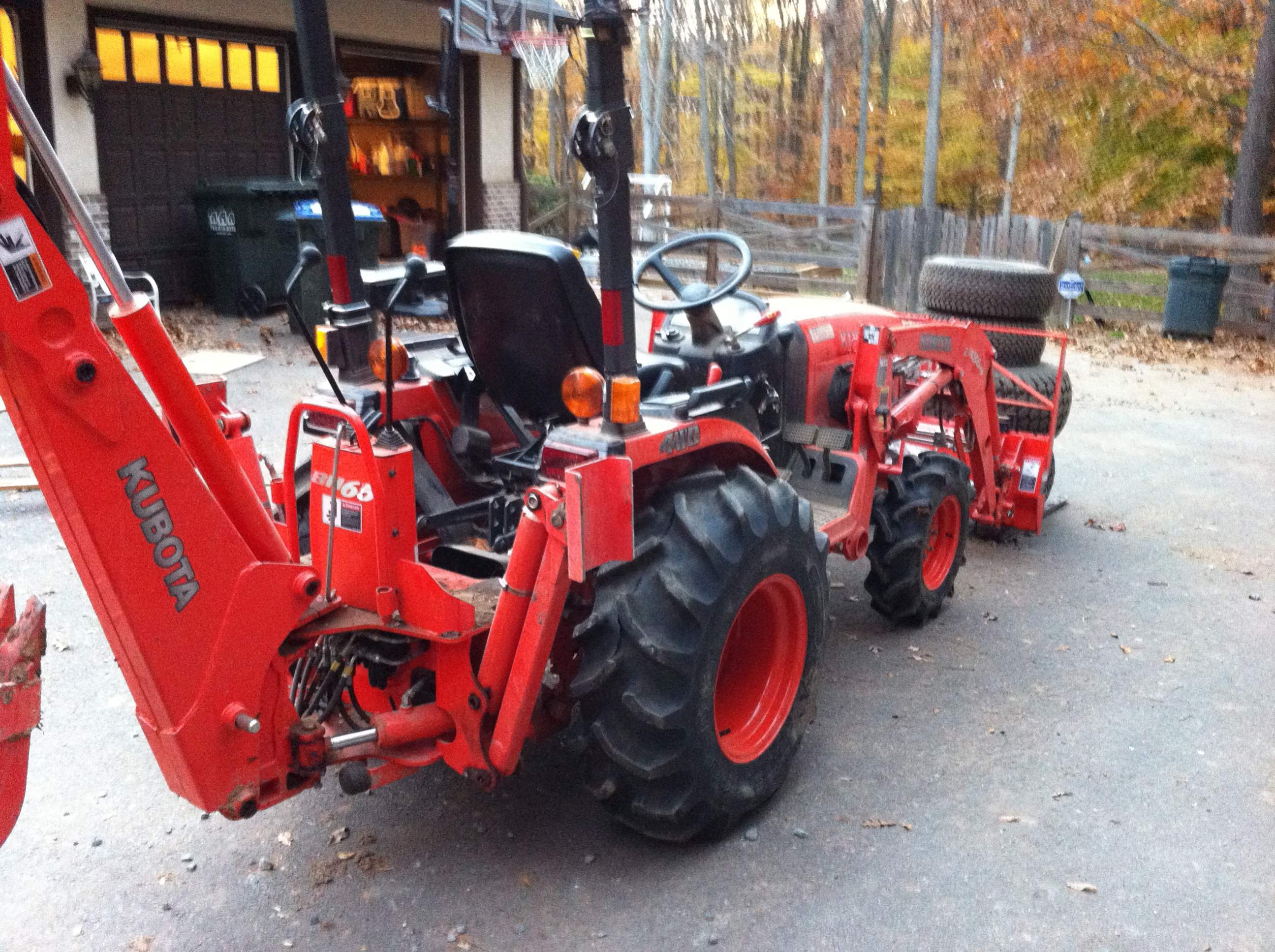

BTW I was so relieved when I finished the rears I opened a beer and popped the fronts on without paying attention.i was feeling pretty good about swapping the rears because of how heavy they are. When I uploaded a pic I took of how good it looked I noticed that I put the fronts on the wrong side!
also - I don't know anything about loaded tires. I assume you don't or cant check the air pressure? If it ever gets low?

You did swap the fronts around right? :laughing:
