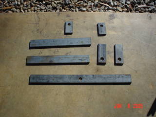

I started with a 6 foot piece of 3/8 flat bar 2 inches wide and cut the pieces out and drill the holes. check the attachment.

What did you use to cut and drill the bar stock with? I'm asking because I am using some old roll around bedframe rails on a project, and while my portaband cuts it like butter, I totally ruined 1/4" titanium bit trying to drill this stuff on my drill press. Does flat still drill a lot easier?

I used an electric ban saw for cutting and the drilling was fine until I got up to the 7/8 holes, they were tough going on a small drill press with a cheap bit. Those old bed frames angles can be tough to drill through. My steel was free, got a friend that works for a steel company and he seems to always owe me a favor. The hitch really turned out better than the pics show. I will paint it today when it warms up. May post a final pic when its finished.
