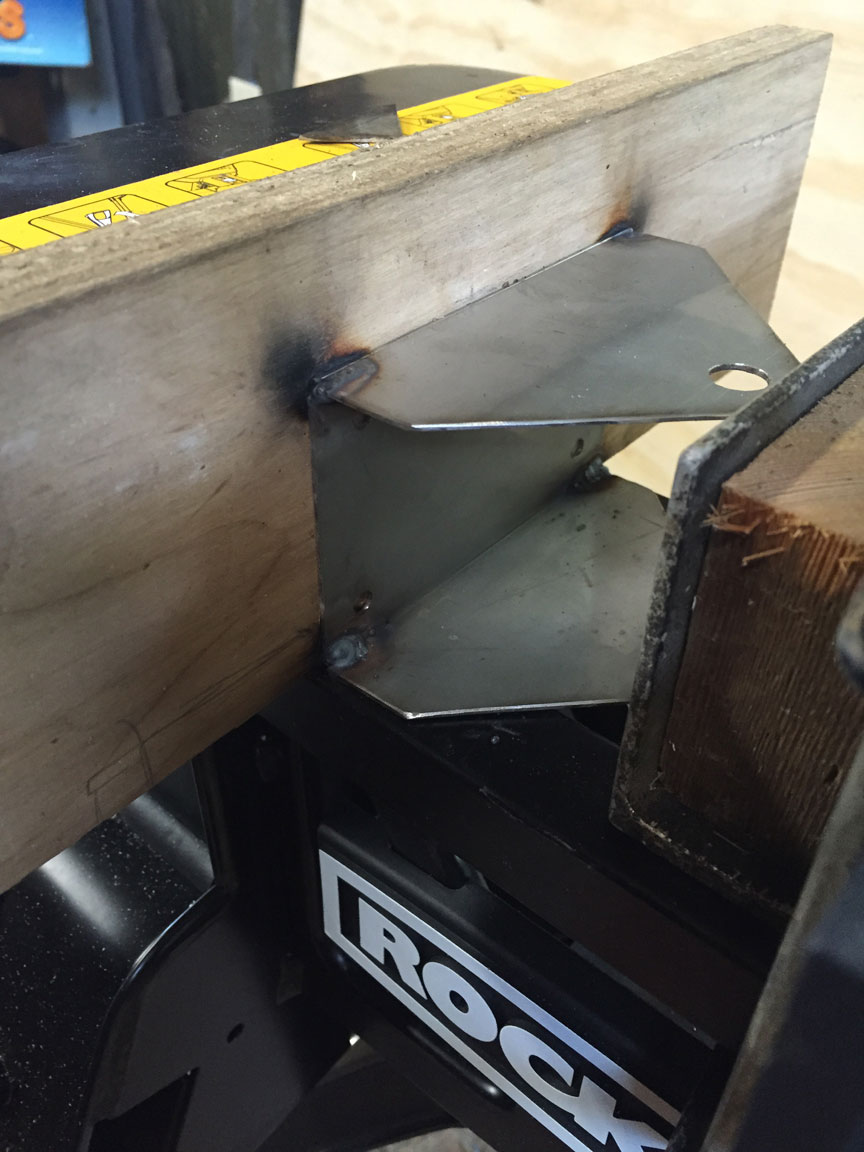

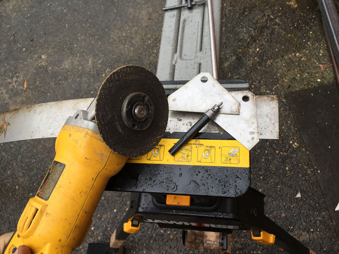

18 ga stainless steel and 3/8" stainless tubing. Cut parts with an angle grinder and Harbor Freight cutoff disc. Drilled the holes with a heavily oiled rota-broach.
Was happy to be able to use my new Jawhorse to clamp the parts together.

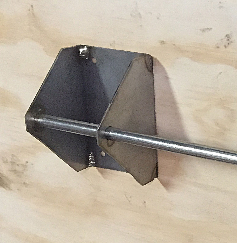

Welded 1/2" fillets in the 4 corners. Used a Miller MultiMatic 200, .030 wire, and on 18ga setting. I pulsed the trigger, as it was a little too hot. And I thin .024 wire would have been better for 18ga. I did not use Stainless wire, just the normal steel. I didn't have the "welding attachment" yet (with the Aluminum jaws) so had to use wood to protect the soft jaw pads.

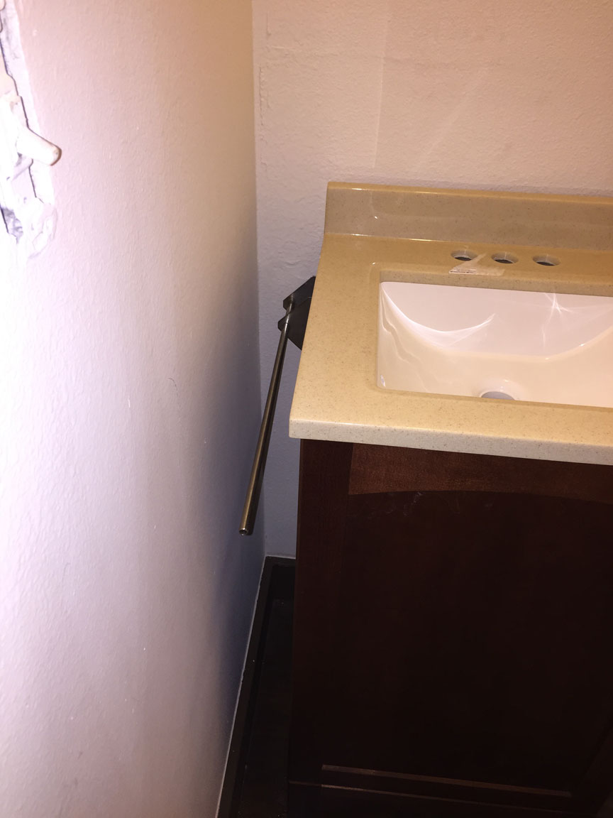

It attaches to the side of the cabinet like this.
Installed.

With the design and fabrication completely by you Im sorry but I see a really big lawsuit coming your way when those welds fail!

This is prolly a dumb question, but you just used standard flux core wire to weld stainless? I didn't know you could do that, but then again, I could write several books about what I don't know!

Not flux core, used solid core wire with 25/75 AR-CO2 gas.
It's indoors, in a half-bath with no shower. I suppose I will find out if it rusts. The only thing I'm certain of is it's strong! And I had a good excuse to weld something up. :D

May need to put a clear finish on it to keep it from rusting.
