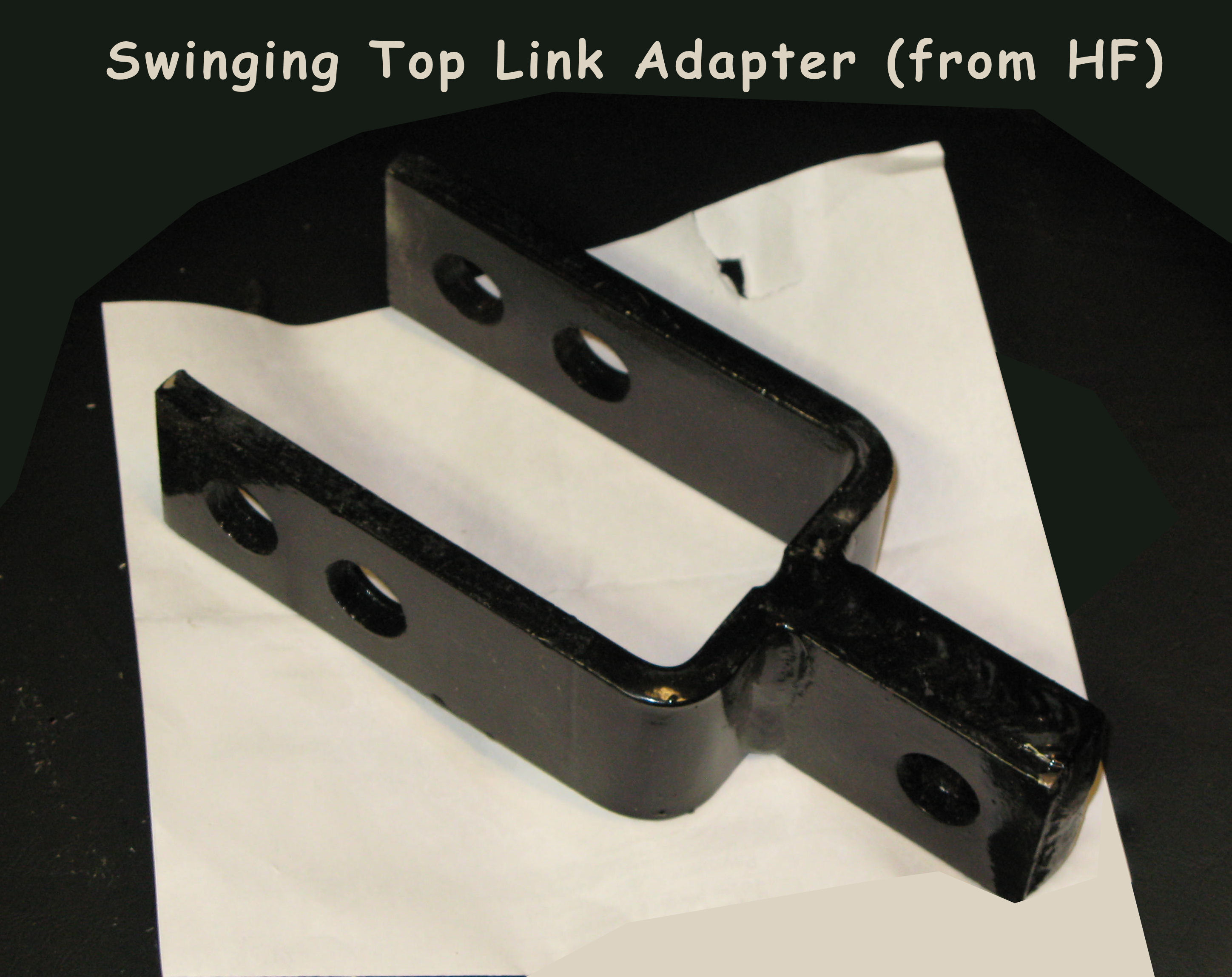

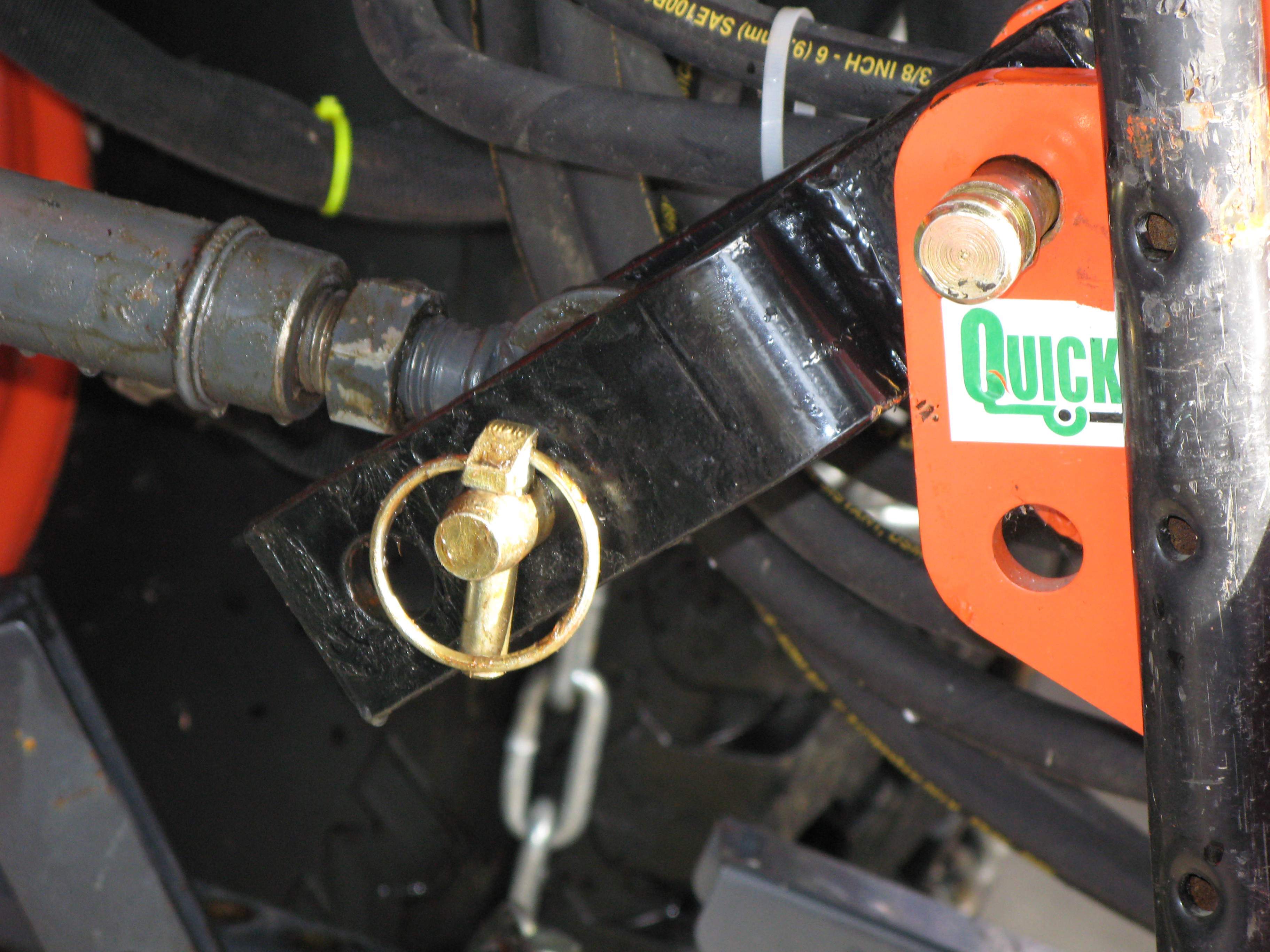

not sure if this would have helped but, when necessary, I lengthen my hydraulic top link at the other end with the HF "swinging toplink" ...as shown

   / Made a hydraulic top link extension #10
Do you have to move the top link in or out to get full travel of the 3pt.?
The top link pivot should be in line with the lower link pivot.
